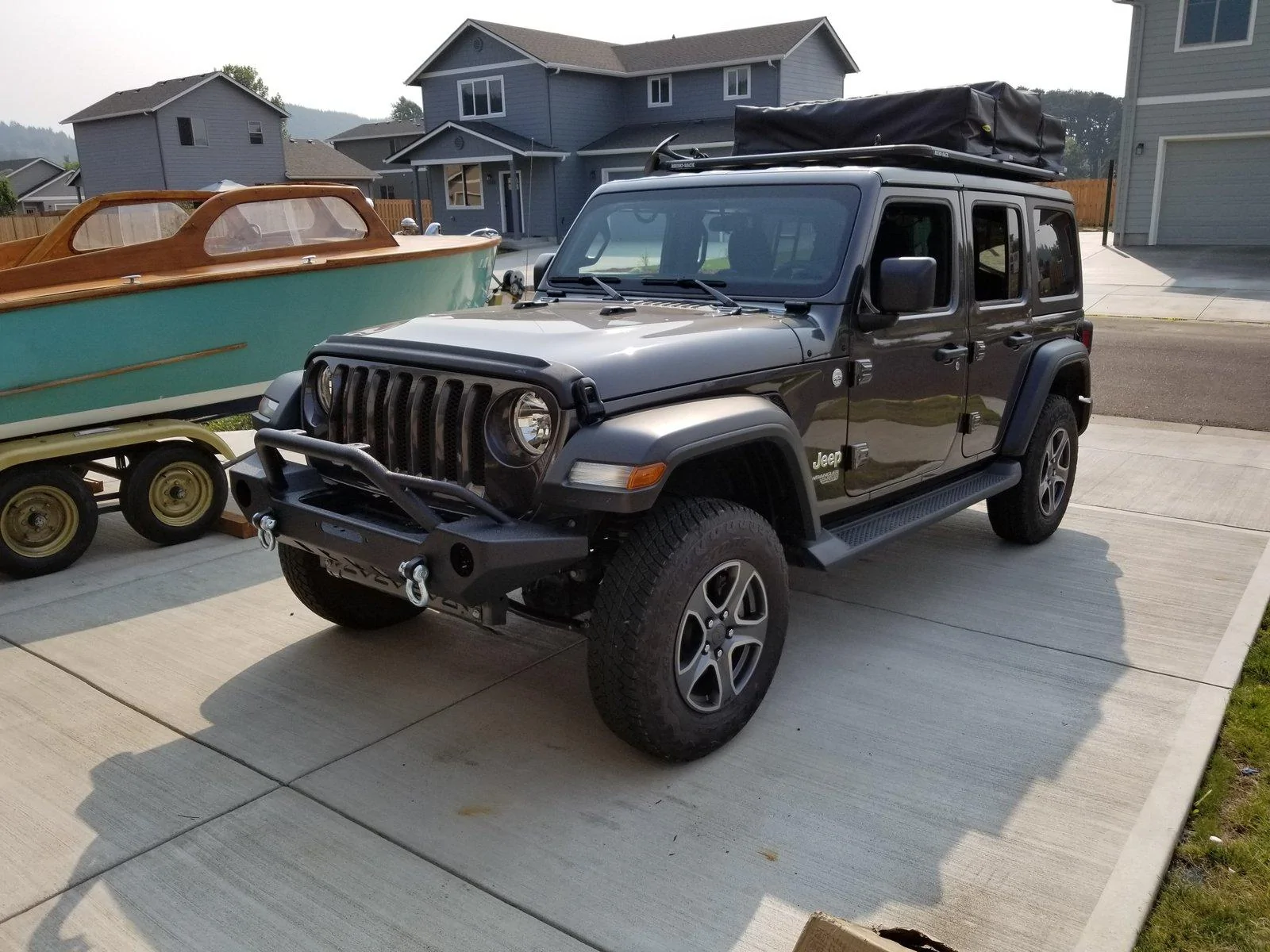

I have the halogen fog lights and they don't fit at all. They have a 3 screw mounting pattern, and the Barricade has a 4 screw mounting pattern. I can almost get 1 screw to line up and have the fog light centered, but it isn't solid. The light will bounce with barely a tap. Probably going to get cheapo Amazon lights for a JK since they have the right bolt pattern.

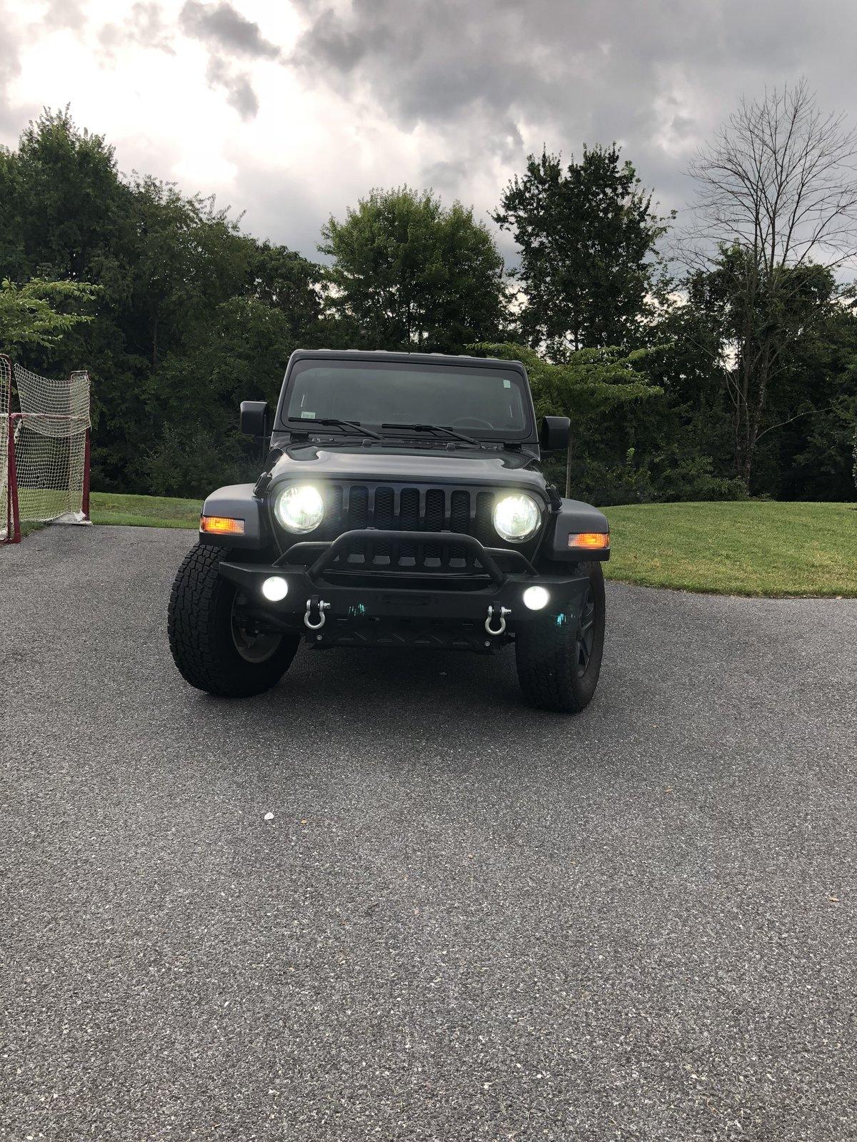

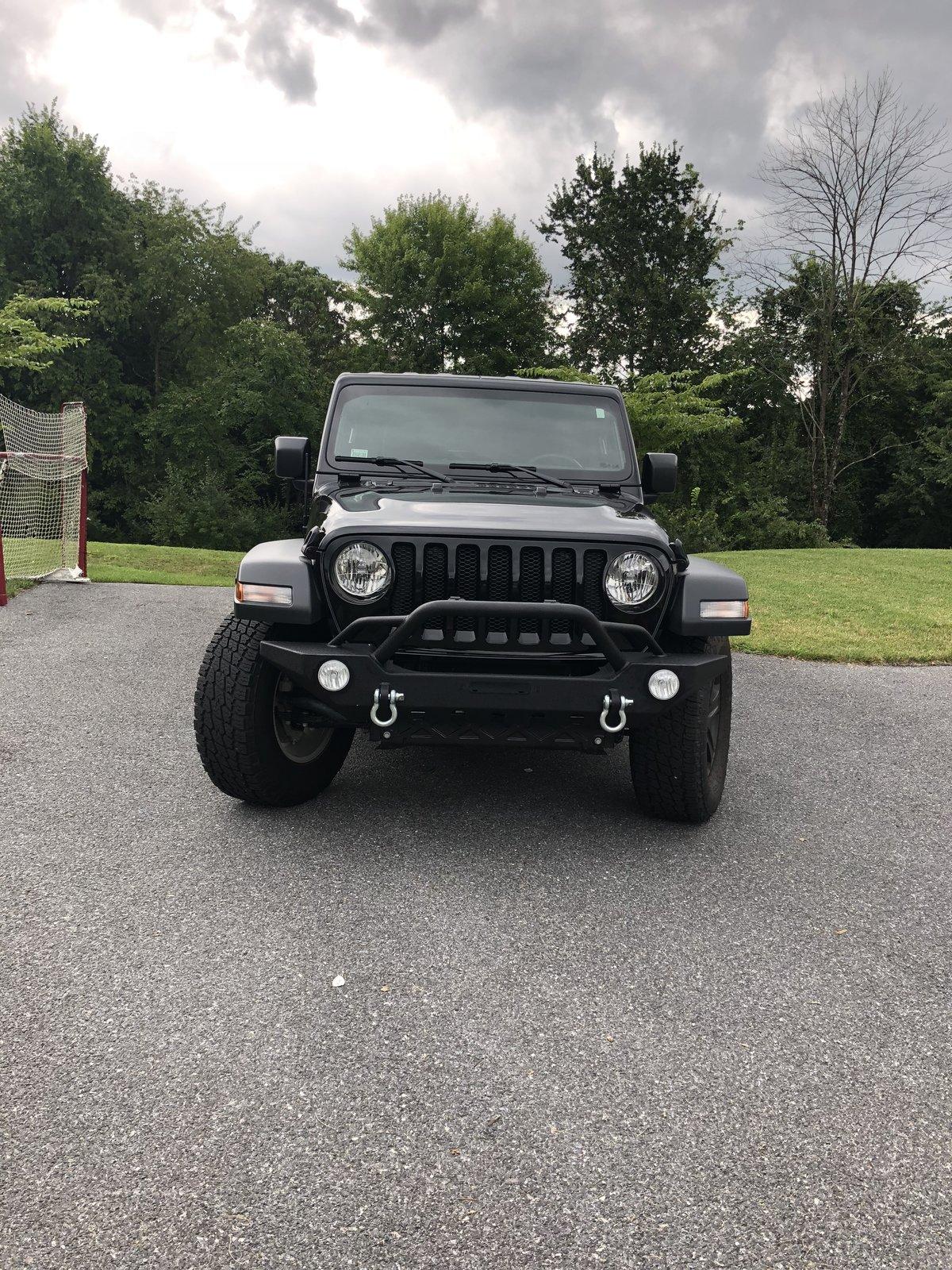

Just installed mine also- pics soon. My husband and our friend messed with the lights and came up with a way to keep the fog lights in. Hopefully it stays lol! I really love the way this bumper looks!

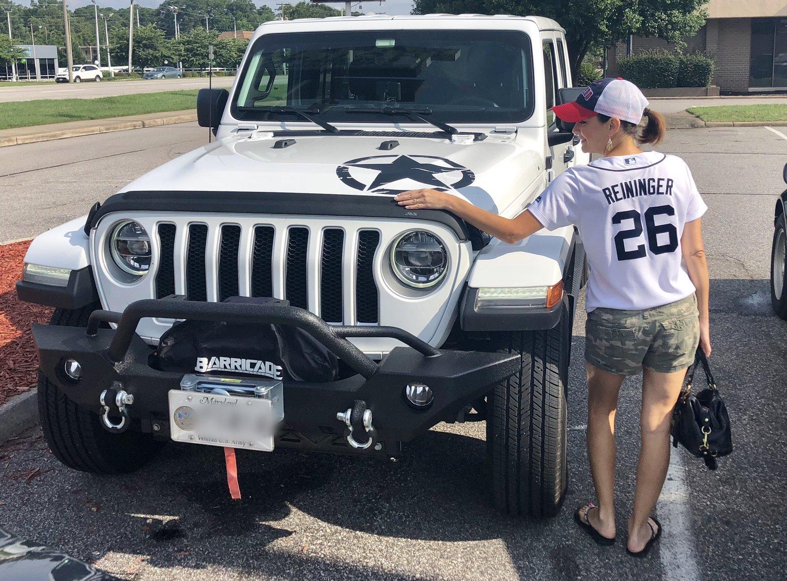

Anyone know to get your license plate mounted on it?!

Install for us was pretty smooth also. We had to seal in the fog lights because mine didn't work right, but they are fine now! We didn't have to do any filing at all which was good. I was impressed and remain impressed with the look of this bumper!! Hope you're enjoying yours!

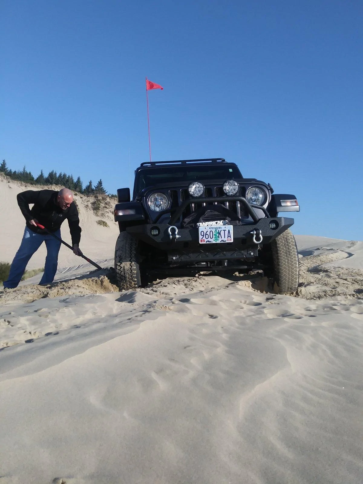

I finally had a chance to use the bumper/winch combo :cwl:. I've been all over with it and finally got stuck in the dunes at Florence Oregon. Everything worked flawlessly. I went with the Barricade 9,500lb winch with synthetic rope. It worked hard, but never got hot or skipped a beat getting me free.

Glad it all worked. Same setup here.
