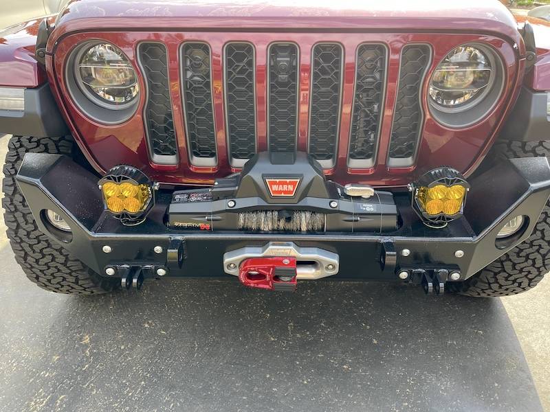

I just mounted a pair of LP4s on my front bumper. I want to wire to the AUX switch but also want to have the backlighting to come on with my headlights.
I already hooked up a pair of Squadron Pros to the cowlings. That is straight forward. I am assuming I need to run a 'third' wire and tap into a headlight wire harness? Is it that easy? Which wire?

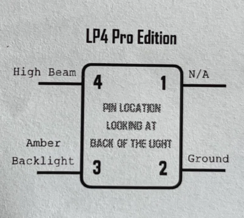

Bump... here is the wiring diagram for the 4 pin plug. There 2 wires present (a black and white). I think I need to run a wire from pin location 3 to a headlight harness wire... sound right?

It would seem like pin 3 is your ticket. I presume all the volts/amps match up?
Yep... now I just need to find the right wire on the headlight harness. Need to find and study that wiring diagram.
I have not done any volt/amp testing yet but will do.
Philly_
Nov 20, 2021
1,124
1,868
Dallas / Detroit / NYC
2022 JL Rubicon
Are you wiring to the actual headlight or DRL/halos? If going for the halo wire, you may be able to find what you're looking for in a thread where someone swapped in factory LED headlights, or you could tap into the fender DRLs.
