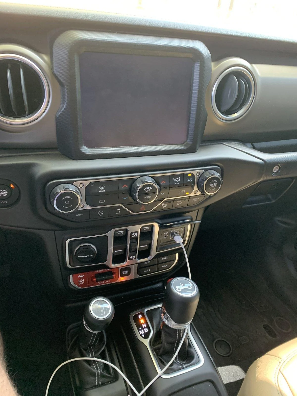

Another day, another issue with my JLU. This time my backup camera doesn’t work at all. I have turned my car off and on multiple times and still no luck. I figured this would be like when the back up lines disappear, they tend to go away and come back whenever they feel like it.
Anyone else have either of these issues?
my biggest fear is that my vehicle is approaching the end of its warranty and my vehicle is still plagued by issues.

I just had this happened to me yesterday. Turned out some harder slam of the back door caused it. I opened the back trunk door and slammed it again, and camera started working. Guess some wire contact or something.

What year is your rig? Mines June 2018 and I'm dealing with my stereo skipping when it gets cold out (sub 30F). During those events the lines on the backup camera cut out. Tons of threads here for similar issues and all indications are that the camera or the wiring is at fault. You are in houston? I doubt it gets cold enough there for the audio cut outs but it doesn't mean you aren't suffering from the same camera issue numerous 2018 builds seem to have.

All is it is the plug for the backup camera. Pop the cover off of the tailgate, and undo the grey wire connector. (Optional, add solvent or blow out with air). Plug it back in and everything should be good to go. That grey plug connection apparently doesn't work well in that environment. Please post back and let us know if that worked for you.
There was alot of chatter about having to replace the radio, replace the camera, etc, etc, etc. and I'm fairly confident that it's simply a poor connection.
