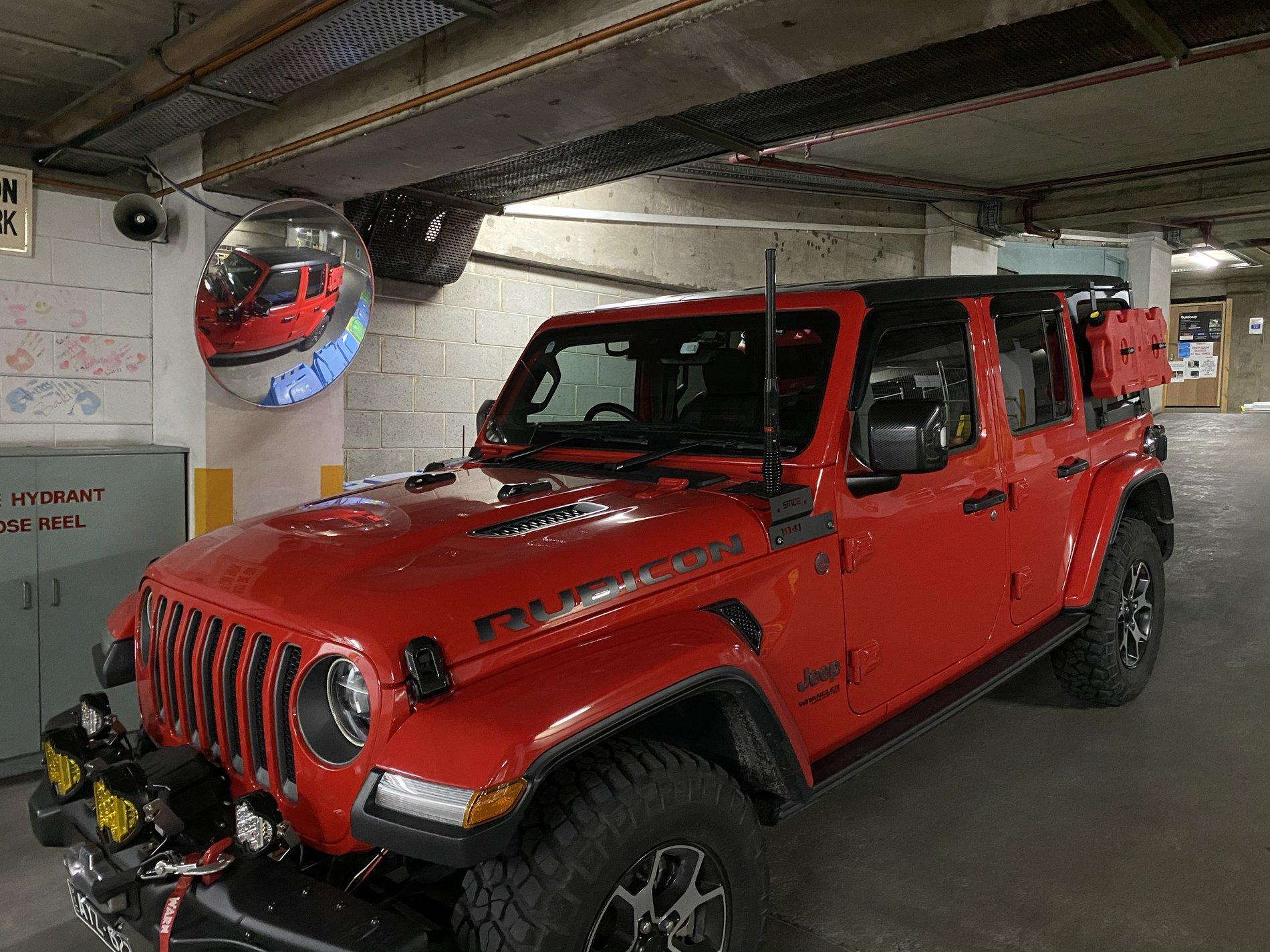

I got my UHF antenna mounted on the left side Crawl mount. Still debating on should I get a roof rack or not.
Dis you had to drill through the hardtop for the rhino rack?

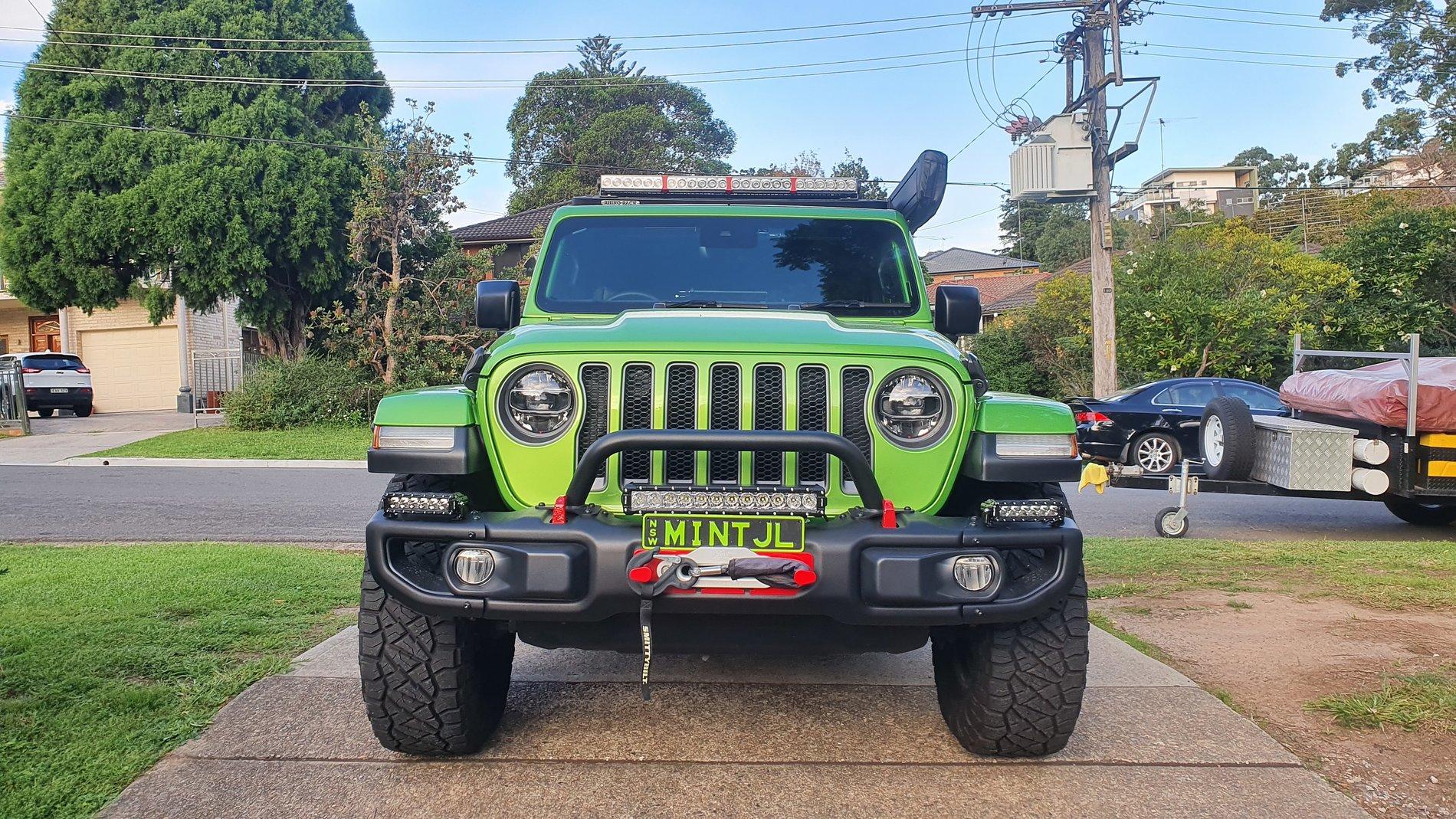

Nice light setup. I installed a warn low grille tube bar but thinking I'm gonna have to remove it to fit something 7" or so.
I loving having the roof rack, i think it fits the jeep perfectly compared to any other car on the market.
But yes you have to drill through the roof, im not sure how easy/hard this process is as Rhino rack did this for me (As they used my jeep for some of their official pictures) though from what i hear its pretty straight forward. I mean the holes ive drilled in my roof for cables are way larger anyway =)

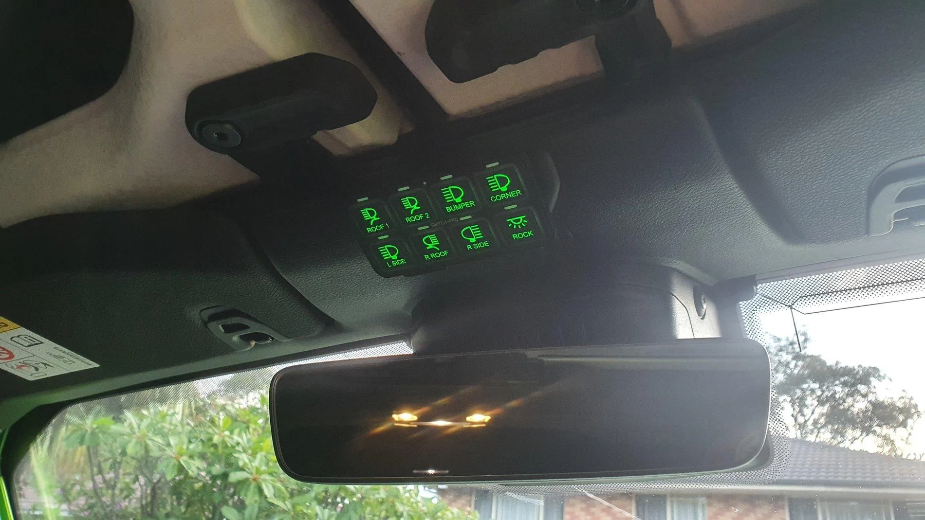

I use Aux 4 to permanently power the dash cam, I have it on a button for when i want to turn it off for whatever reason.
Then i use the constant 12v wire fromt he aux kit to power my cb radio (GME XRS370)
Then i use the SwitchPros 9100 to controll all my external lights which does a much better job with controlling lights plus keeps it legal in Australia to use with Highbeams and all. (I have set the top 4 buttons to all turn on with the high beams which is all the front facing lights)
Plus some other cool features of the 9100, bluetooth connection to control lights via your phone,you can dim all the lights by holding the buttons, set lights to flash and strobe if you want, etc... Its great... Much better than the factory aux switches in my opinion.
