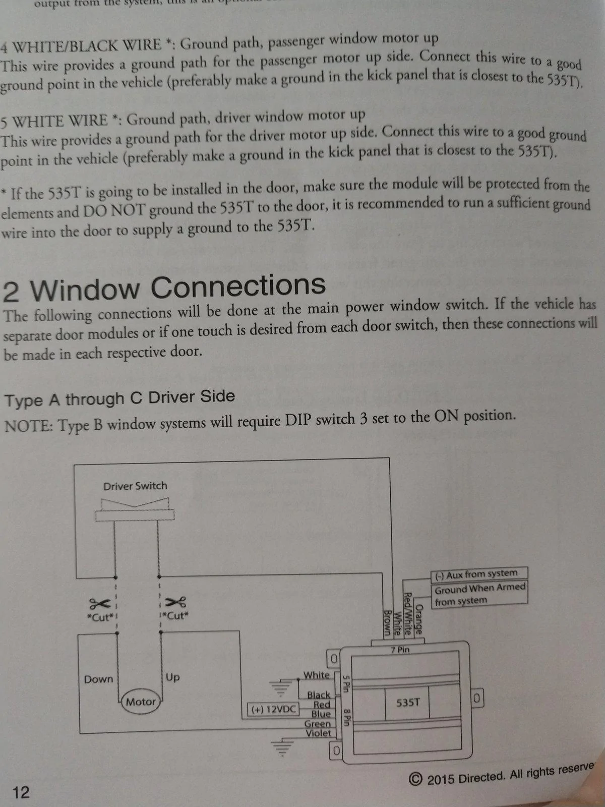

@Rhinebeck01 whats up with tazer adding this!?
On the Wrangler JL, the windows are not connected via the CANBUS that Tazer uses to work its magic. Separate and different hardware and software are needed to control the windows.

Great mod, but those of you with with small children and pets please be extra careful as the window rises with considerable speed and force.
We plan on introducing a plug-and-play version later this year with automatic safety anti-pinch technology, auto up, global (all windows at once) and remote features.
I believe these units have a anti-pinch feature... But good call out.

Would be nice to have a list if wires to splice from Jl to the box
