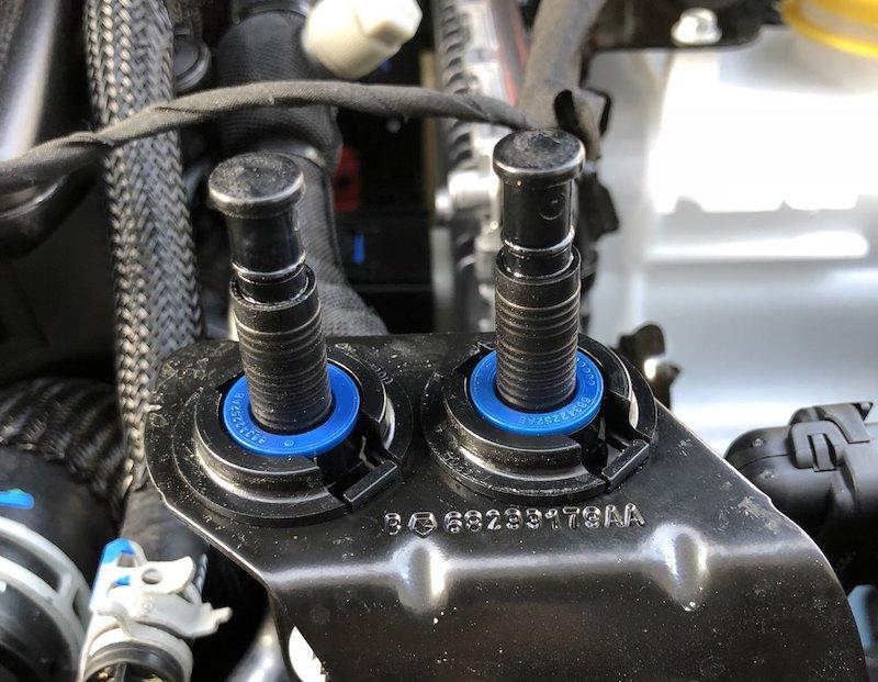

Today I unplugged hood open sensor #2 on right side (driver's side) of engine bay. According to the wiring and software schematics its only job is auto stop/start disable with hood open. It gave me the the auto start/stop warning dash symbol, but that start/stop feature was driving me crazy. I drove the JL 68 miles today with zero issues (remote start works as well as backup camera).
Yes I am too forgetful to press the ESS button to off at every startup. This will hold me over until I can figure out a better defeat technique for this very undesired feature.
Photo of the sensor:
