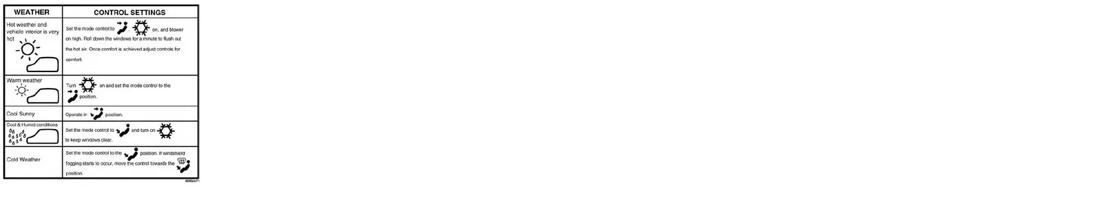

Read the manual. The vents that face you are not designed to be utilized in cold weather. If you try to utilize the system in a way that it wasn't designed.. your experience may vary :)
