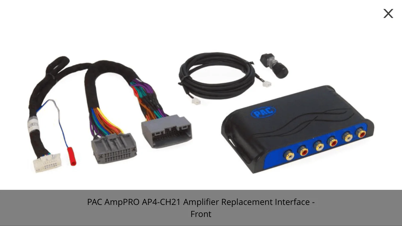

The wiring harness that they also use for JK's isn't updated for JL's yet (AmpPRO 4) - were you able to use the AP4-CH21 on your upgrade or do you have a different model number you can share?

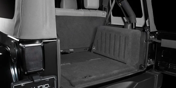

Why did you place the amps in the cargo tub instead of under one of the front seats?
I'm with you - no change to the head unit, extra lights, etc....just need some base and better range and power through all the speakers!
Yes, I used the AP4-CH21.
The new 10” sub fit perfectly in the existing alpine box so I just left it there. Under the seats have rear air vents, I think. Good luck with your install!
