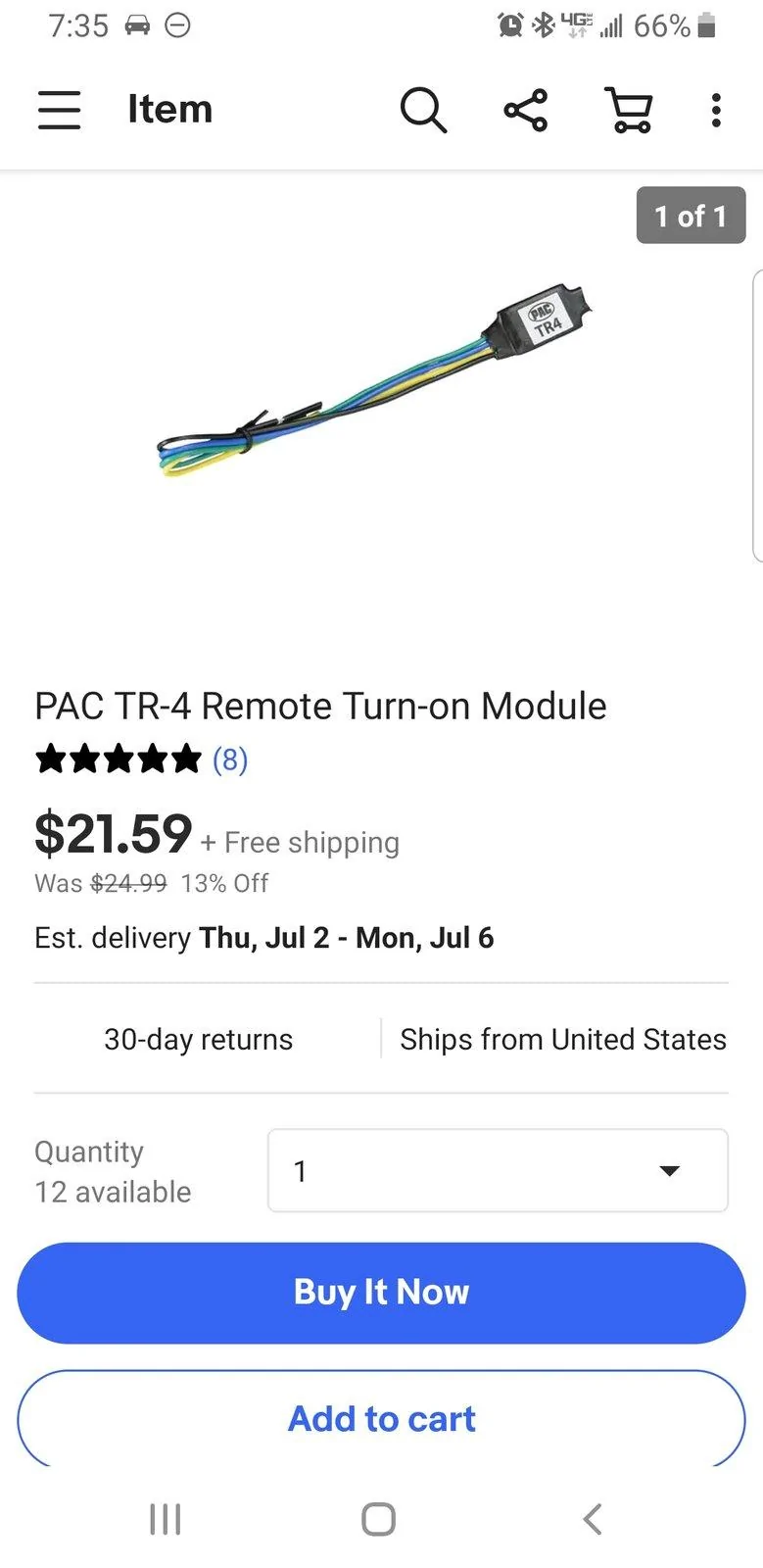

This would solve your problem if your amp doesn't have a signal sense ability. It would turn on the amp when it sees speaker output from radio. If they would have used a better loc, it would be built in
