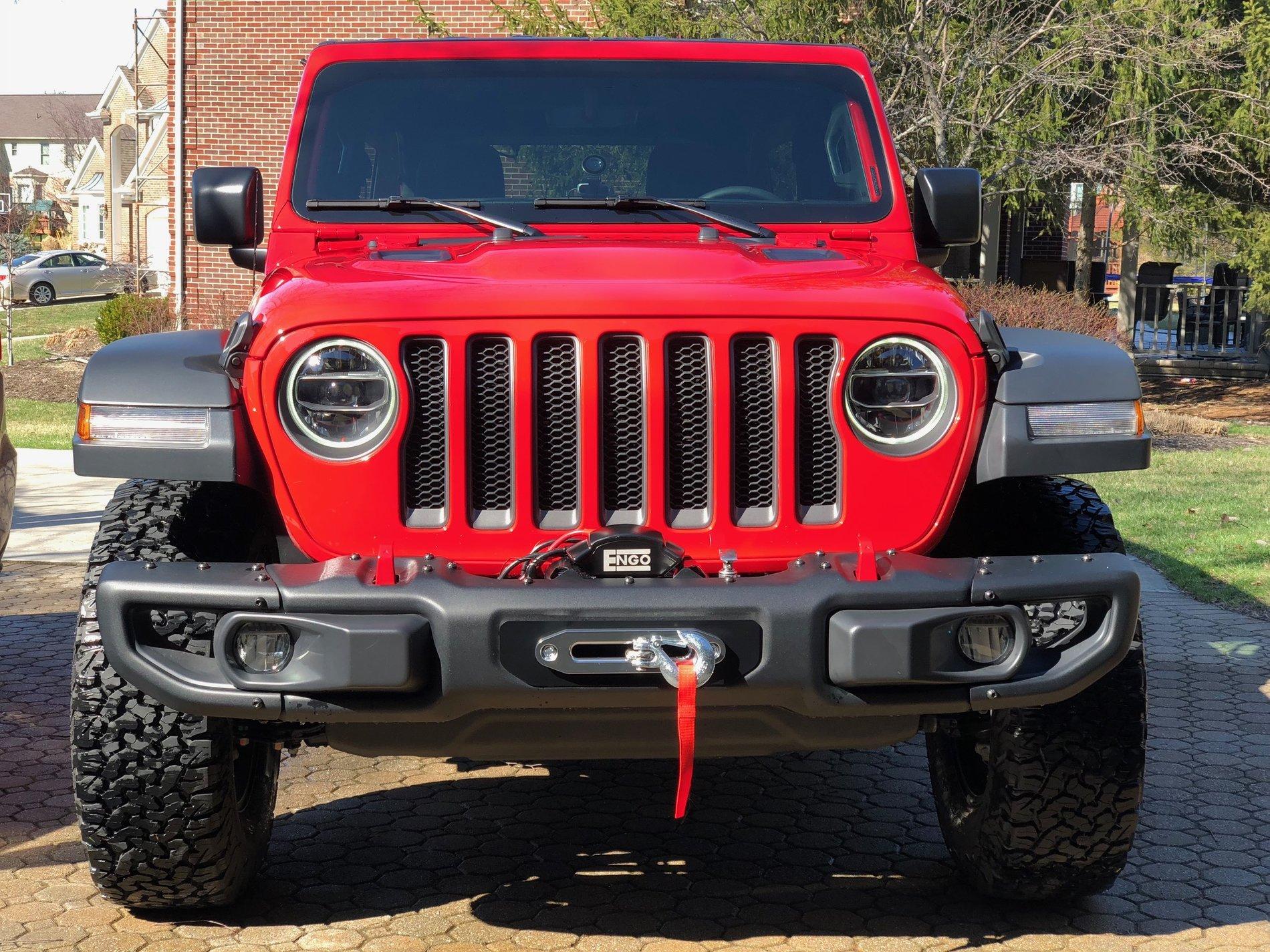

Rustys off road is the only company I have found so far with in stock Winch plates for JL steel bumpers. I do not however see a pic of what the kit comes with $229. i dont know if it comes with the canister relocation bracket or not. JCR will have their kits available in a week or 2 $229 and it does come with relocation bracket.
The issue I am seeing is that There is limited winches that will fit and non of which are smitty built.
Here are the winches that we know do fit as of right now PER RUSTY'S OFFROAD:
We do not know that ALL winches will fit but we do know that the following WILL fit:
With this said we highly recommend you compare these measurements:
- Warn VR series
- Warn M8 series
- Warn 9.ORc
- Warn XDi
- Warn XD
- Superwinch Tiger Shark
- Superwinch LP series
- Ramsey REP series
- Ramsey Patriot series
- Winch Dimensions: 21.8" L. x 6.3" D. x 7.6" H.
- (555mm L. x 160mm D. x 193mm H.)
