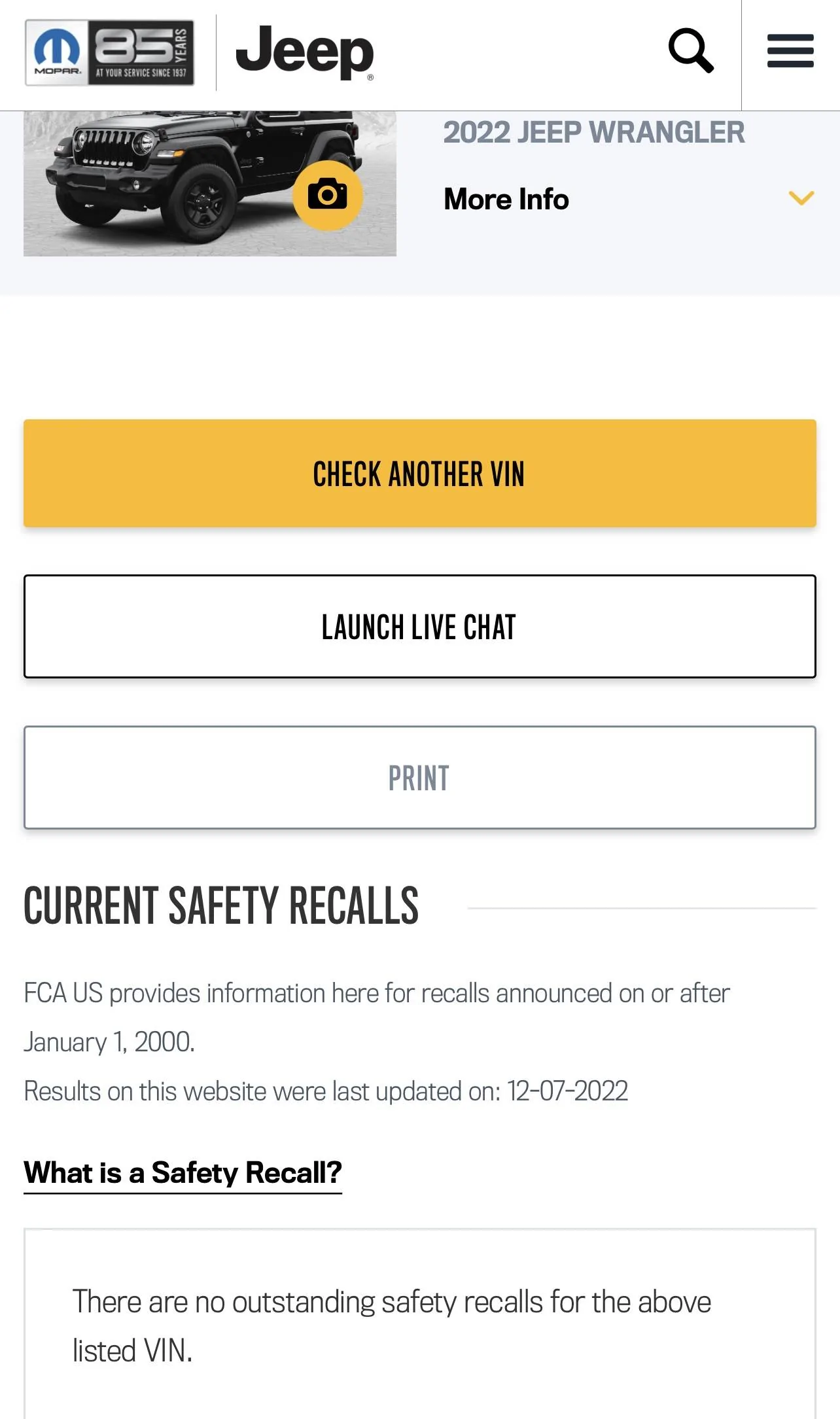

I called the dealer because I noticed my right rear shock was leaking and wanted it replaced. The service writer said my vehicle has a recall ZD8 for it (it's actually campaign # ZD8). I mentioned to her about the tsb which must have been escalated to campaign # ZD8. She seemed adamant that the recall/campaign be performed and I agreed. My appointment is on 12/14/22 so we'll see.
Go to Jeep.com and look up RECALLS enter your vin and in my case there isn't a active recall but instead I have a active Campaign ZD8 that shows up for Model Years 2021 - 2022.
Jeep Wrangler JL As of Nov 29th the 2.0L has recall ZD8 for the coolant inlet fasteners. 1670425436467
