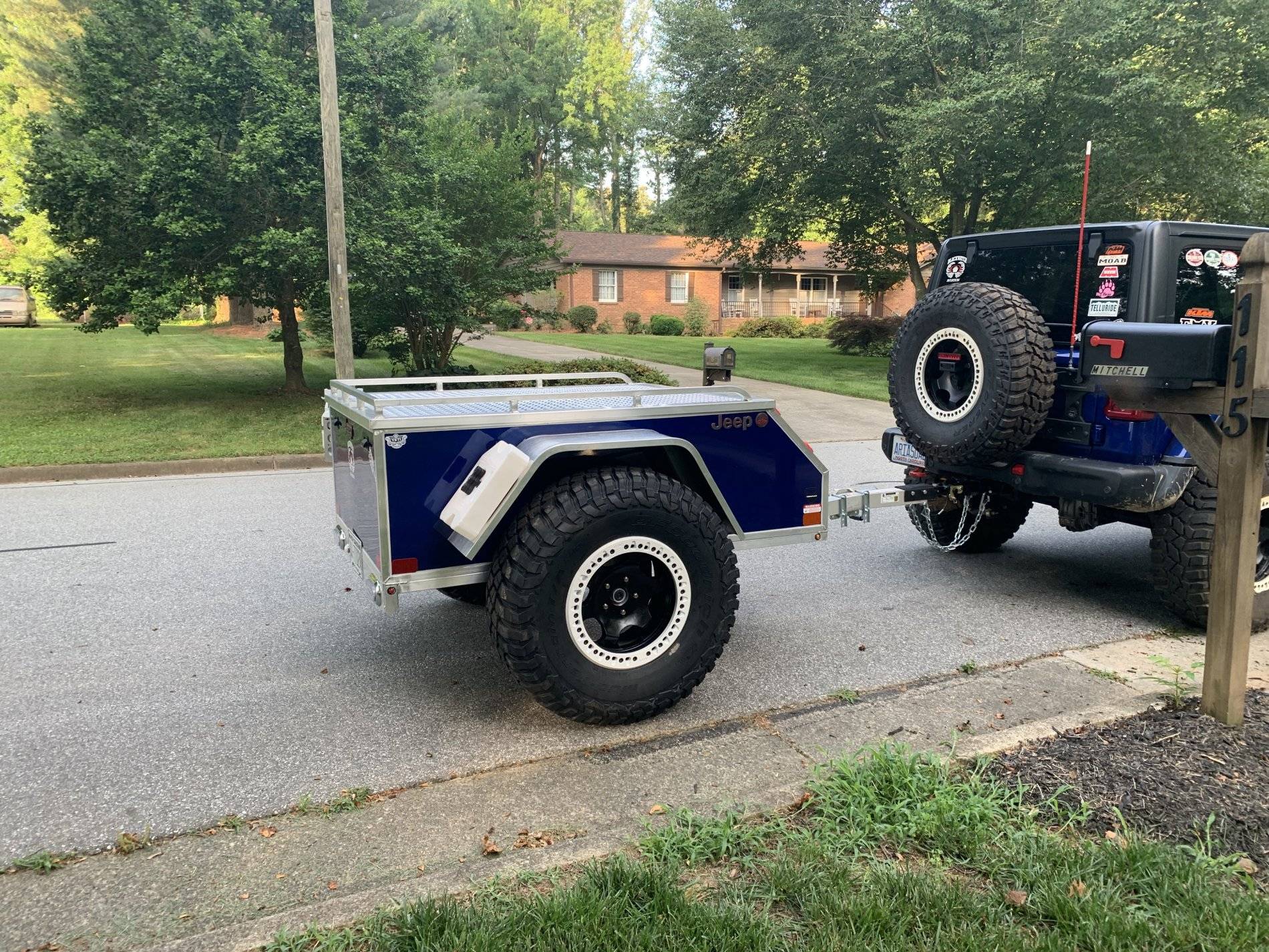

I use the same one ChevyMitchell uses. Can't remember what it's called though. I bought it in 2008 for my Land Rover trailer, and now use it for the Jeep.

I just went out to the garage and checked mine. It's a lock-n-roll brand too. Honestly, it couldn't be simpler to hitch it up. I've been super pleased with mine in the 12-ish years I've owned it, and another advantage over a conventional hitch ball is that it's much quieter.
