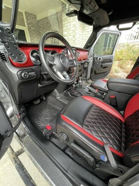

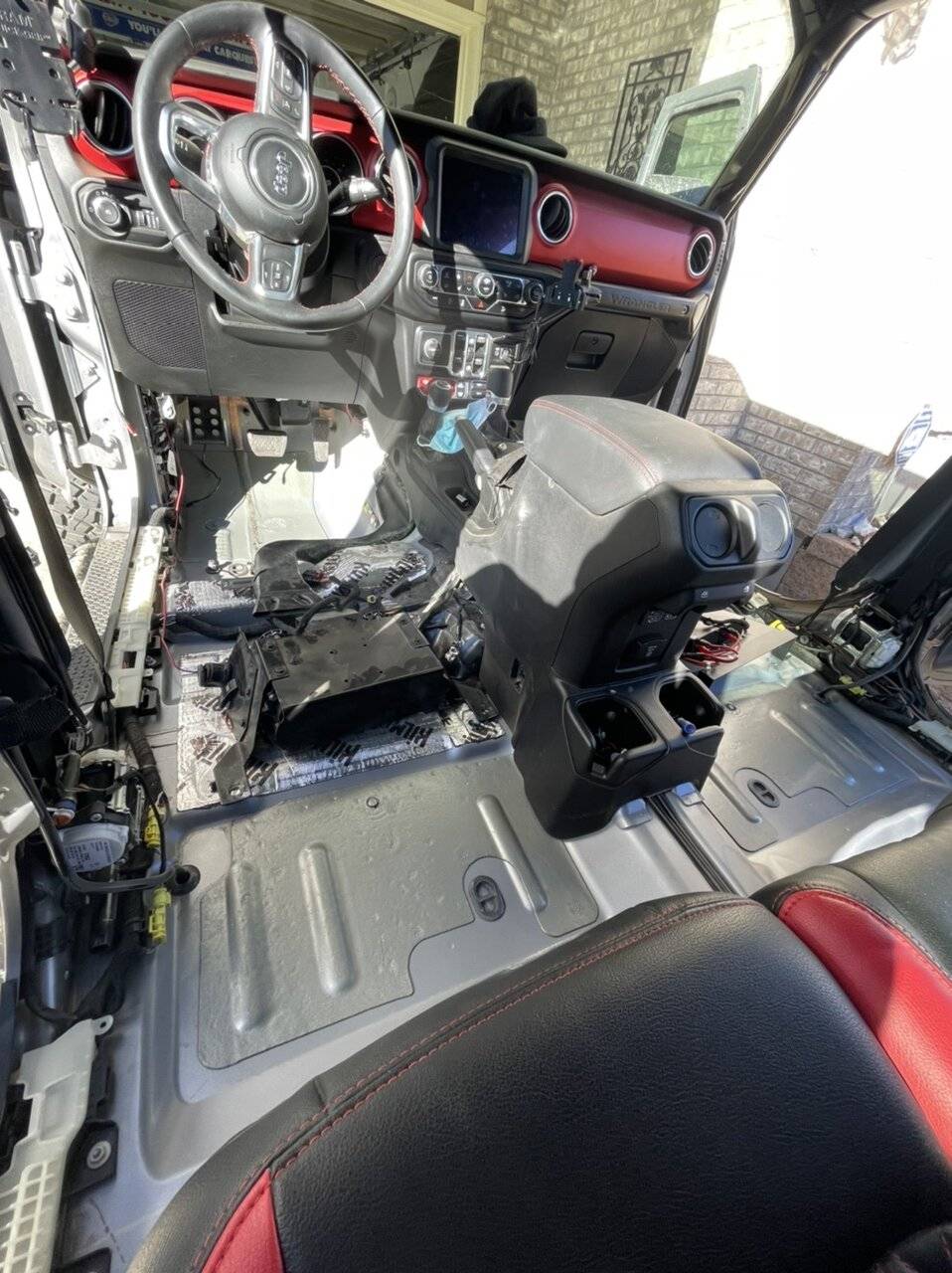

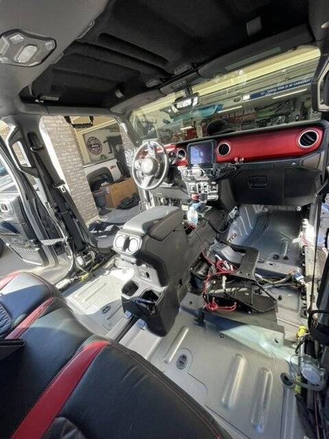

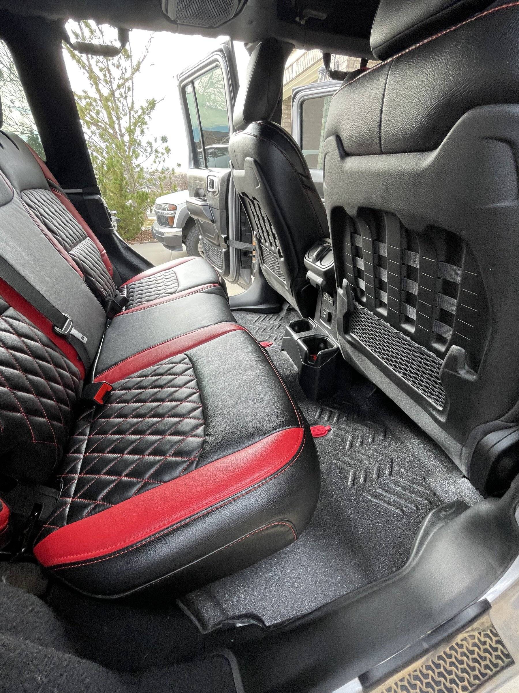

Just finished up my installation. Was a bit of a pain due to the ARB compressor under the driver seat and the amp rack under the passenger seat. Other than that, it was not bad. I did take the time to pull the factory attachment circles off the carpet and then attach them to the Armorlite. I had to cut the hole a bit larger in the armorlite to get them to reattach correctly. This should be an option from Armorlite as the hold better and look factory.
Thank you for posting your install, it looks great!
As far as the grommets, they are a Mopar produced part and can be purchased directly from Mopar or from Quadratec. We agree it finishes out the floor. We are still looking to see if we can include them as part of our kit since they are manufactured by Mopar.
Until then I encourage our users to purchase them as apposed to removing and separating your old ones as they are only about $1.50 a piece and a pain to remove. Another note is that the backing portion of the grommet is only there to retain it to the carpet for the factory install, I have installed several of just the front portion onto the stud without the back. This includes my own JL, and it has held up to an entire season of traveling and Jamborees that way.
100% agree here! It is a pain in the butt to pull those apart! You will need to trim out the holes a bit to get the OEM two part clip to attach correctly. Was not a big deal, just took a bit of time and patience.
Another reason to not use the back portion of the Grommet, the front portion does not require trimming in my experience.
