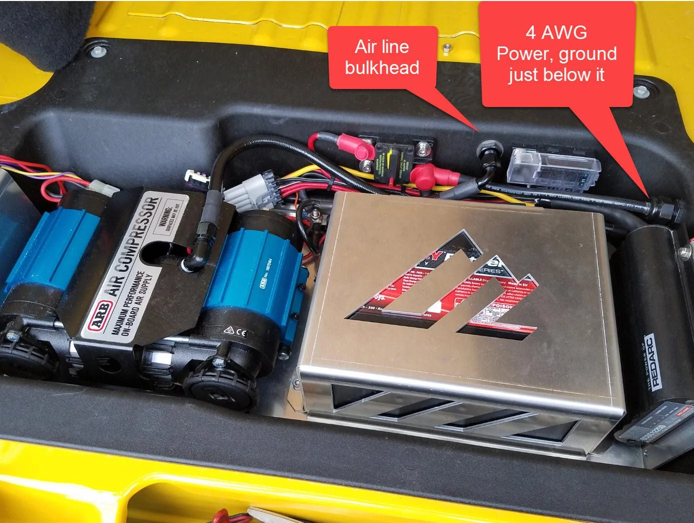

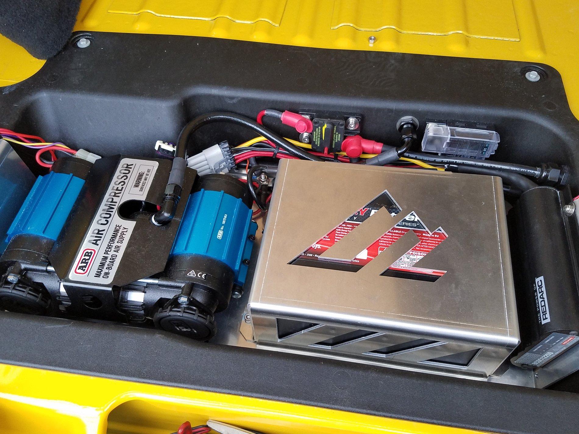

No problem with the compressor yet. I'll often open the hatch when I'm running it, but I don't always have that luxury. Around Christmas/New Years, we were on a 16 day, 2700 mile road trip with lots of wheeling, and I had to essentially air up almost every night. I've also been out wheeling where after I finished airing up my tires (37s from 8 to 32 psi), it was used to air up two other Jeeps. Sure, more ventilation would have been better, but it's not as bad as being in a hot engine compartment. Even without the hatch open, enough air manages to get in there through a lot of cracks and crevices.
I'm very impressed with how fast this compressor fills those tires. I originally made a 4-tire inflation system, but that was more of a PITA dealing with those hoses than it was worth. It didn't make life any easier at all. In fact, just the opposite, dealing with the hoses.
My current line routing is a bit complicated. First, from experience, I've learned you can't use regular hose for the first foot or two off one of these compressors. The hot, compressed air will melt it. So I used stainless braided AN-6 line off the compressor to a Tee bulkhead fitting at the front of the storage area and exiting that area. One leg will go to a small ARB air tank (I haven't installed this yet), and the other leg wraps around to the right and enters the stock jack area using another bulkhead fitting (kind of above the muffler output).
The hatch is the DPI Marine DPF1115BLK DPF Flush Series Door
I bought it off of Amazon, but it shows currently unavailable.

American Adventure Labs offers a drop-in insert that fits the ARB twin compressor and the battery (or an air tank). I had to move the compressor and battery over to fit the Redarc.
I have a 4awg cable coming from the front battery going to a 40 amp circuit breaker. The ARB compressor connects to the input of the CB and uses its own fuse holders. The CB is for the Redarc unit that charges the battery. Off the battery, I have a fuse block for the ARB fridge and a bunch of other rear lighting I use in camp.
One of the biggest advantages of using the Redarc charger, is that it can be set to charge at 15v, which is what is recommended for Odyssey batteries (the Genesis dual battery system doesn't properly charge the batteries, and they even recommend using a charger to charge them). And my stock electrical system remains intact.
The deck I fabricated. Here's a rough version.

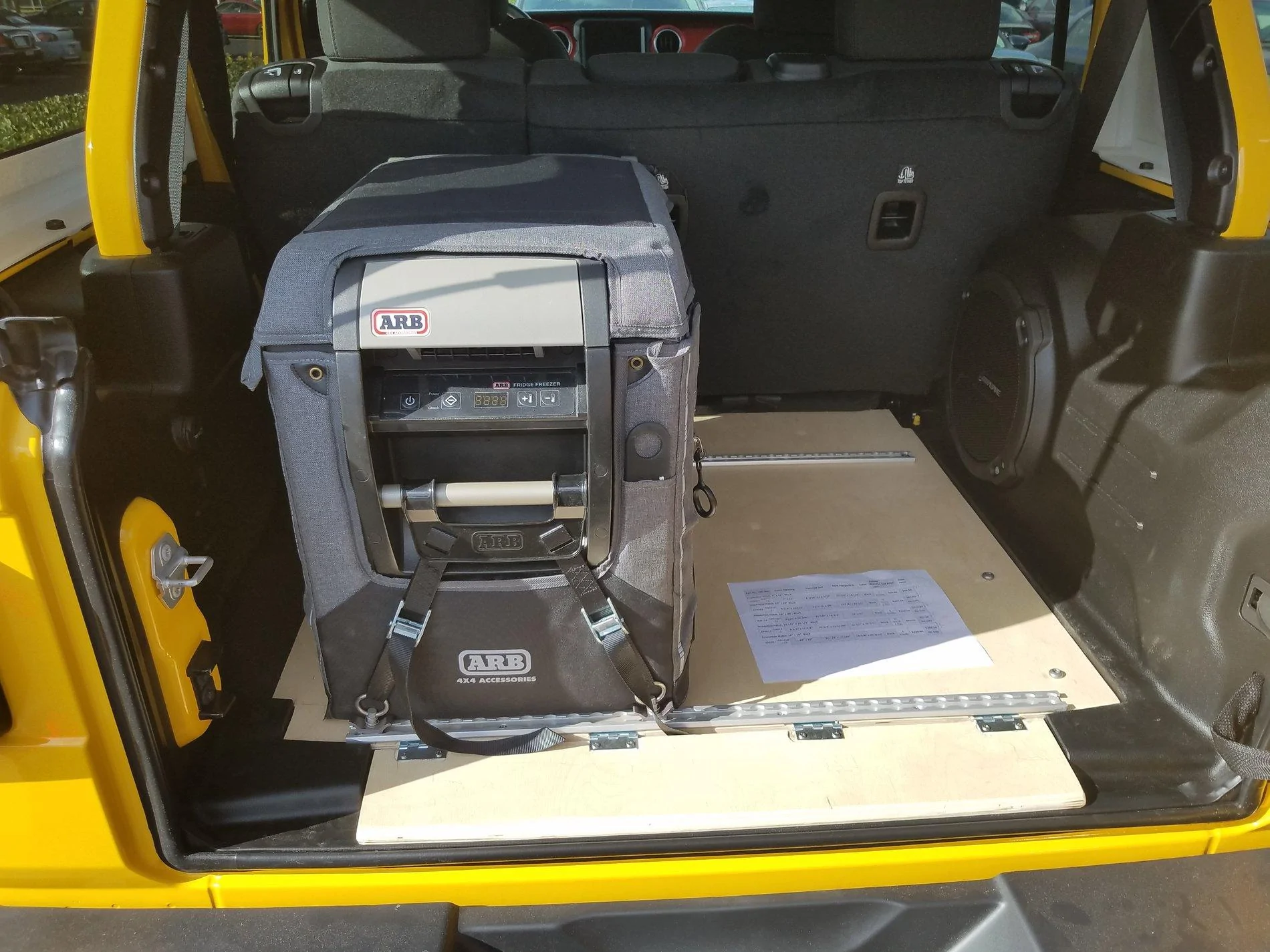

Your setup is very clean. I like the use of what would be wasted space with a refer. If you have a 4awg cable coming from the front why not use a CB and connect directly? does this keep your rear battery completely isolated? Will the Redarc charge the batt to 100% when there is a load? I am not trying to criticize, I am looking at solutions and like yours for something similar

1. The rail is some of this cargo rail (link below). I didn't actually buy this one, but it's the same. Though black would have looked better it wouldn't after it got all scratched up. I lucked out with the front, as I was actually able to bolt it down using the stock front bolt holes from the stock tie-down, further making this assembly secure. I still used the other two bolt holes on either side. The rear track is attached with stainless screws and T-nuts to the 1/2" marine plywood.
https://www.amazon.com/Pit-Posse-Al...cargo+rail&qid=1586109019&s=automotive&sr=1-3
2. It was some old trunk cloth I had from a long time ago. It's not carpet, but it was often referred to as trunk liner or trunk cloth. It's reasonably durable. What's nice is that it stretches pretty well around corners, whereas carpet doesn't stretch. This isn't the actual stuff, but maybe close. It's usually available in a few colors. However, sometimes the black has gray speckles, so watch out for that.
https://www.amazon.com/Black-Automotive-Upholstery-Carpet-Flexible/dp/B07G5SLTQ2
3. I actually bought some heavy duty drawer slides and a bunch of aluminum to make a fridge slide, but I didn't. Since I don't currently have a shelf above the fridge, there's really no need to slide it out. Maybe if I ever do have a shelf, I might get back to making one. There were two reasons I didn't make the slide: the height added would have made me move fridge over to the right a bit more to clear the tailgate and seat back, and I didn't want that. Also, the rails are heavy duty - emphasis on heavy. I'm guessing by the time I was done, my slide assembly would have weighed at least 10-15 pounds. That's weight that didn't really serve a need... yet. As mentioned, I'm trying not to add weight unless I need it.
4. At this point, no changes planned, and so far, there's nothing I'd like to do any different. Well, I still need to figure out where my plug for the fridge is going to go. Right now, it's just a pig-tail from the Jeep that the fridge plugs into. I had some ideas where I was going to put an outlet, but I'm glad I didn't, as I found that I pack stuff right in the areas I was considering putting it, so I may end up just leaving it as a pig-tail. I'll continue to monitor my usage as it relates to that to see if I want to do that differently.
