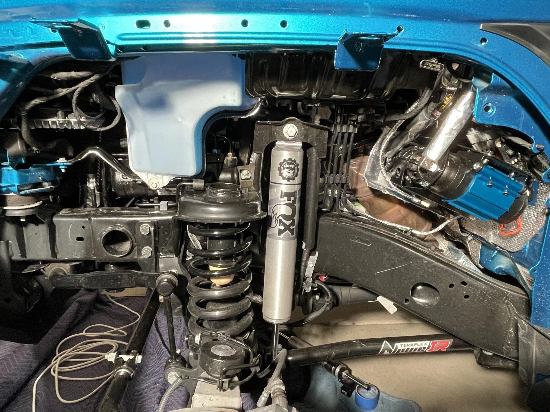

I am just finishing up the Grimm Off-Road kit W/ARB Twin Compressor and have to say it is a well thought-out kit. The air filters are moved up to top of the engine compartment mounted inside the fender and Grimm also includes a heat shield for the ARB Twin. As for the heat shielding, since I live in Hells Acres (AZ desert) I added some additional heat shielding to both the Grimm heat shield and also installed sleeve heat shielding over the air lines.
Install note: When I went to mount the Grimm fender mount (with switch & air lines/filters) the windshield washer lines were pushed hard against the edge of the bracket-an easy fix to pop the push-pin holding the lines to the OEM bracket out and using a small tool bend the OEM bracket down for additional clearance and reinstall the push-pin/washer lines.
With the fender already removed, thought I would use the opportunity to re-torque everything on the front end as well as run power cables for the two new JL Audio amps...A complete audio & interior upgrade will soon begin...
