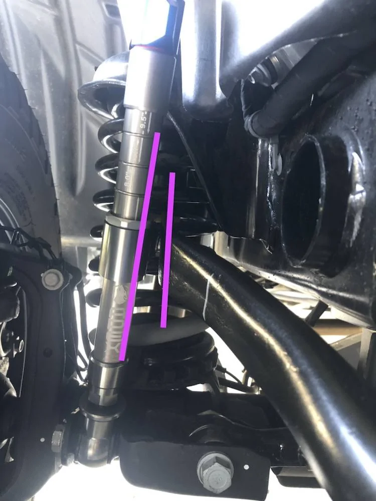

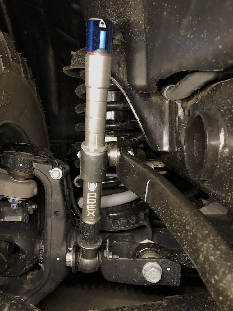

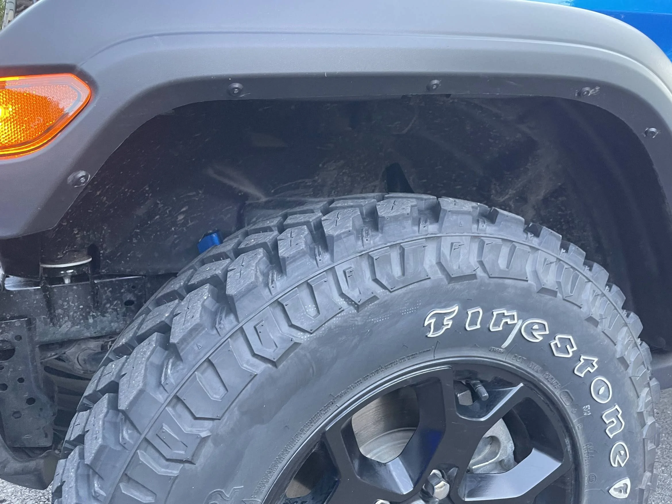

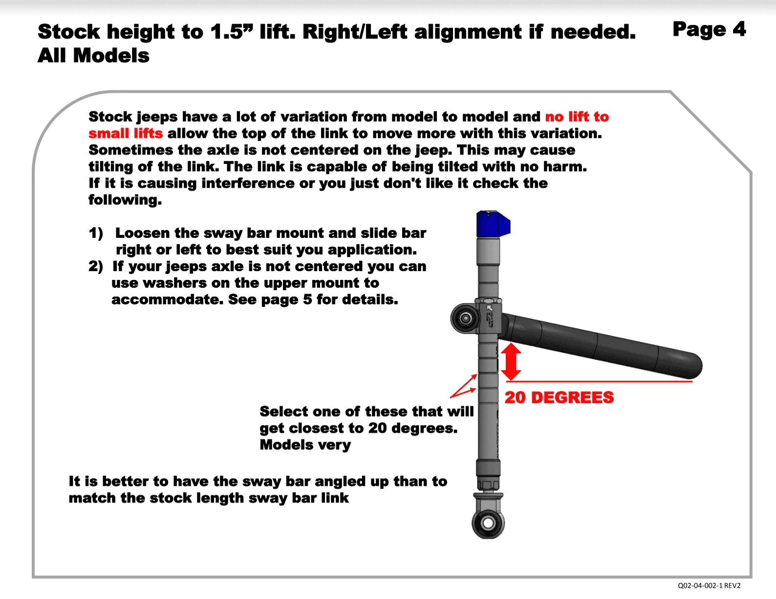

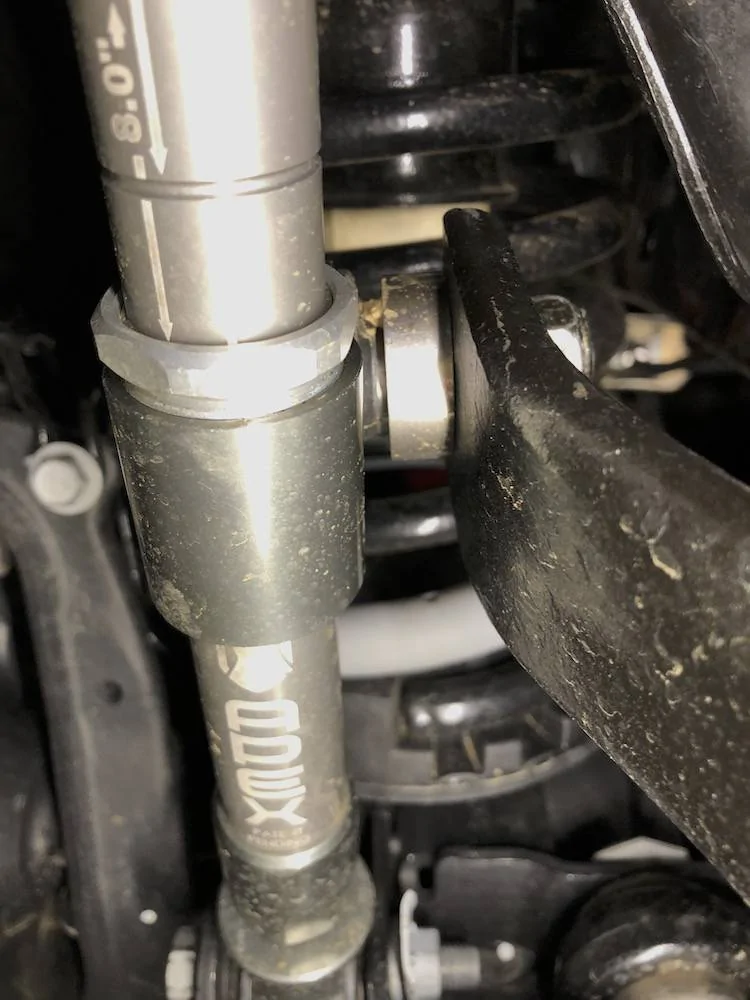

I bought these this week and this morning tried to install them. Be aware that if you have what I have, a stock 2021 Willys Sport, these will NOT work with the sway bar that comes installed.Any updates? I am looking at these but there don't seem to be many independent reviews so I'd like to hear from people not affiliated with the mfg. if possible.
I am tired of struggling with my quick disconnects. Needing level ground and another person to sit on the bumper etc. is getting old for this old man.
