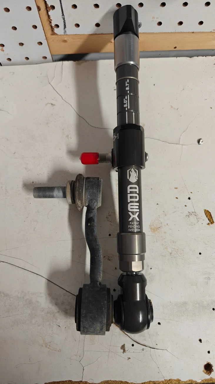

I messaged Apex Design and am waiting for a response. Until then maybe some of you have ran across this.
The lowest setting is 6.5" but the factory end links measure 5.5". My question is what is the proper method to install?
Do I loosen the sway bar and rotate it until in naturally sits at 6.5" and things line up and install easy?
Or do I just get a pry bar and force it?

That makes sense. I only removed one side so it was tough to move. It's just how my brain works. Do one side then the other. That way when it all goes wrong I don't have as much to put back together. :facepalm:

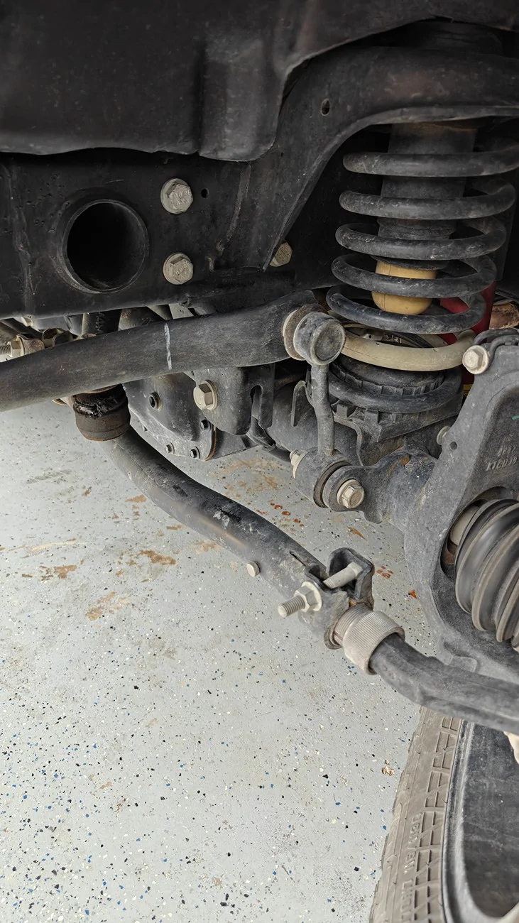

While you're under there, you may want to inspect the boot on the end of your drag link. Looks torn, which will introduce grime/loss of lubricant and eventually lead to a loose joint.

Thanks, that's been torn for quite a while. Figure get as much use out of it that I can, it's not a problem until it is.
