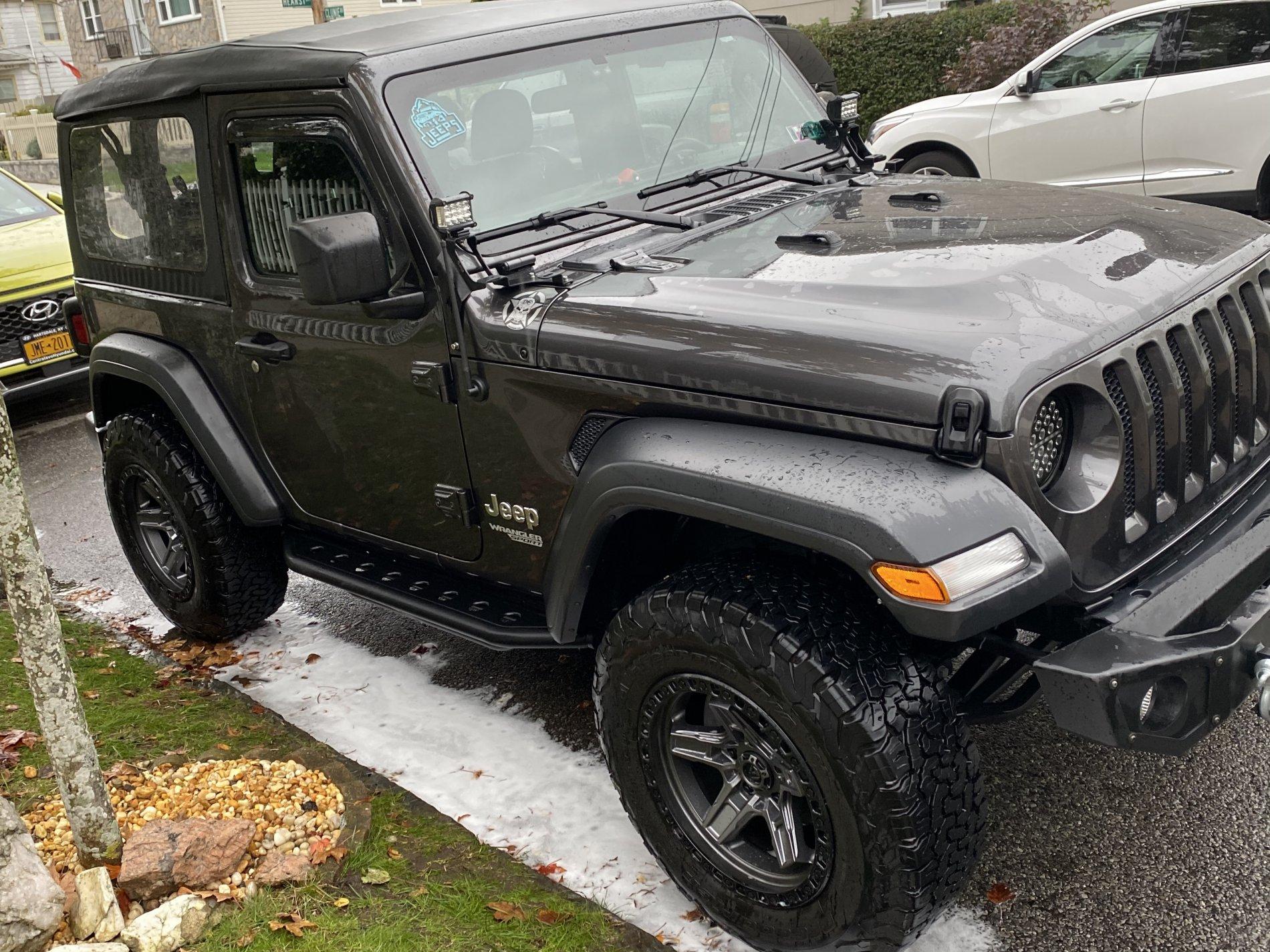

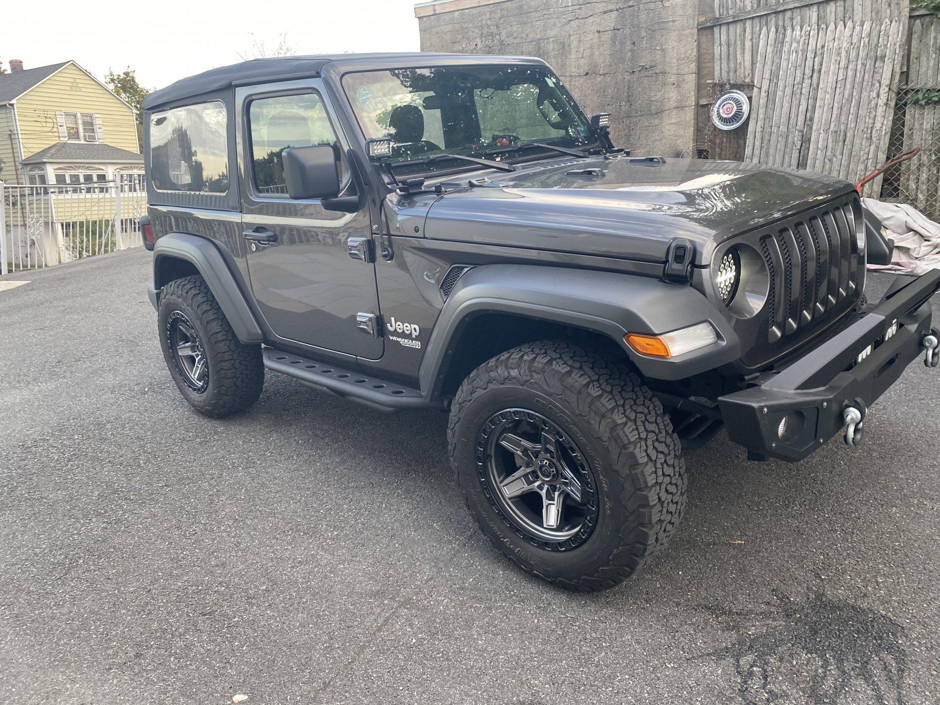

I like. They match the color of the Jeep.

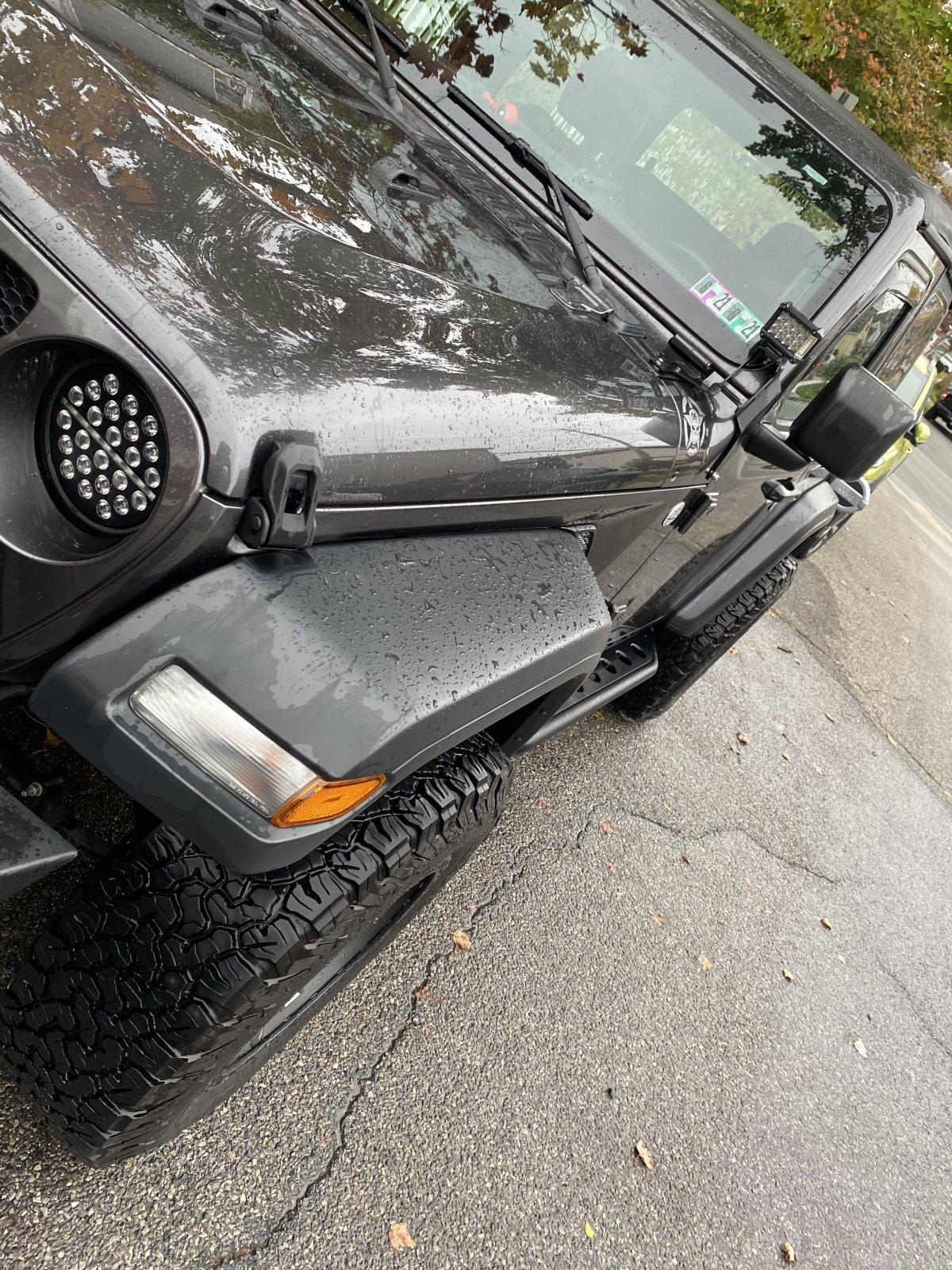

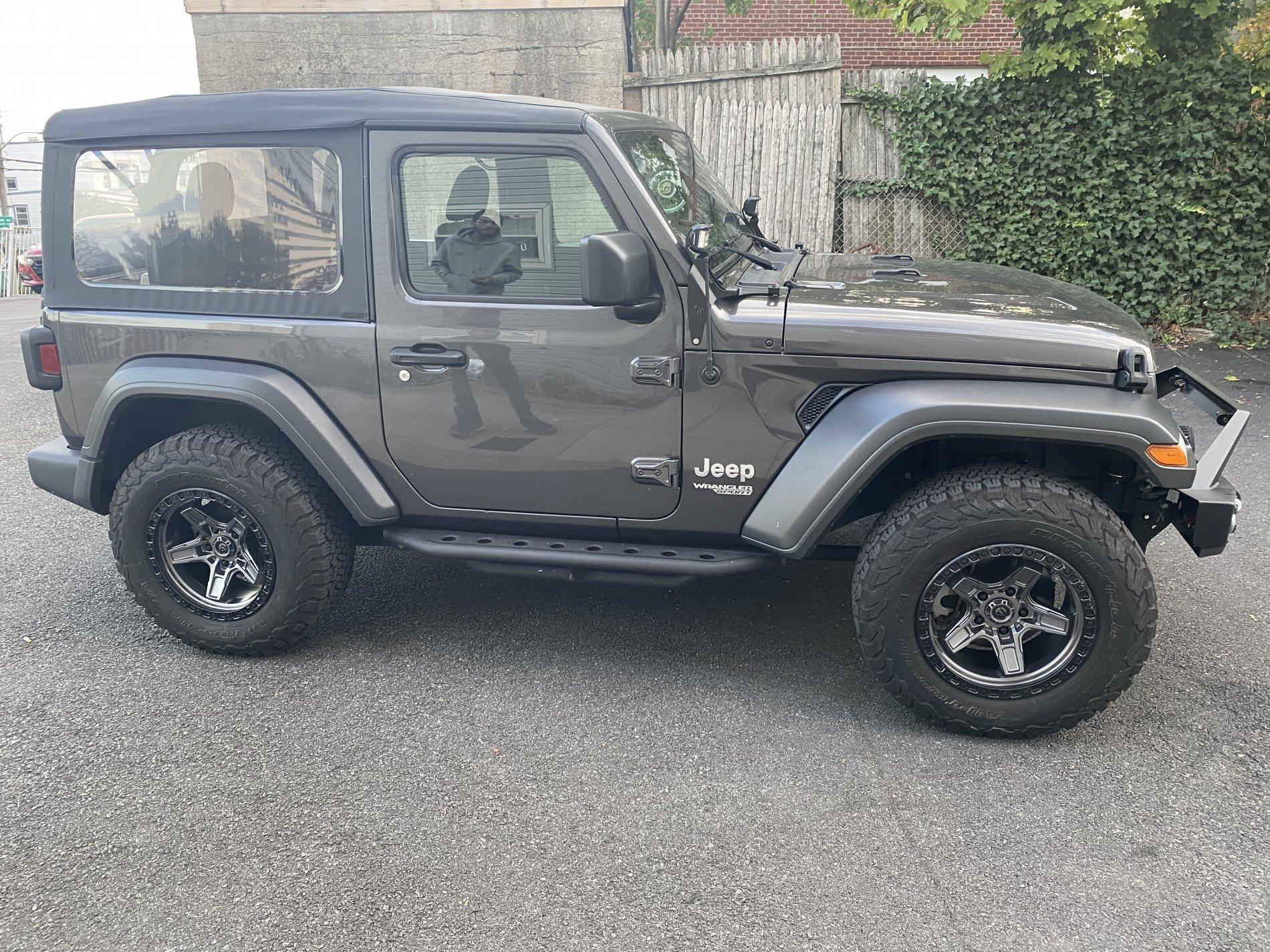

Please post one from the front and one from the back if you have them. I want to see how far they stick out past the fenders.
What size tires are these?

17x9 -12. And i can post more just has to wait till i can get a break. If not ill post them in the morning. They stick out about .75-1 inch with oem k02s.
