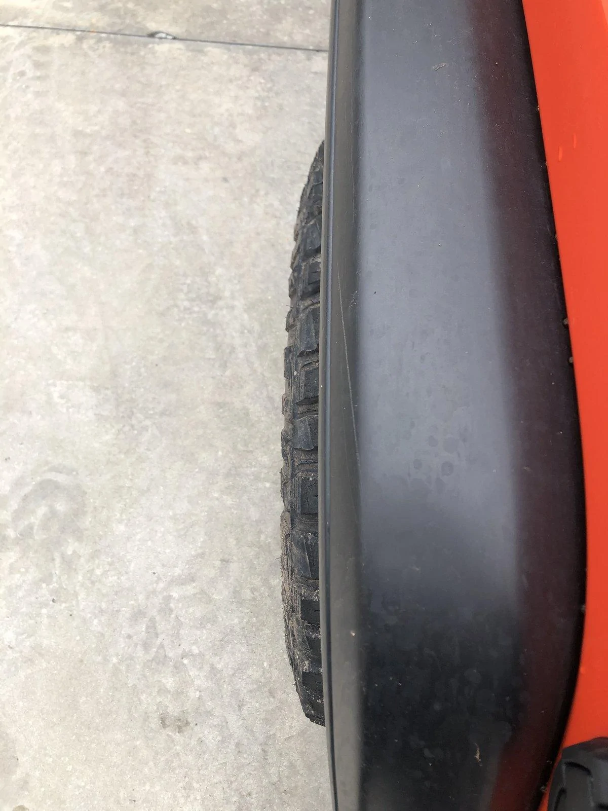

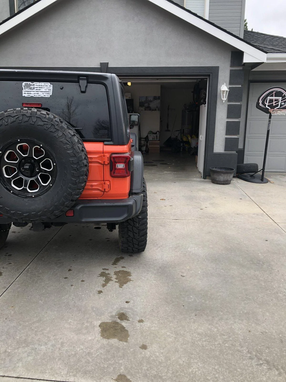

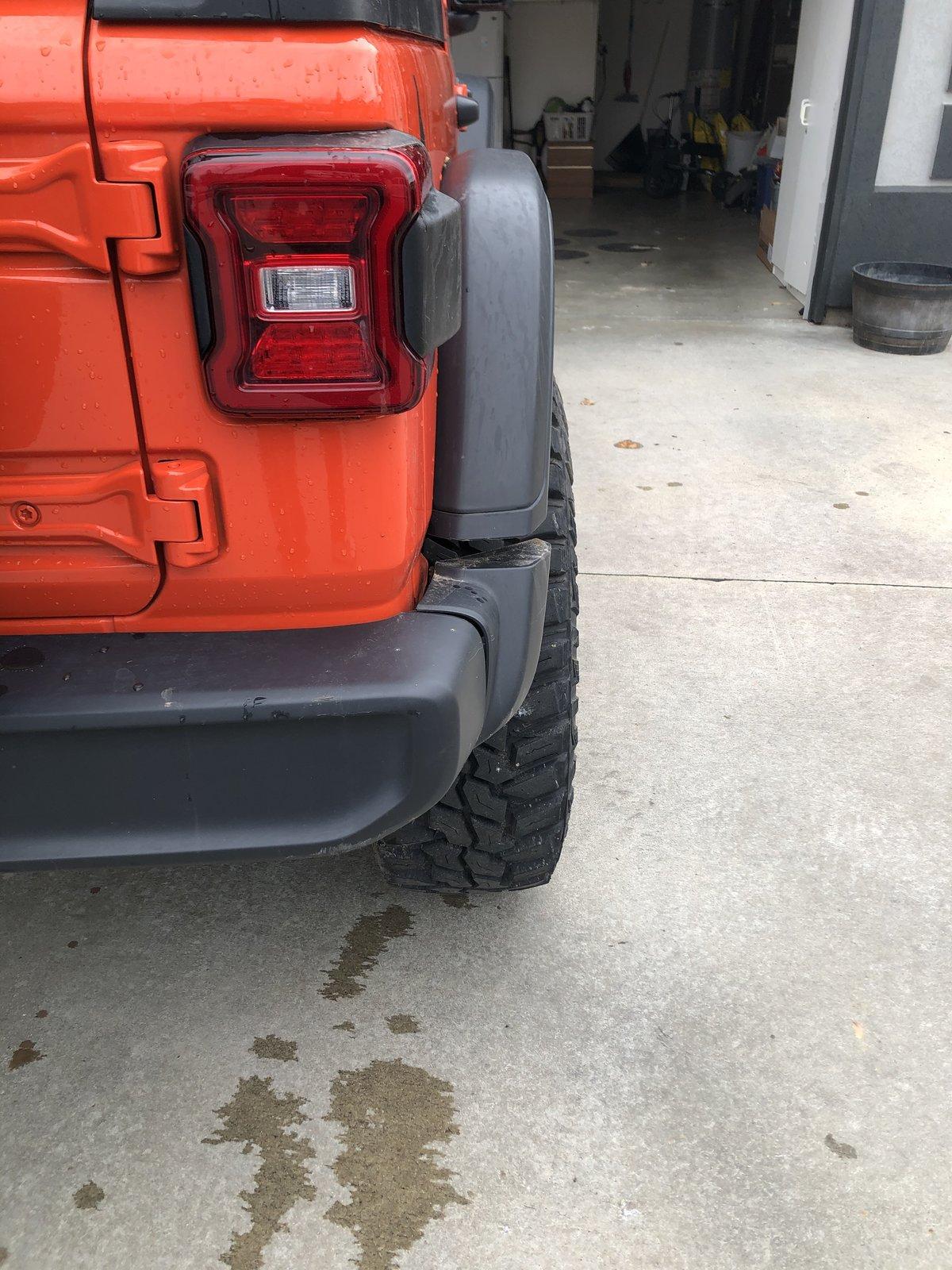

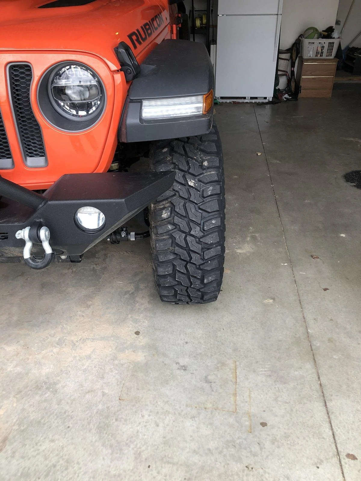

I'm running 315/70/17s 17x9 -6 and they already stick out a good amount. If you put -12s on there they are going to stick waay out. Other than that they shoud fit fine, but yeap all that extra force on things that weren't meant to be stressed like that will probably cause an issue. I'll post a pic of mine so you can see what it looks like.

Oh.. let me warn you about this now: "Tire browning..." be prepared to to battle with it, and stay on top if it. I have only had my 35s a few months and they are brown as crap, and I'm struggling to get it off. So far I am many hours in and probably not winning the battle.

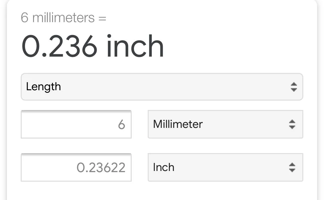

Maybe you’re confused. If they are the same width and the only difference is 6mm of offset, being more negative in this case they are going to stick out 6mm more which is negligible. .2 of an inch. If the wheels are different widths and offset they may be significantly different.

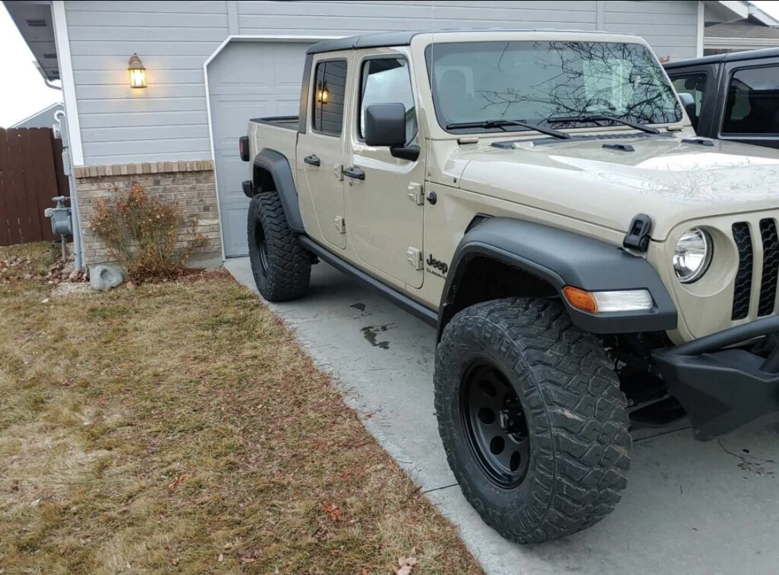

I’d recommend the -12 with you having a sport. The rubicon axles are 3/4 inch wider on each side (1.5 inches wider overall) than the sport. I run 37x12.5 on 17x9+12 and they just clear at full turn and flexing. I get it you said you don’t off road but have a buddy with a gladiator and 17x9-12 with 35s and he still rubs at full turn occasionally. Mine is the wrangler and +12 on the rubicon. His is the gladiator on -12. Gladiator is a sport model with non max tow axles so would be same width as normal wrangler sport axles.

Yes. I understand that they will stick out quite a bit more than stock, but he made it sound like the -12 vs -6 will stick out way more which isn’t the case. The -12 vs his -6 is about the same. .2 inches difference. Good luck with your decision.

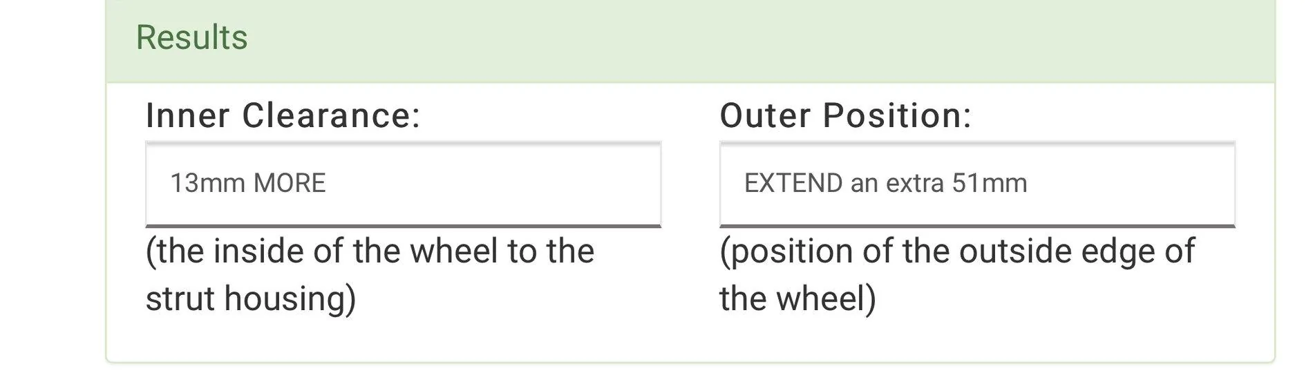

That being said if you’re trying to talk yourself in to the +12 you can always adjust the steering stops if you can’t crank the wheel all the way without rubbing. The +12 wheels will have 13mm more inner clearance vs stock wheels, so you may not rub when mounted but may at full turn on the frame or LCA. Below comparison is stock 7.5 wide +44 offset vs 9 wide +12 offset wheel.

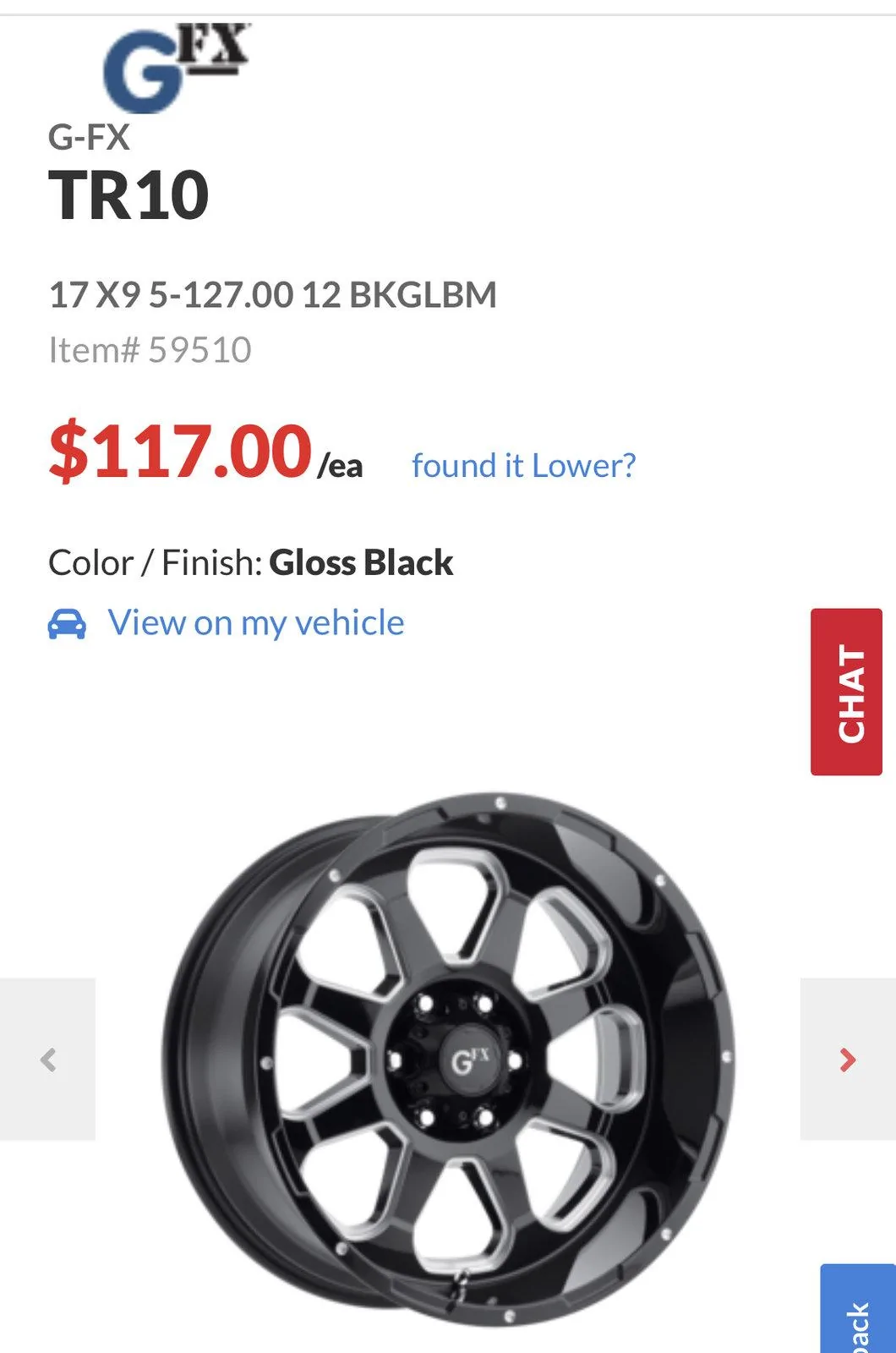

Not sure if you’re still looking at 17x9 +12 but I got these from discount and have been happy with them. I didn’t want expensive wheels as I knew I was going to beat them up off road and I have. I actually waited until a holiday sale with rebates and got all 5 for $500.

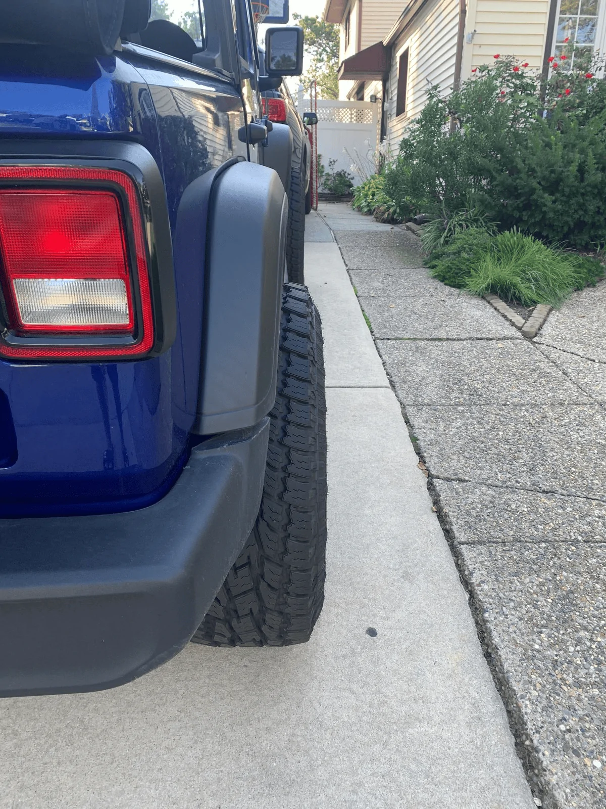

Here’s a 17x9.5 -18 offset

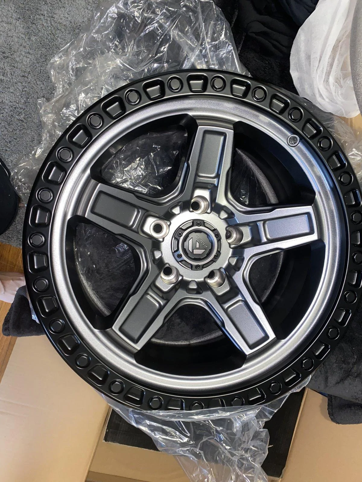

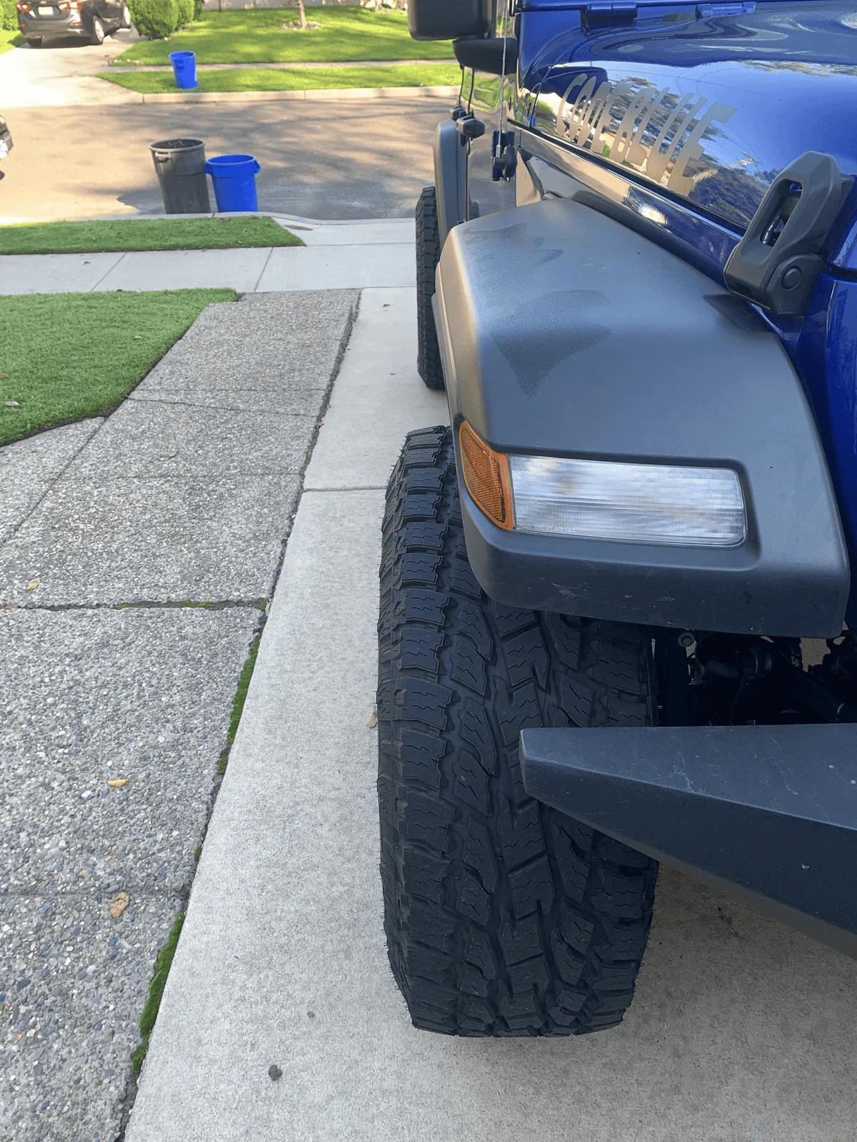

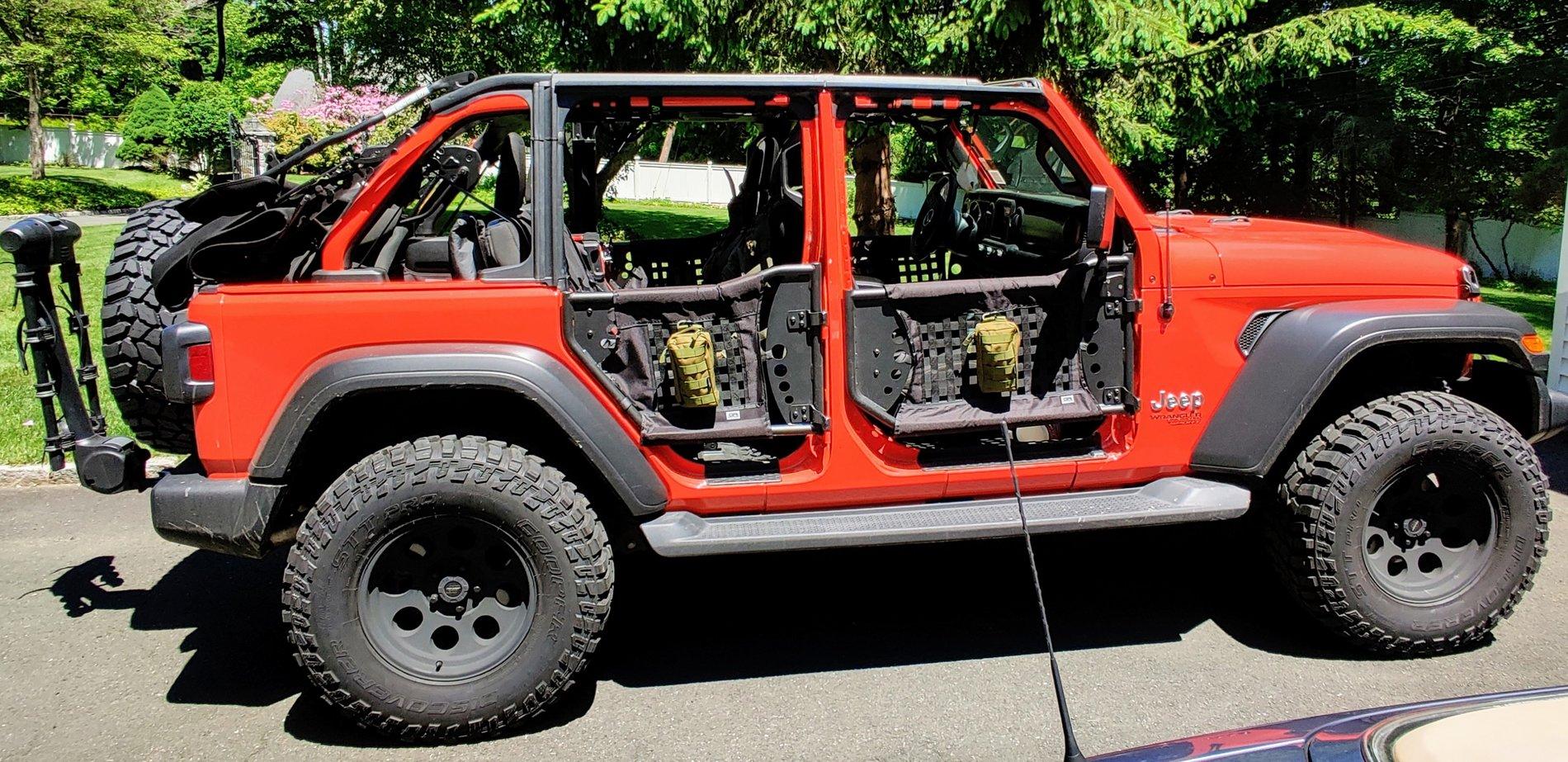

Hay guys. Just jumping in here. I got a great deal on some fuel kicker 5’s from a local shop. I plan on running 33’s soon. Does anyone know or have pictures of how these will fit? 17x9 -12 71.5
Headbarcode
Aug 16, 2018
5,518
12,106
LI, New York
2019 JLUR Stingray 2.0 turbo
The wheels outer bead will be 2.22" further out than your factory wheels.
