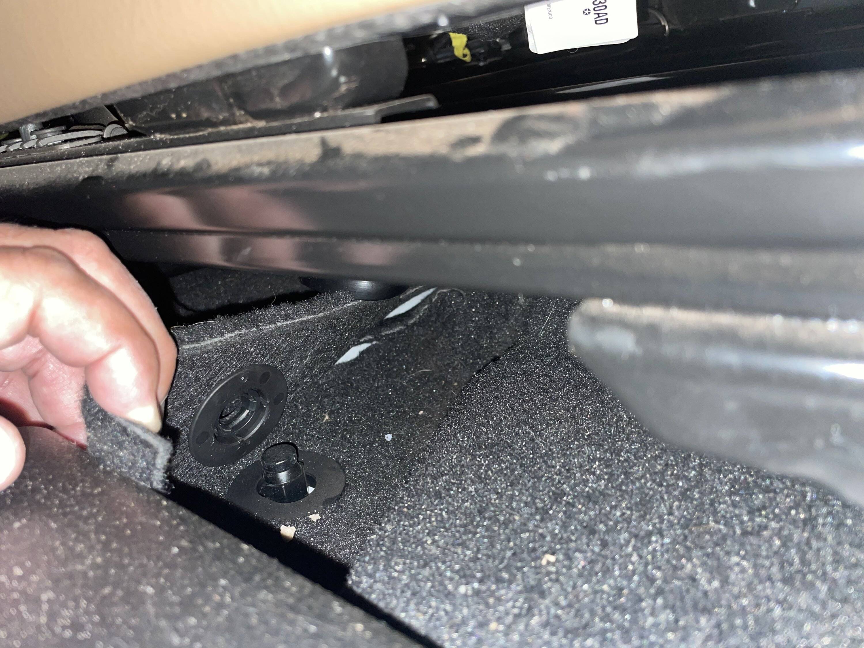

- 1st pic is how it looks now. The oval "plug" carpet lying directly on top of pinned carpet below. Up close!

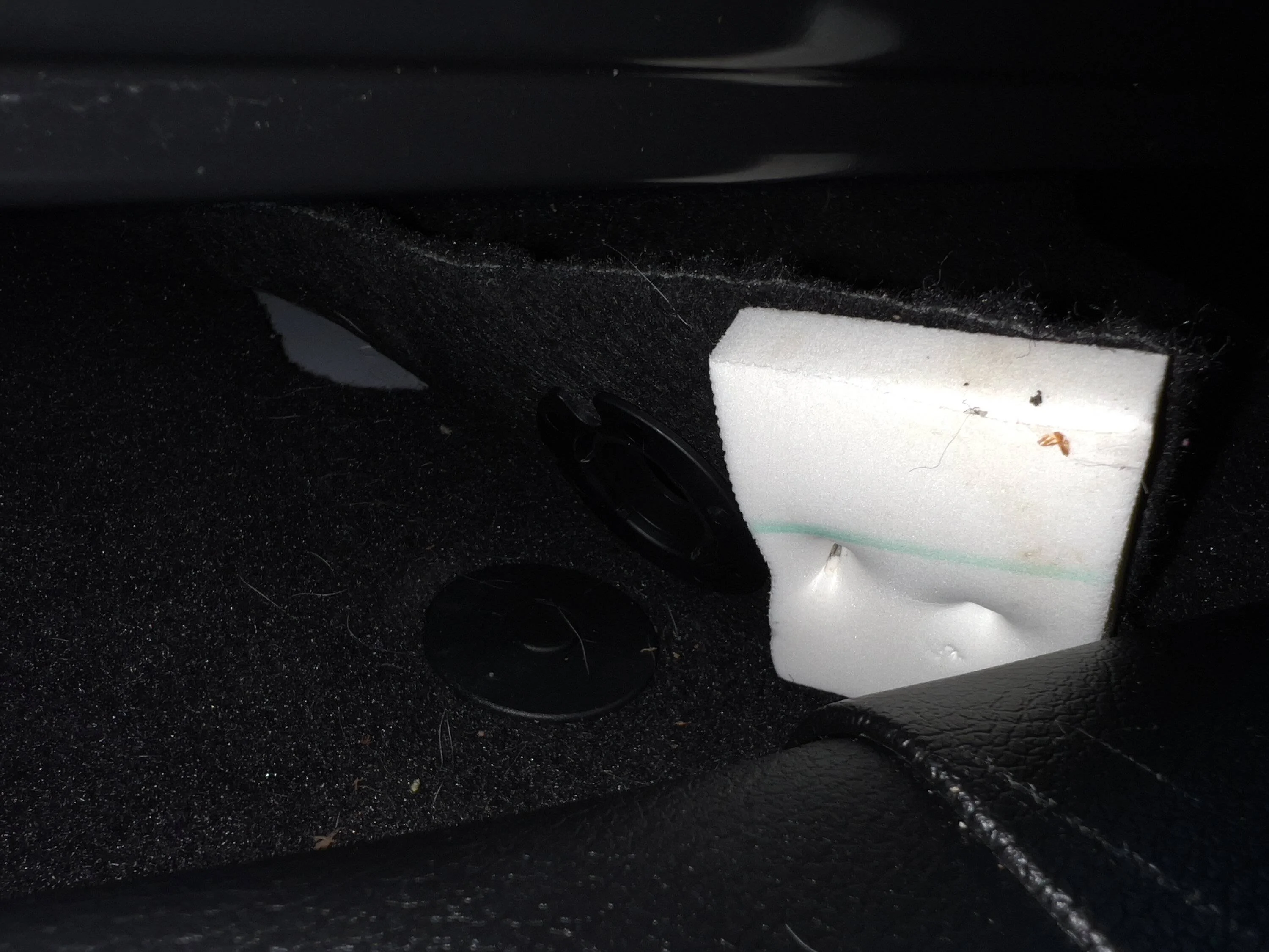

- 2nd is what it looks like under pic #1. You can see the foam (which is mearly stapled to the upper carpet with oval insert) and the bottom carpet which is attached to the carpet "peg".

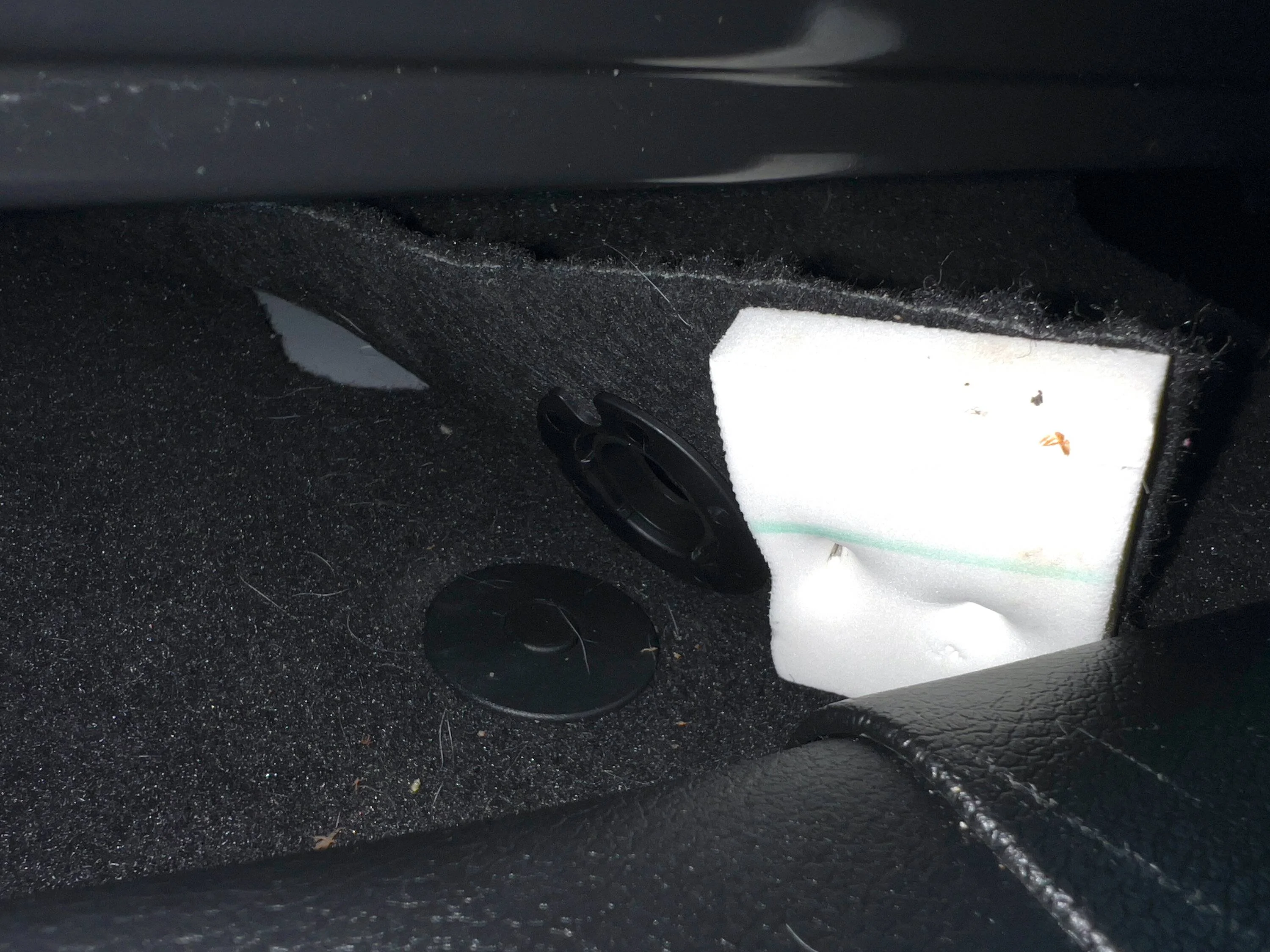

- 3rd is staight shot under seat (you can see the heater outlet). Doesn't really show much but I was trying to depict the way that the carpets don't lie on top of each other properly
My initial thought was that this was a part of the factory packaging for delivery that wasn't removed by the dealer but now I'm questioning why the oval plug is in the carpet with the white foam...

The picture with the foam was really dark so I tried to lighten it up a better contrast that's about all I know how to do though lol.

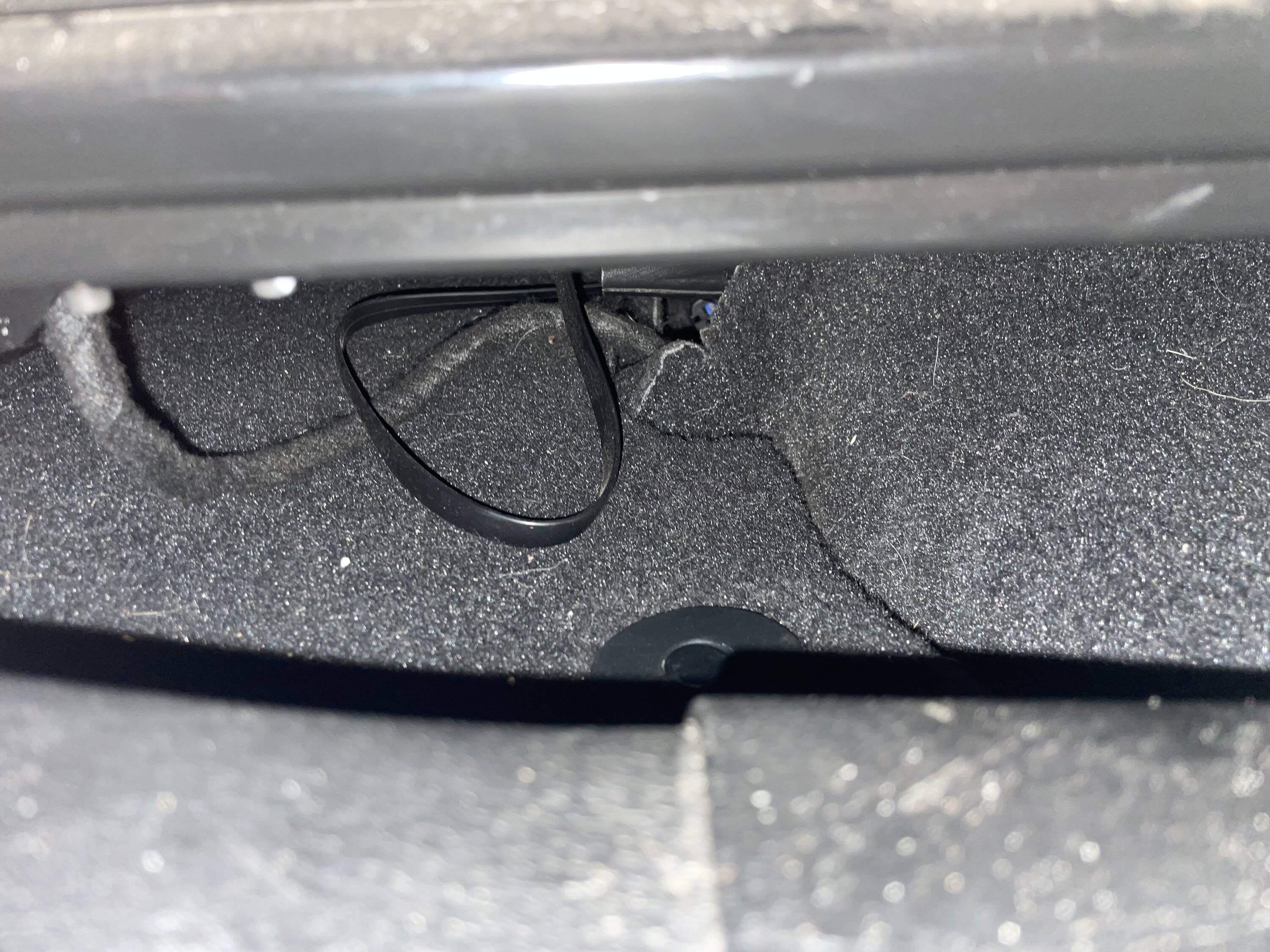

We still have the carpet, earlier installed our GMRS unit under the front passenger seat and couldn't recall whether there was foam or not. Here are a couple shots just taken this evening. We didn't tear anything out, just added some wiring and the radio.
Jeep Wrangler JL Any idea what is going on here? 4A2C2BB9-A71A-4245-AFC4-D332A4AF3934
Jeep Wrangler JL Any idea what is going on here? 3A6C4844-C1CB-437B-A39C-1B0F3F55DDFB
It may be noteworthy that ours has the back piece atop the front? And there is no foam under the front piece either. Also, our front piece has an oval; the rear piece is round and locks both pieces down.

Yours are installed backwards. Slip the piece with the foam down under the other.
