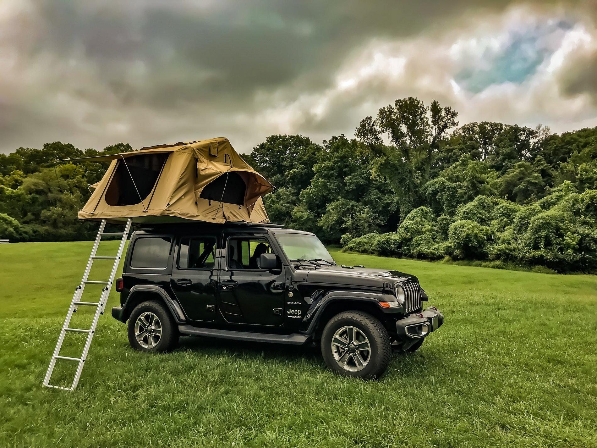

Mounting it took an hour and a half. I measured out the distance of the outer slats in the pioneer platform and drilled new holes on the tent and sealed the pre-drilled ones up with silicone. I used the small metal bracket that came with the tent on each corner of the tent to put two bolts on each one with a total of 8 bolts holding it down. The bolts are a bit long so i had to use three washers as the pioneer platform slats are shallow. I’ll post some pictures of the hardware i used when i get home.
