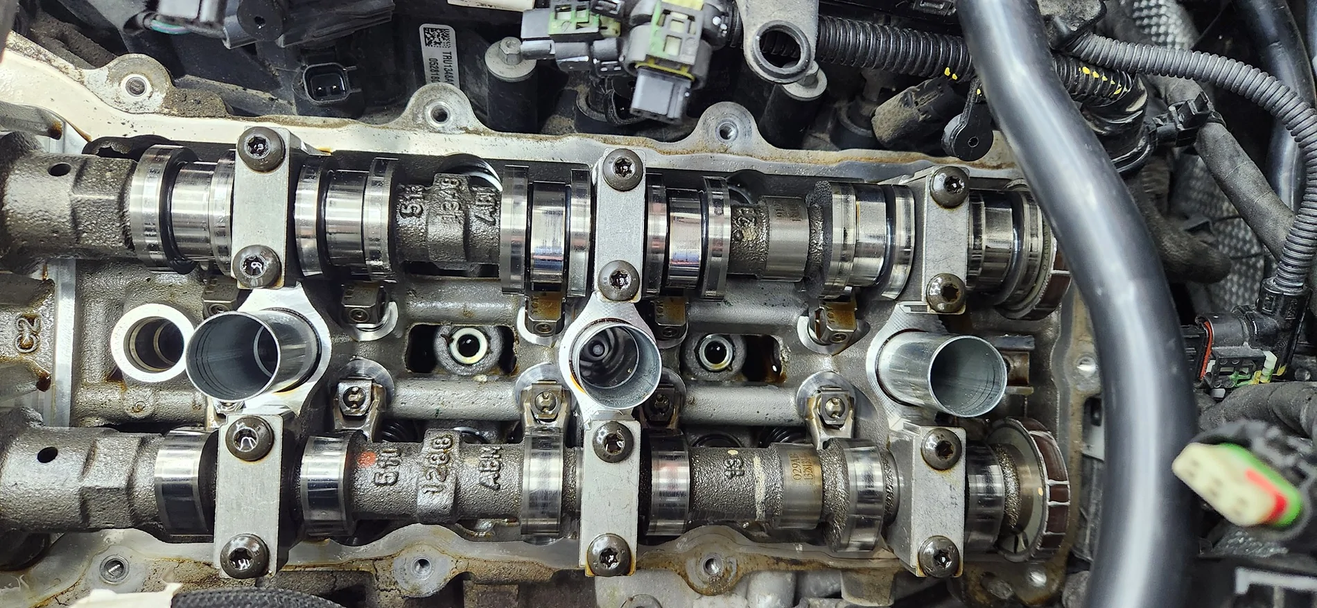

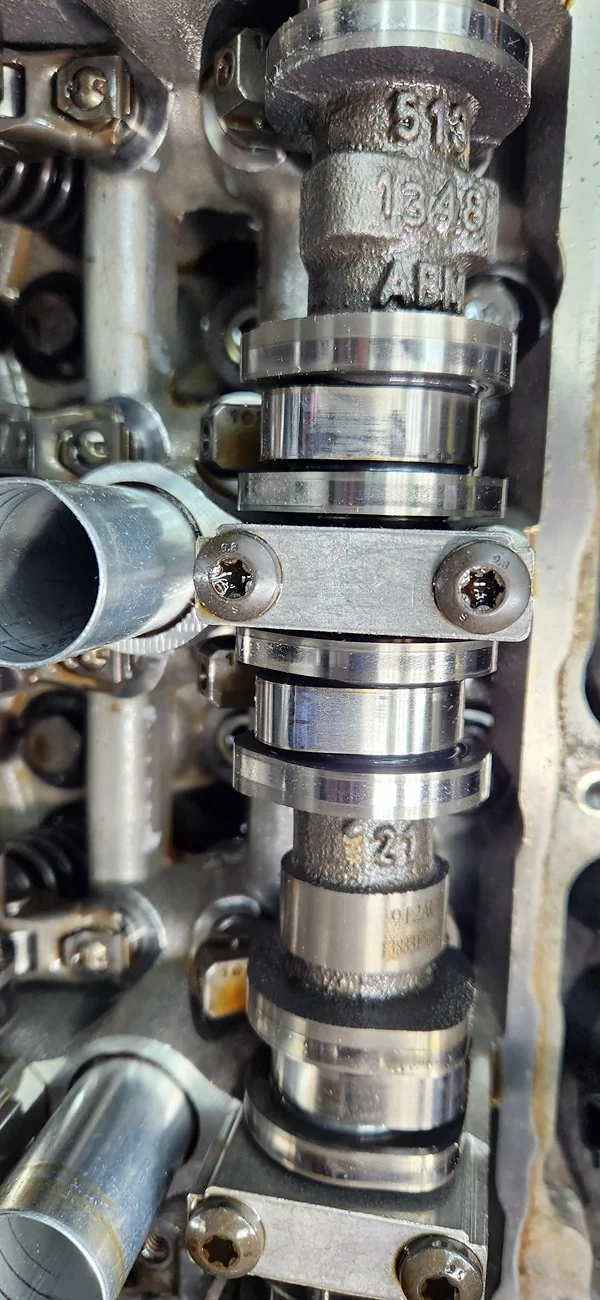

I have an intermittent cylinder 3 misfire and disappearing coolant, I scope the cylinder and #3 has been steam cleaned and looks brand new. I started tearing into it today to replace the head gasket, and noticed some wear starting on an intake cam lobe and another lobe very discolored. I'll be replacing that cam, when I took the driver side apart, the intake cam has some discoloration to it and I wanted the experts opinion on if it should be replaced. I'm leaning towards yes, because I am already in there.
Here's the passenger side that needs to be replaced.
Jeep Wrangler JL Another headgasket and cam question 20251029_194347

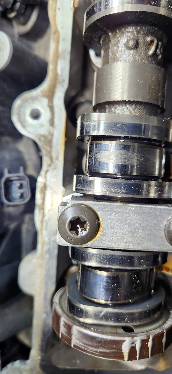

And here's the driver side I am questioning, the top lobe in the pic.
Jeep Wrangler JL Another headgasket and cam question 20251029_211307
And then, while I am in there, obviously rockers, and an oil cooler, anything else? I'm at 87k miles.

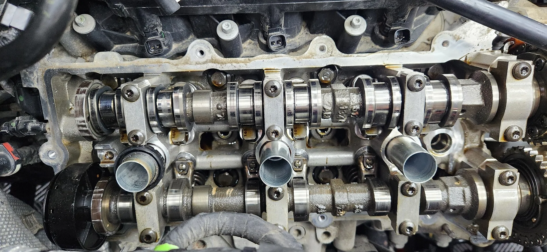

I just ran out and snapped 2 more photos. Here's the driver side, looking at it again, the exhaust lobes look like they had some heat in them too.
Jeep Wrangler JL Another headgasket and cam question 20251029_214323
The passenger side exhaust looks fine to me.

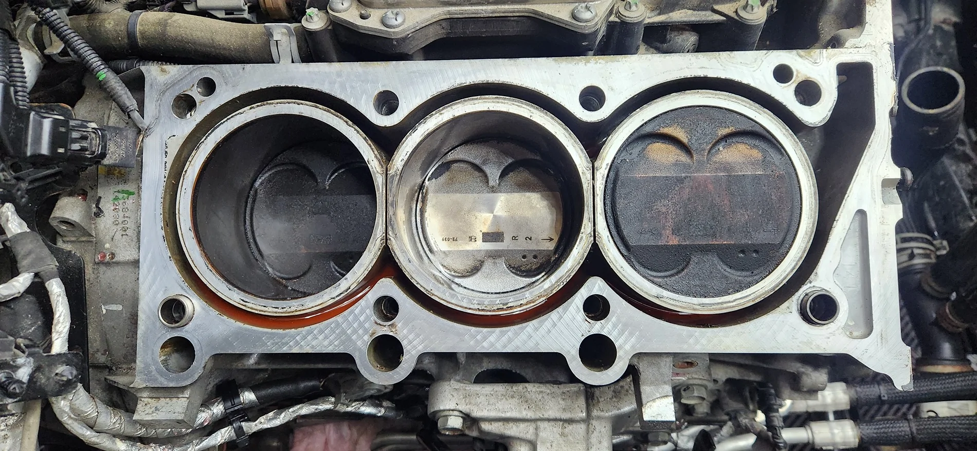

The oil filter was spotless. But, I've only owned this jeep for a few months, I see why I got a deal on it now.
I ended up ordering a new set of cams, rockers and 'lifters' for it, as well as a oil cooler.
You can definitely see which cylinder had the head gasket leak

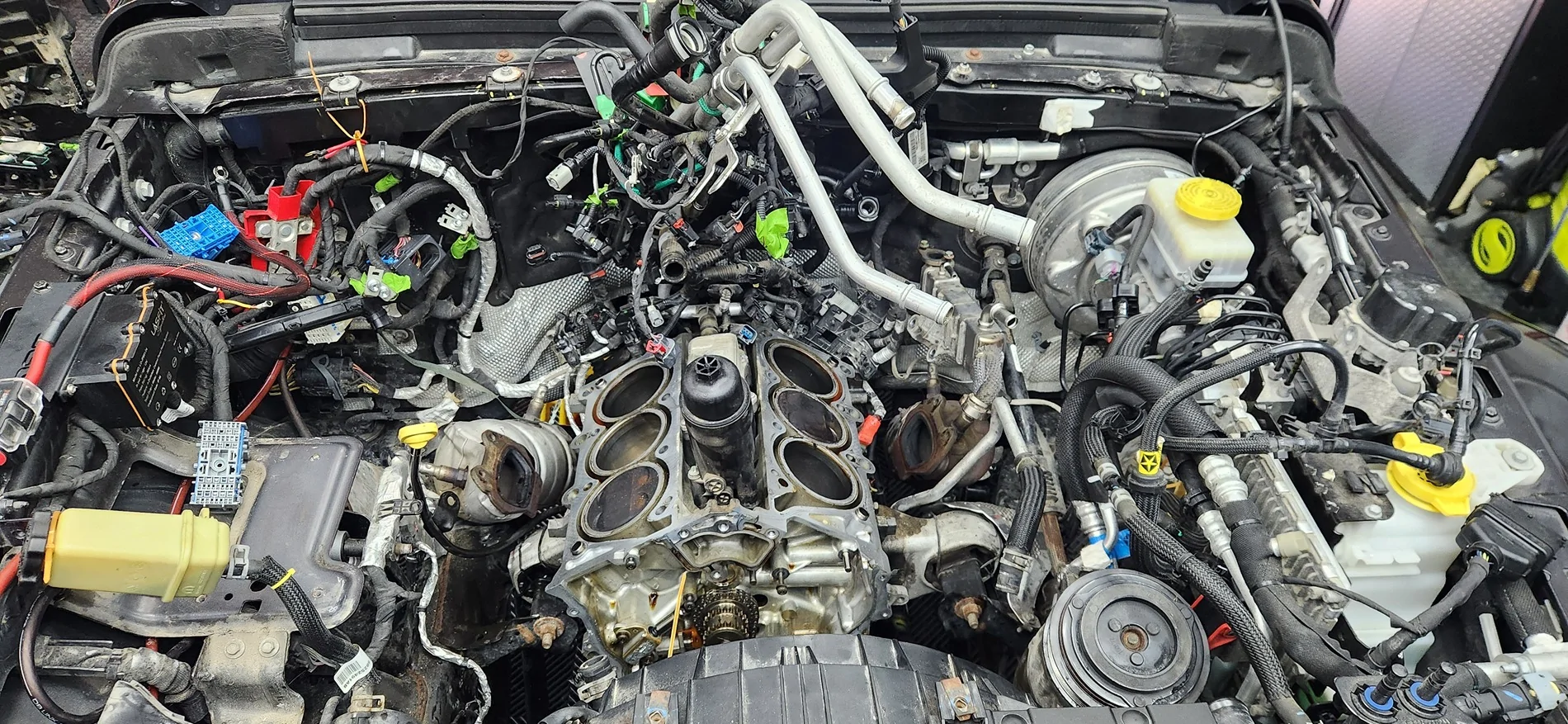

It wasn't too hard to strip down, the timing cover was difficult to remove, and a couple of connector clip locks broke, but that was about it.
I'm trying to decide if I should replace my aux battery, or just delete it when I put everything back together.

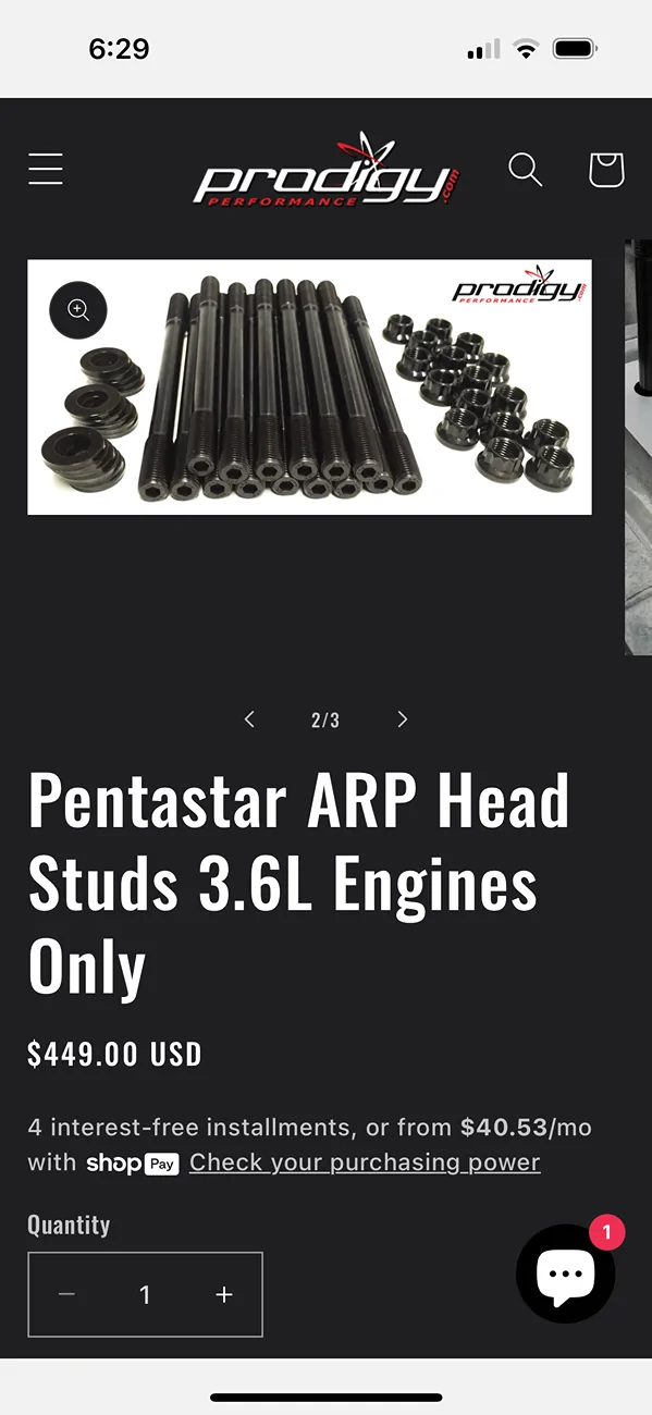

Do your engine a favor and get an ARP stud kit for it.
