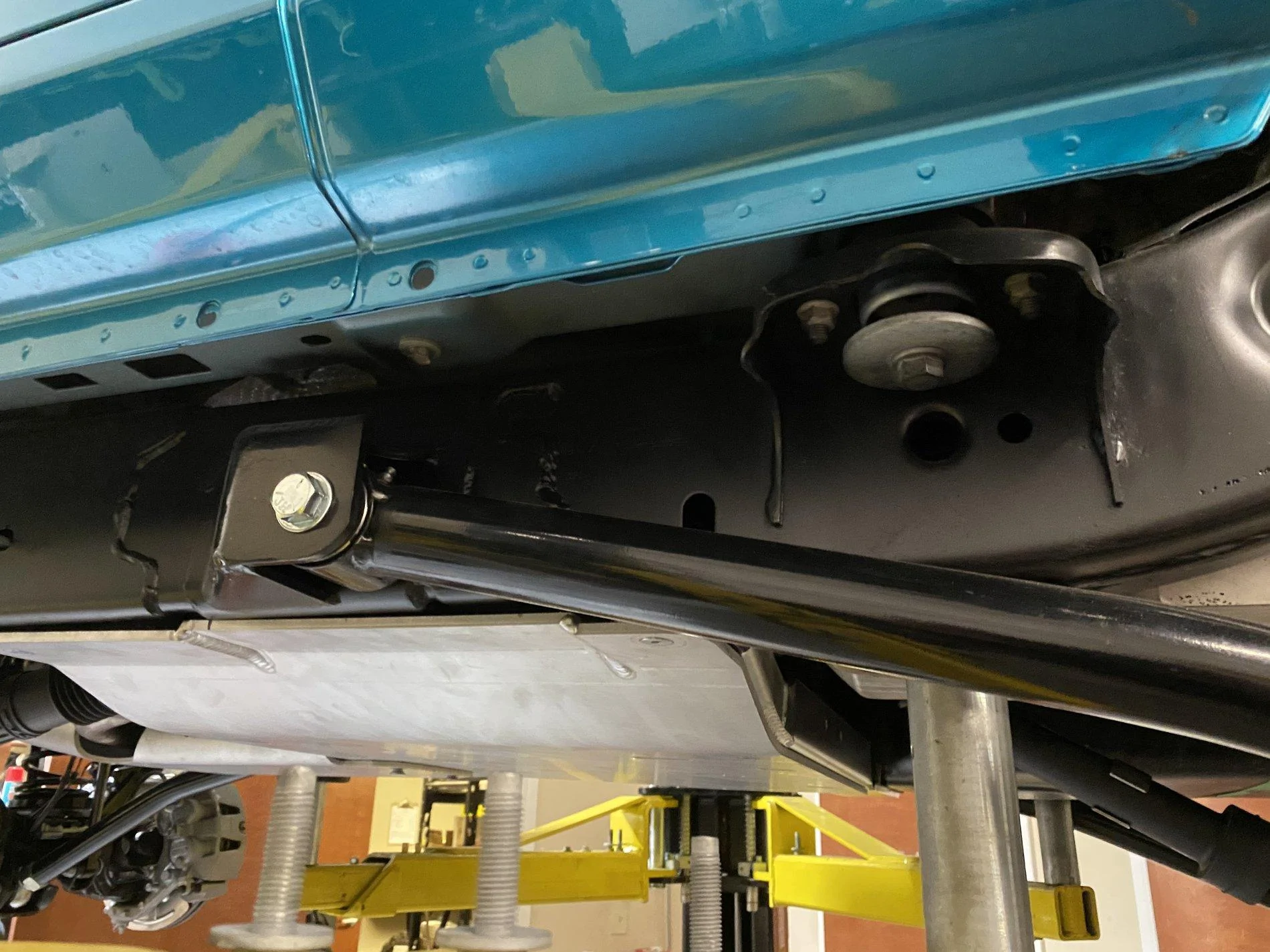

On my 2020 2-Door Rubicon, the welds left rear bracket looked like this:

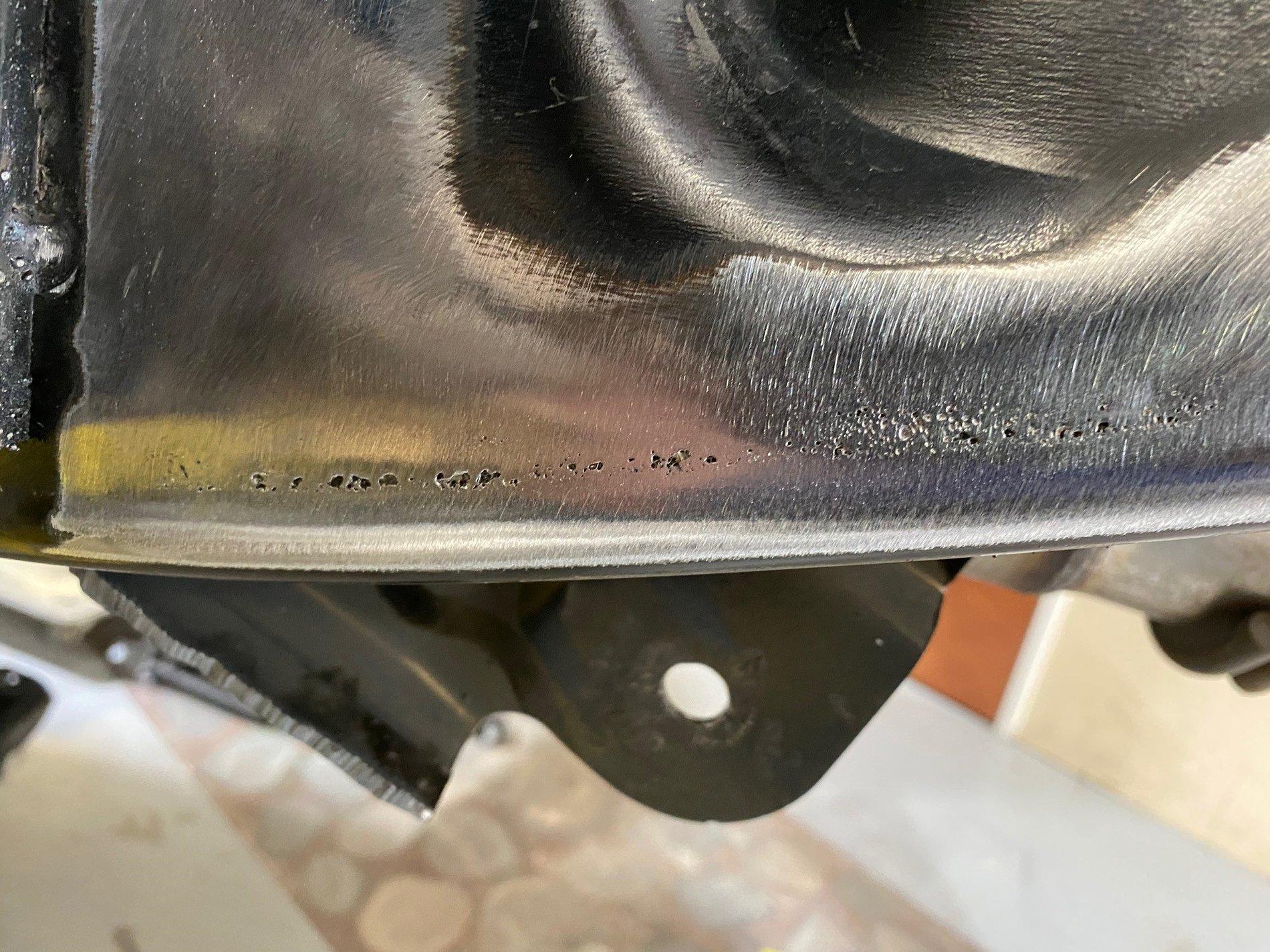

During the install of the lift kit, the bracket was removed and the frame behind the bracket looked like this:

It appears there was a bunch of weld porosity going on during the installation of the bracket. Possibly a gas issue when they were welding the bracket onto the frame. IMHO, there are some serious weld quality issues at FCA and/or their sub-contractor/suppliers.
For my own safety, I would rather pay the cost to fix the welds by a certified welder that I trust.
I would not have a dealership fix the weld issues unless I could see the weld certifications that their technician has.

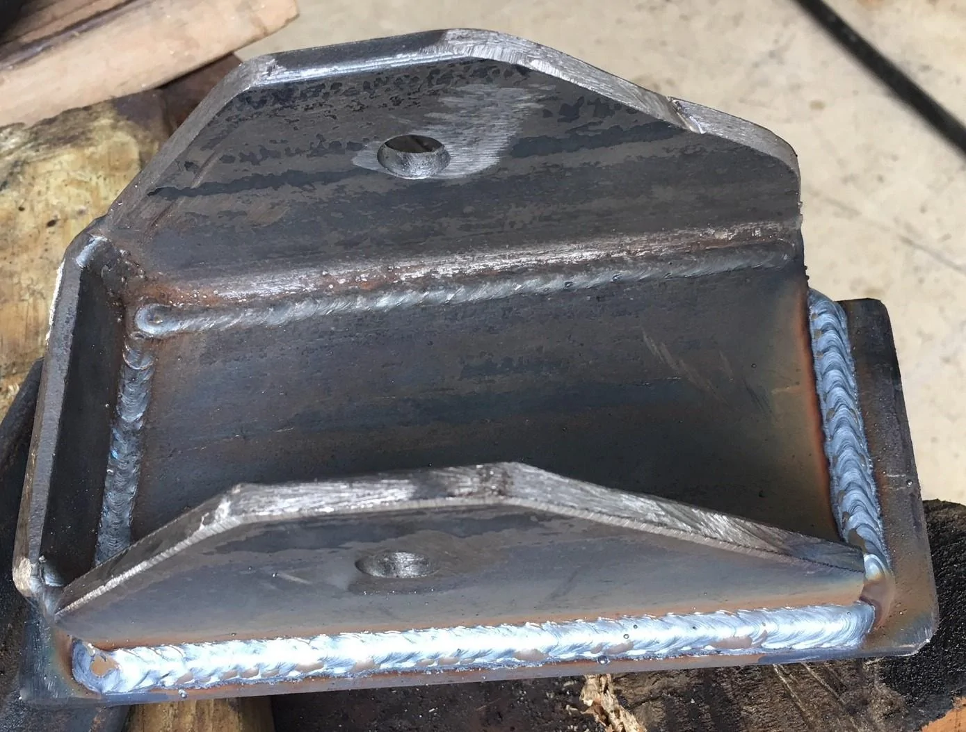

For reference, here is the welding a friend did for my CJ.
IMHO, these are the type of quality welds that should be seen on the JL.

That first pic looks like MY welds! :LOL:
Ok, how they looked the first time I tried welding. For a production line, that's horrible

Yeah, porosity seems to be a common issue dating back to the early JL weld issues. When I looked at some welds with porosity, members posted, it appeared to me to be a welder competency issue that caused them. The puddles looked like the MIG torch was drastically tilted, which can draw in air into the gas shield and cause porosity. Your bracket looks like it "...was stuck on with bat shit" as my high school welding instructor once said. There's no doubt, your OEM bracket weld was done by a person that didn't know the difference between welding and bat shit. But those new brackets you had done look great. Don't discount a good welder that isn't "certified". "Certified" can mean many things when it comes to welding. Whose certificate? What methods? What materials? What product uses? Most people welding for a living aren't certified by anyone, and yet many many things are properly welded, some exceptionally so.
