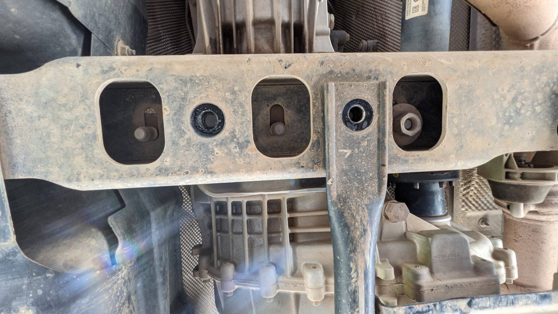

Was doing some work under the Jeep when I noticed 3 bolts coming out from under the transmission cross member. The nut on the right (driver) is loose, and the two on the left are completely missing. These bolts are clearly going to the transmission/transfer case mount, and I'm concerned that these are missing. Can anyone confirm? I have a two door, 3.6L, manual, if that makes any difference at all.
Edit* Don't mind the two missing BOLTS in the middle. I have an engine skid that I took off, which mounts there. That's when I noticed this. I'm curious about the missing NUTS.

Thanks guys, I had a feeling that would be the answer. Like I said, I have an engine skid plate that normally covers these bolts. I have no idea how long they've been gone, but I don't even see any clean spots on the threads where they used to be. I have had some work done to the transmission (clutch recalls and whatnot) I have to wonder if they just forgot to put them back on.

I have to believe it’s more likely they were left off after the dealer/recall work than they weren’t ever installed at all.

That's my guess

Likely didn't torque them right.

For the person reading this thread 3 years from now, the Mopar part number for the nuts is 6510210AA. These are M14 x 2.00 nuts. In a pinch you can find them at Home Depot, they didn't have any at AutoZone. I'm getting the Mopar ones, but the home Depot ones will work until then.
