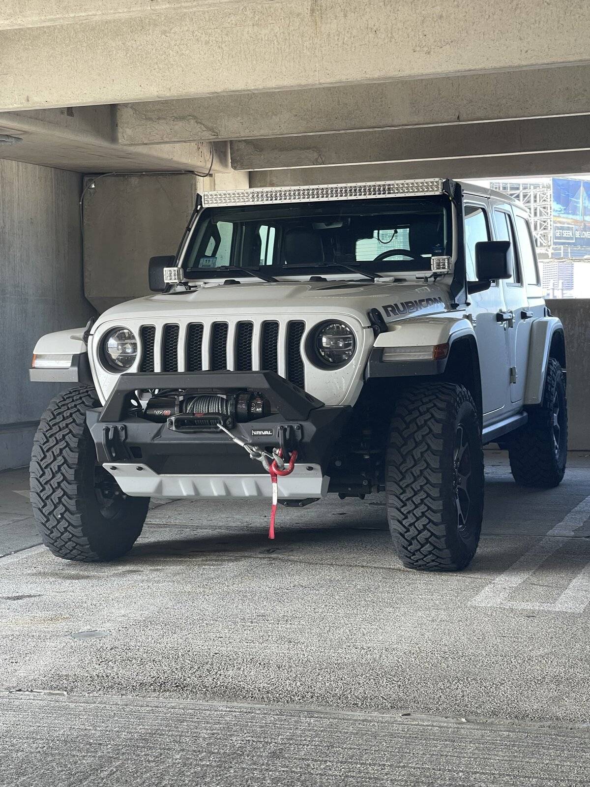

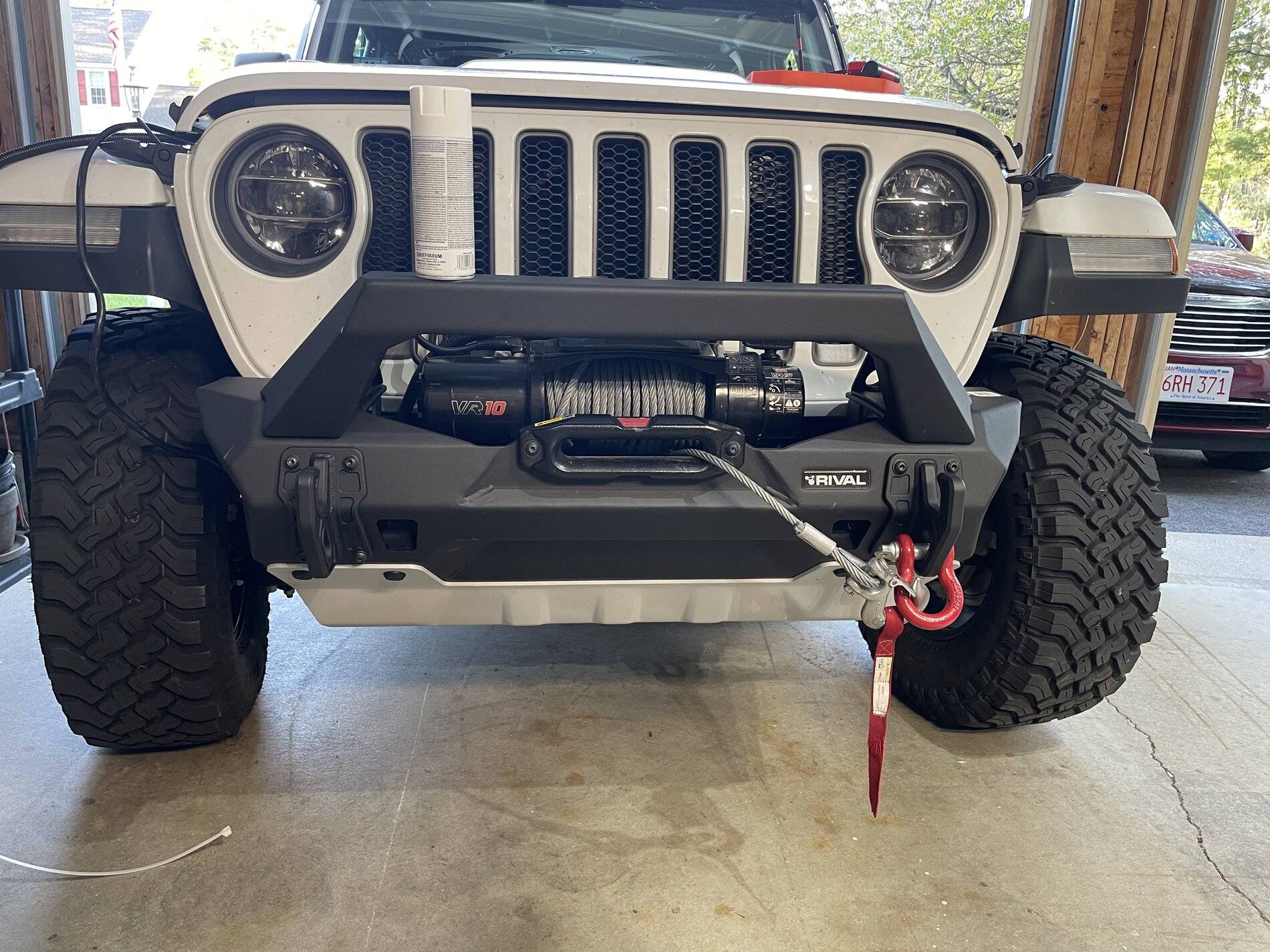

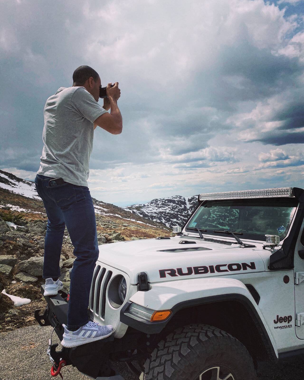

Rival front bumper. Definitely takes a while to build but satisfied with its mounting options. Wish they made a mid-width with light mounts on the ends. Hoop is strong enough to stand on and then some.

Very nice set up!

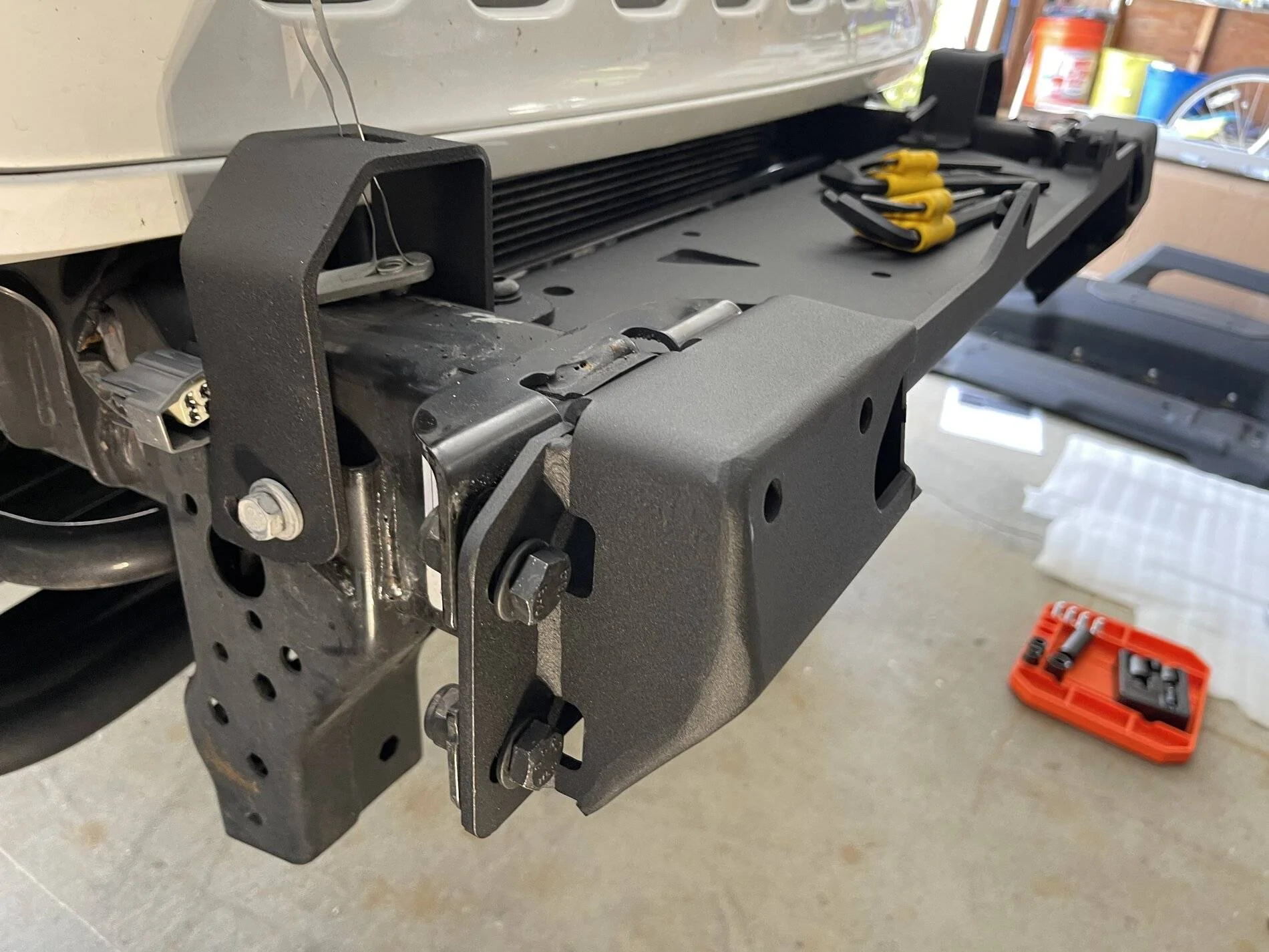

I actually scanned them for another user a little while back, so yes I do. But beware, they’re not the greatest...
That’s interesting, on extreme terrain’s website they say the ends can’t be removed like the steel Mopar version. Clearly they can be. Or did you mod it somehow?
The website is wrong. I asked the same question of their online support before I bought it. No modification necessary.

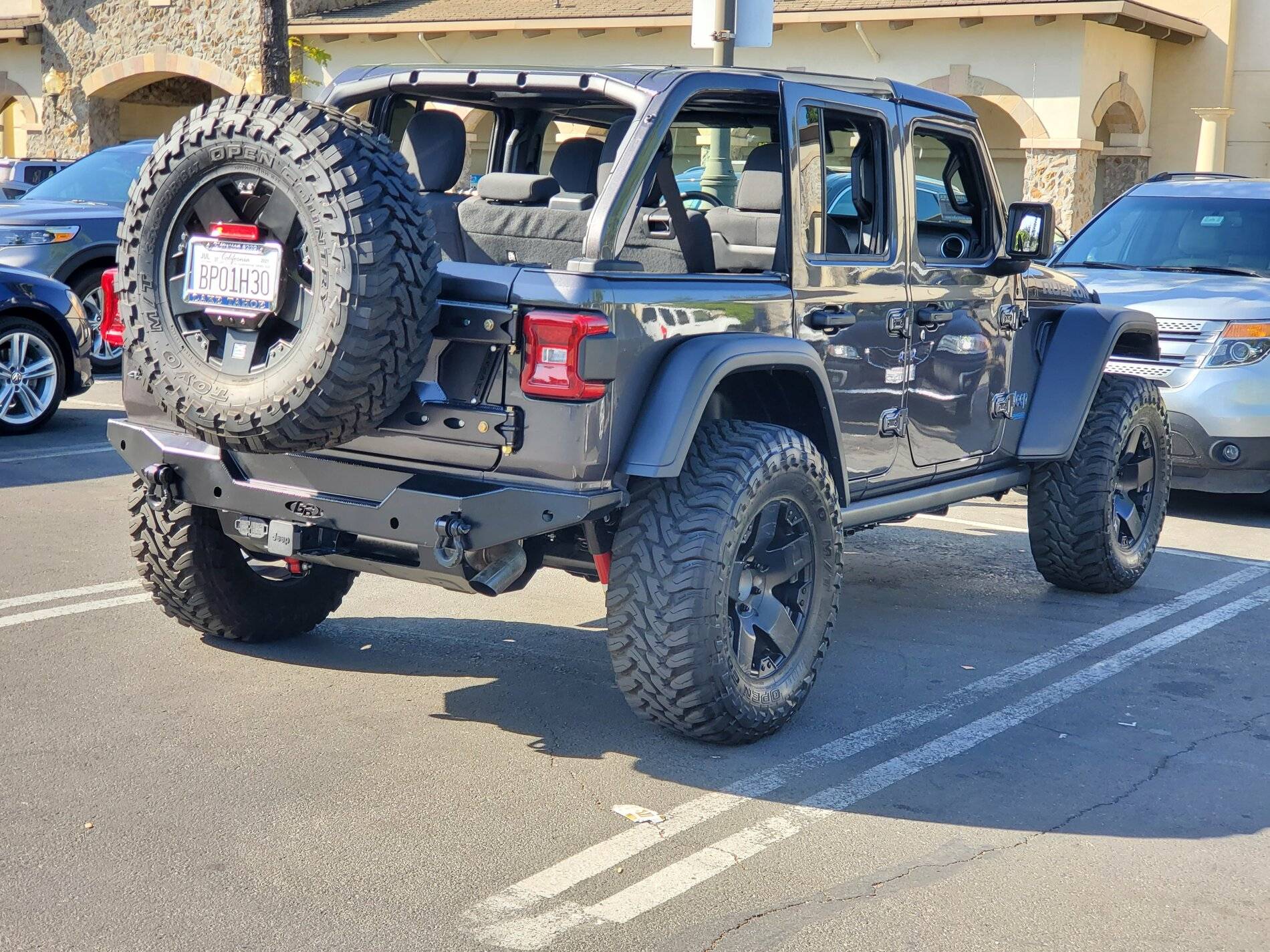

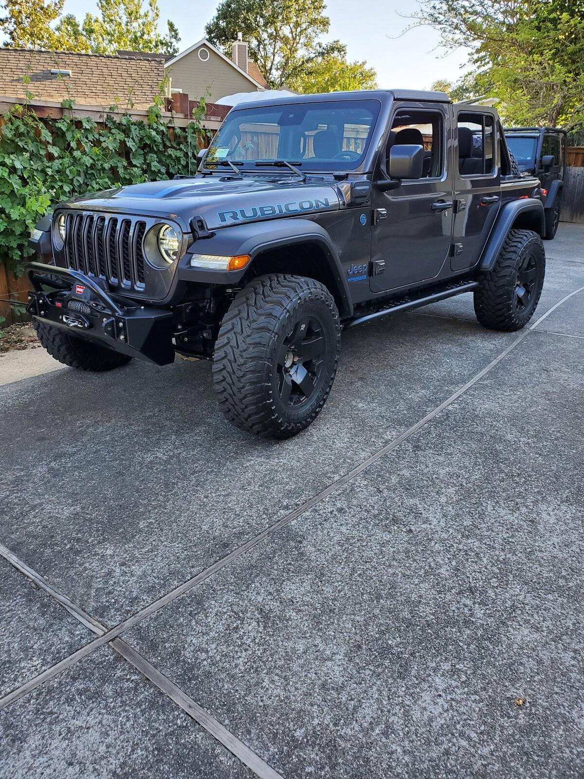

I also went Genright. I bought the metal skids but haven’t installed those yet, they require drilling holes in the bumpers to mount. I used self etching primer and painted the Aluminum black. I’ve had high scratch area items powder coated in the past and not been any happier w powder coat than paint.
The front bumper went on easily and without any grinding or drama. I went with the full version that protects the stock sway bar disconnect stuff. Winch fit just fine.
The back bumper was difficult and I’m not done yet as the bumper doesn’t come w the parts needed to mount the backup sensors and the optional rear support brackets were delayed, I just got them. I may have to grind the frame a bit if I want the bolts on top to line up.
The bumpers are light and beautiful. They fit tight, especially the rear. I would have liked a bit more installation detail given the cost, but every time I call Genright they pick up the phone and are very supportive.
Offtopic but I went with CavFab tire carrier over Genright because I don't want to double action opening the rear door, I hated that about my JK. The CavFab carrier is very heavy, negating a bit of the value of my Aluminum bumper but a very solidly built product.
Also slightly off topic but Genright did not recommend their Aluminum sliders if "you are going to wheel the thing offroad" because with the JL light body they are having problems. Genright recommended their JL/JK frame mount metal sliders, I went with LOD instead, possibly regret it as they sit lower than I would prefer.

Looking good! and thanks for the info! :rock:

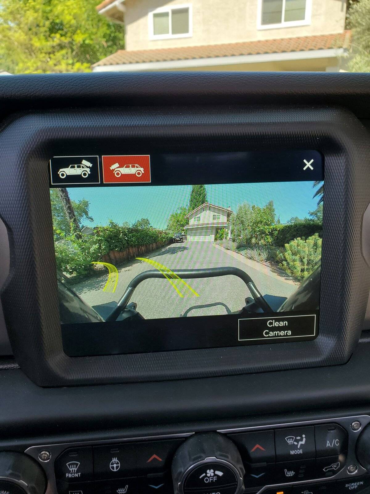

Looks like you have the factory front trail camera, does the bull bar get in the way of the picture any?
Hey there. The Bull bar is certainly in the photo, and a bit of the bumper too, but I think it's manageable.

That's not bad at all, I was picturing it a lot worse. Appreciate the photo!

Very cool. Jealous of the front camera!
By the way - is that a JK photobombing a forum about JL's!!??
