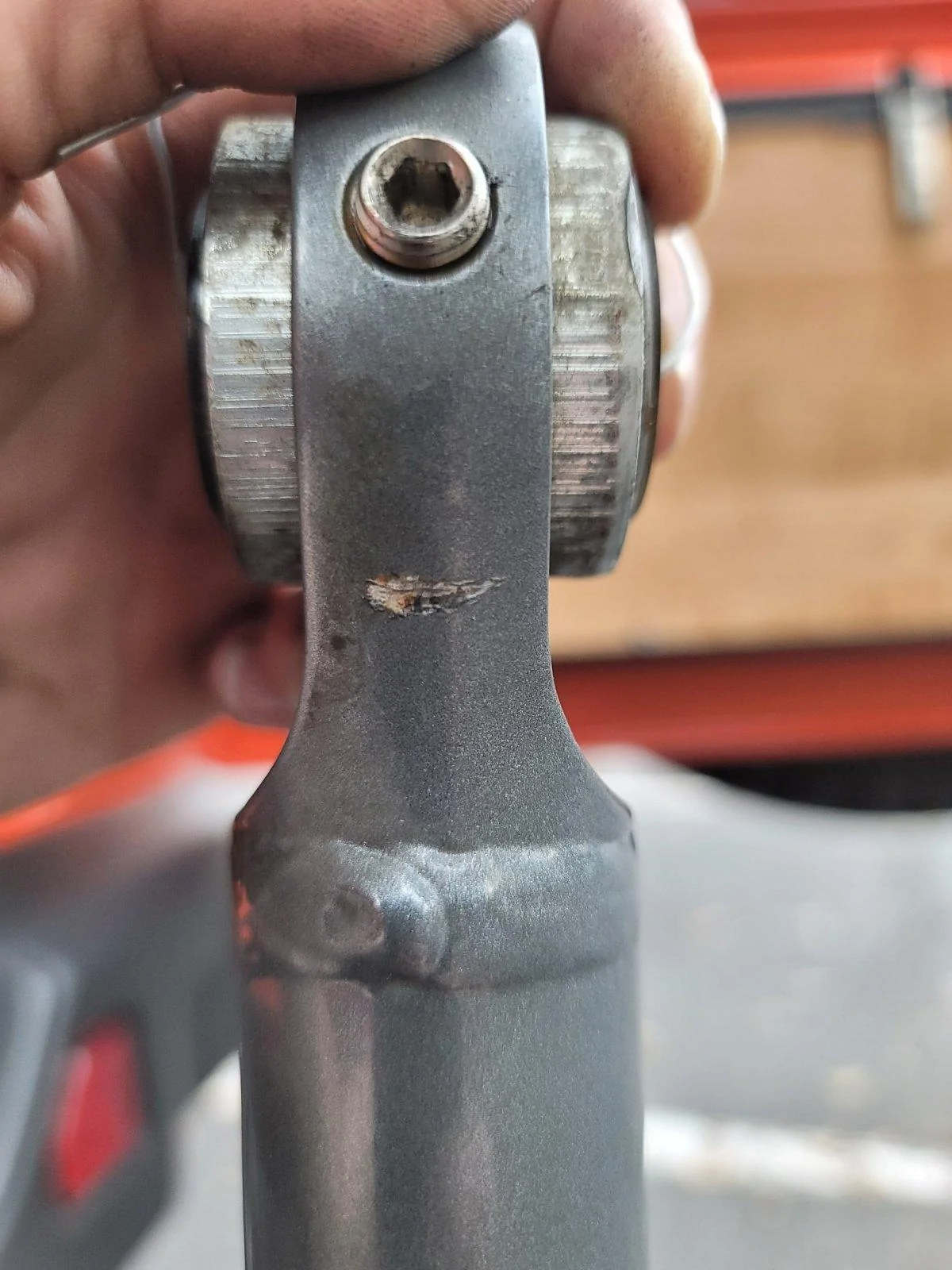

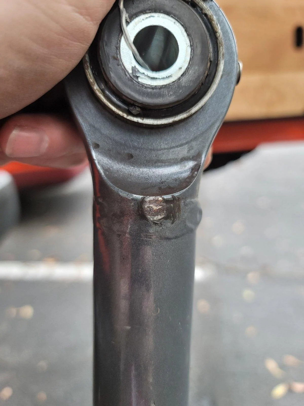

A quick update to anyone who finds this thread and another thank you from Jeep Chicken to @TeraFlex / @Wolfslash16 for reaching out.
So, the fix was two parts...
Part 1 involved a full round on the Front LCAs by backing out the bolts and tightening them to the specified torque. This time however I marked the point at which they hit torque (103ft lbs) on the bolt and then marked the appropriate angle on the frame to make sure I got it right when continuing to turn the additional 145deg.
That resulted in the squeak that the video shows going away. No longer could one jump on the front and reproduce the sound as my video showed. However, there was still a very high pitched squeak (low volume) while driving!
Two Squeaks!?... Jeep Chicken was not pleased!
Part 2 was quickly tracked down to the Synergy front Track Bar. The passenger side was rubbing metal on metal in two very small areas (images below).
From the outside while installed, everything looked to have plenty of clearance but that was not the case.
To Synergy's credit their instructions DO say some Jeeps may need to trim the axle mount and file the lower opening. I can only guess the reason why I didn't catch that I haven't done enough of this sooner is that the outer coating of the track bar was acting as a barrier until it became metal on metal.
So, in summary... check the torque 3 times! :) lol, but I can't fault the Teraflex product at all for having to retorque a few times. So thus far the Alpine IR LCAs have been a 10/10

Right on! You know you can loosen that locksrew on the track bar and push the bar over on the bushing, some people have gained enough clearance that way, I just filed mine down a bit. If you do push it over just locktite the lock screw and tighten it back down where it works. I know myself and i would have gorrila toqued that set screw until I stripped the allen head out, or stripped it out trying to loosen it, me and allen head or torx hardware dont get along well.
