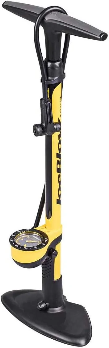

The Viair is a good affordable option. If you want to keep it simple, though, you can always go with one of these:
Jeep Wrangler JL Airing tires down 51Tiu5XQeiL._AC_SL1352_
Just make sure to eat your Wheaties... :)
And you have a day or two to air up. LOL.

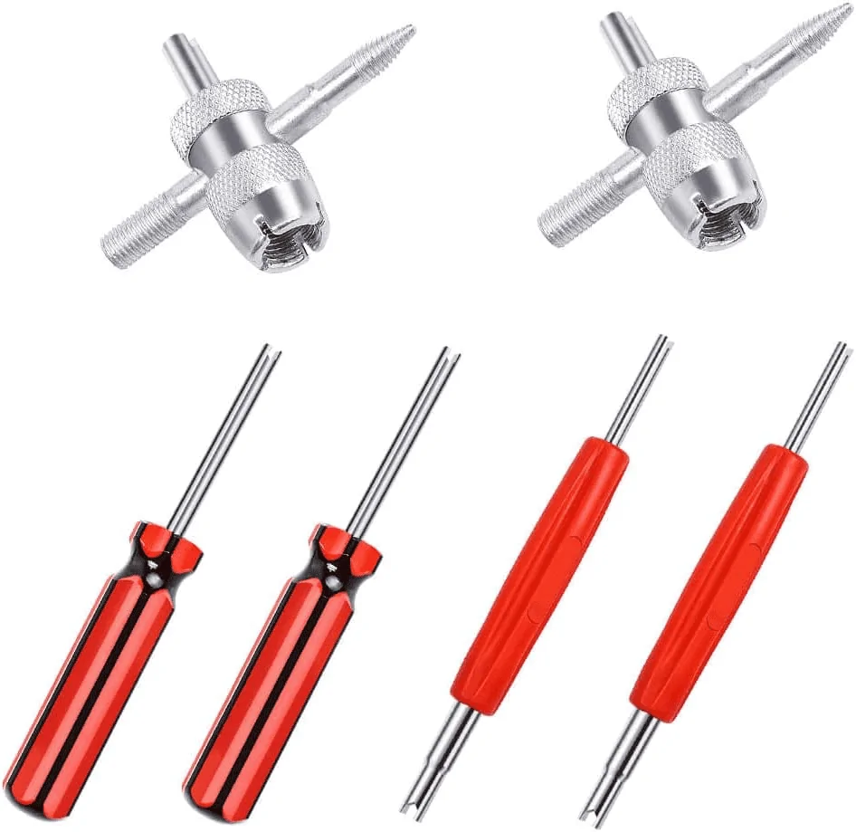

Okay, many option here. The cheapest fast way it this. You can buy these just about anywhere. They are cheap. Just make sure you have extra valve stem cores with you incase you lose one when you pull them out. Just know that if you lose the core, they are hard to find in the sand, mud, and snow or what ever you drop them in.
Amazon.com: Slime 20088 4-Way Valve Tool with 4 Valve Cores : Automotive https://www.amazon.com/Slime-20088-4-Way-Valve-Cores/dp/B0020T17J2/ref=sr_1_3?crid=WSUSLLI1366I&keywords=arb+valve+stem+core+tool&qid=1667215248&sprefix=arb+valve+stem+core+tool%2Caps%2C149&sr=8-3
Jeep Wrangler JL Airing tires down 1667215067511

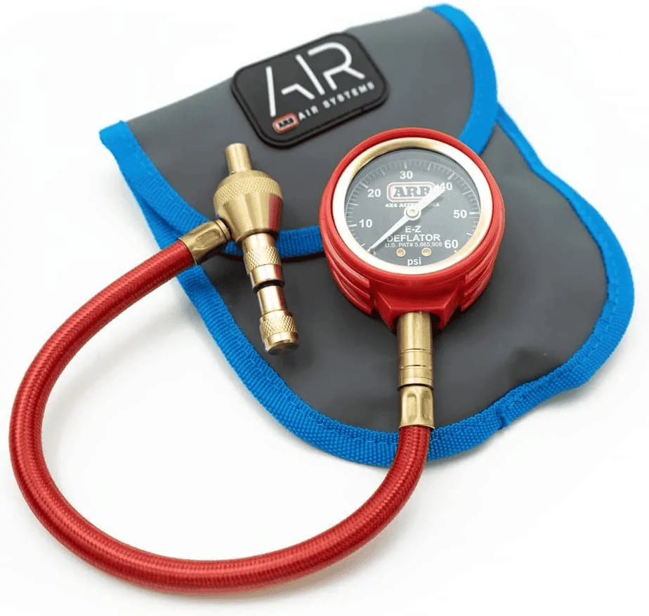

Is there a better way, yes.
I like a tool like this ARB tool. I have this and it works great. It will remove the valve stem core and capture it so it can not be lost. Then you can also check the pressure of the tire as you deflate the tire. Easy to use and they don't take up a bunch of space. There are several companies that make basically the same tool and they all pretty much operate all the same.

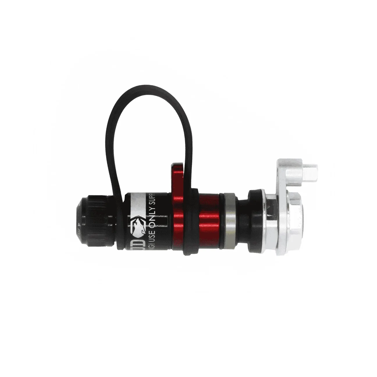

Probably the fastest way an the most expensive way is the Apex Design valve stems. About $150 plus the cost to install them unless you mount your own tires. So this could easily be a $250 to $400+ install. I use the Apex Design valve stems. They will air down your 33 in tire to 15 pounds in about five or six seconds. It will air down my 37 in tires to 10 psi in about 11 seconds. and requires no tools. Very easy to drop to much air. Will need a air tire gauge to check the air as you air down. I simply timed mine and it gets me real close at 11 seconds.
Jeep Wrangler JL Airing tires down 1667215701483

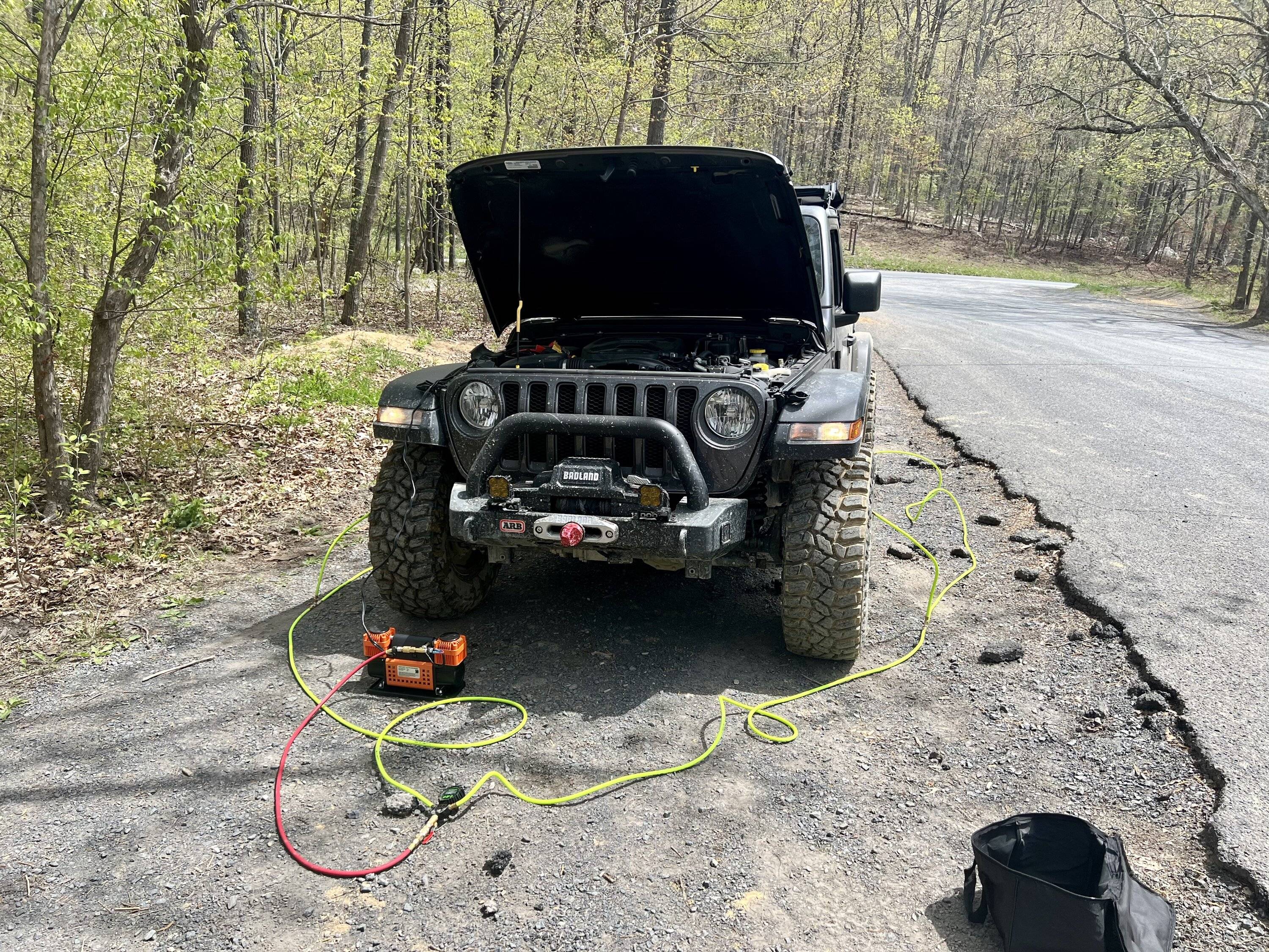

Airing up is easy get a portable air compressor. Just know the more you spend, the faster it will be....usually. If you buy a $30 or $40 dollar one from Home Depot or Lowes, expect to spend 45 minutes to air back up. If you want to cut that time down to 15 to 29 minutes buy one that is $150. Usually the ones that air up faster will use clamps directly to the battery as the 12v ones that plug into a cigarette type outlet will not pull enough juice to be fast.
I used a Viar compressor before I went to onboard air. The only reason I went to onboard air was because storage space is limited and I did not want the air compressor taking up storage space in the jeep.
