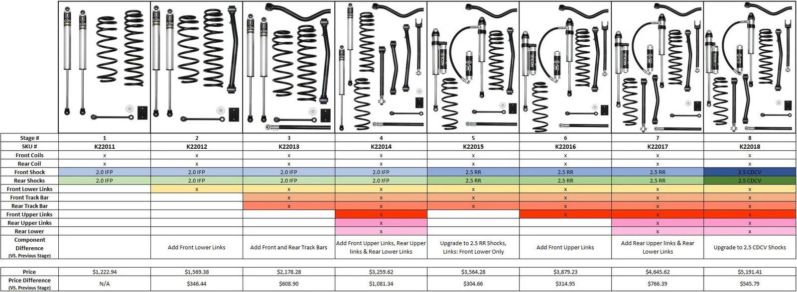

Icon Vehicle Dynamics - Stage 1 - Stage 8
http://iconvehicledynamics.com/shop/725-5-suspension-systems
Jeep Wrangler JL Aftermarket JL Lift Kit suspension options master list JL Stages.JPG

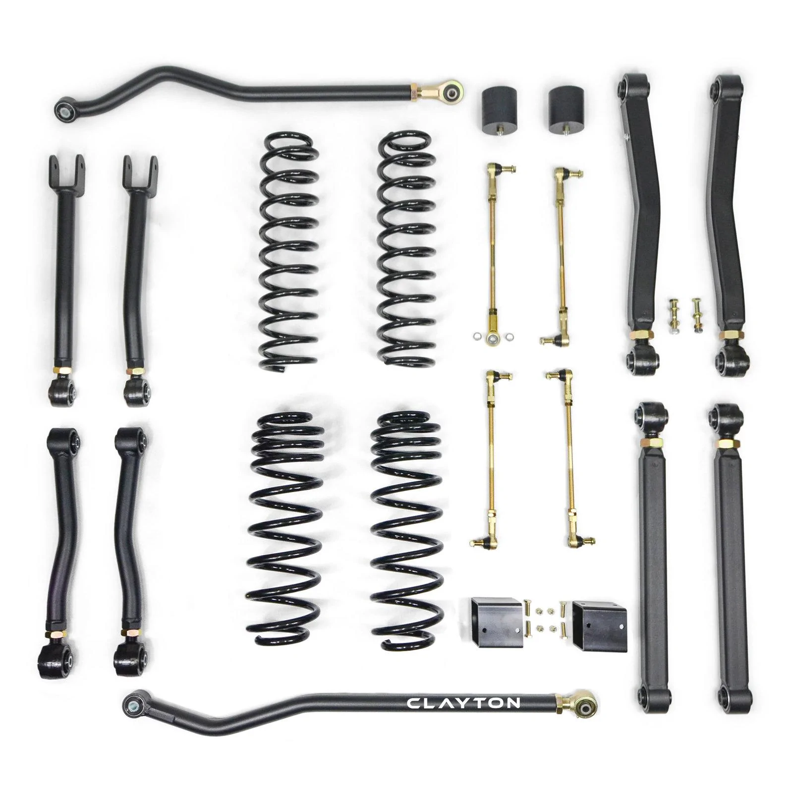

Clayton Off Road 2.5" Overland Plus Lift Kit
https://www.claytonoffroad.com/product/jeep-wrangler-25-overland-lift-kit-2018-jl
Jeep Wrangler JL Aftermarket JL Lift Kit suspension options master list Clayton JLWF Picture 2

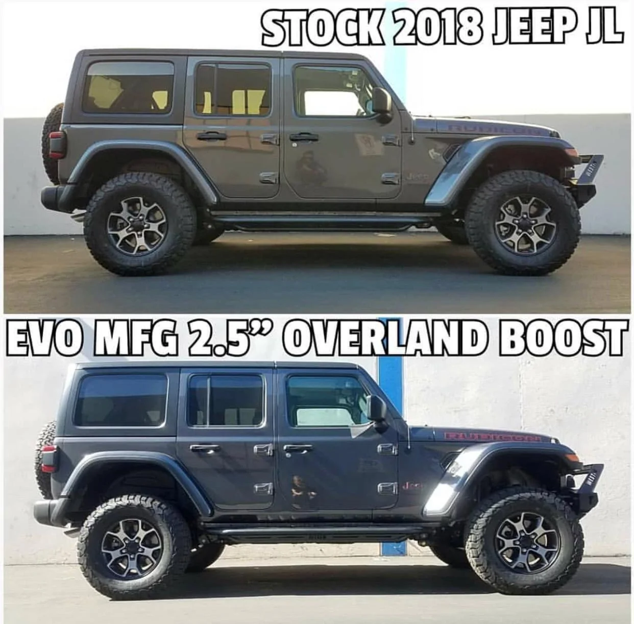

Can someone explain why the EVO budget boost is nearly triple the price of the rough country? What is better about the EVO?
FCrackerJLRubi
FCrackerJLRubi
Dec 8, 2017
753
1,036
Chesapeake, VA
2020 Gladiator Rubicon, 2018 JLUR
No telling really....if I was going to get a budget I would just go with Rough Country anyways, if your going cheap might as well go all the way cheap. (thats not a hit on quality btw....just stating budgets are suppose to be cheap options with no real performance gains vs cost...more of the I want the look kind of idea)
The only immediate difference I see is the RC comes with shock relocation brackets but no extended discos, where the EVO comes with extended discos but no shock relocation brackets..
