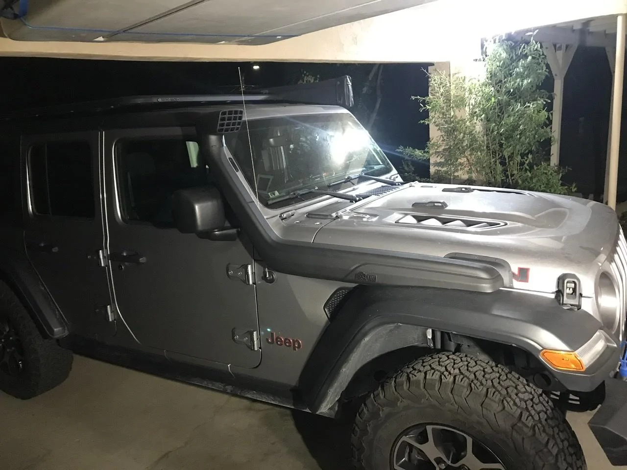

Just received and installed my AEV Snokel.
fit and finish is really good, let me know if you have any questions.

I got mine sitting in the garage, how hard was it to get the cut in the hood right. It's my main concern.

Was not too bad, took me at least an hour. The hard part is the inside structure.
a die grinder would be the best to use, start small and expand it out to fit the plastic piece perfectly. My hole was not pretty but it is all covered by the trim piece.
‘’make sure you have a 3 inch hole saw too.

Nice! Anymore pics? Are you using the standard mounting bracket or the optional a-piller bracket?

Nice! I'd love to see a pic from straight on from the front.

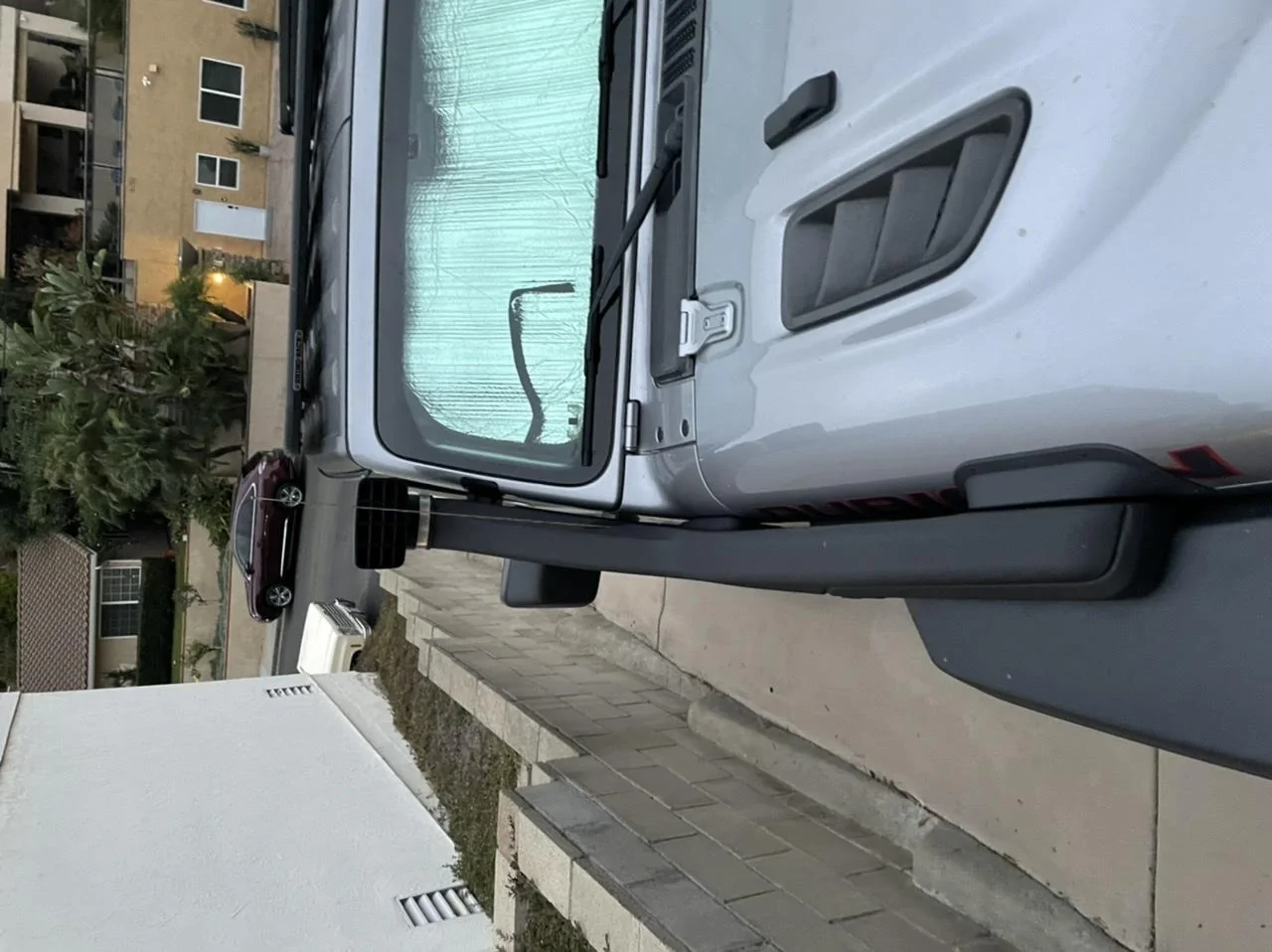

Here you go
Looks like you could still fold the windshield, depending on the way it attaches to the A-pillar. Thanks!
Looks great, btw. A huge advantage over the Mopar is that this allows for swapping on a pre-filter or separator device.

Cannot fold down windshield, to do that you need an optional bracket that is $50 and is not as strong. Have the pre filter just have not installed yet.
