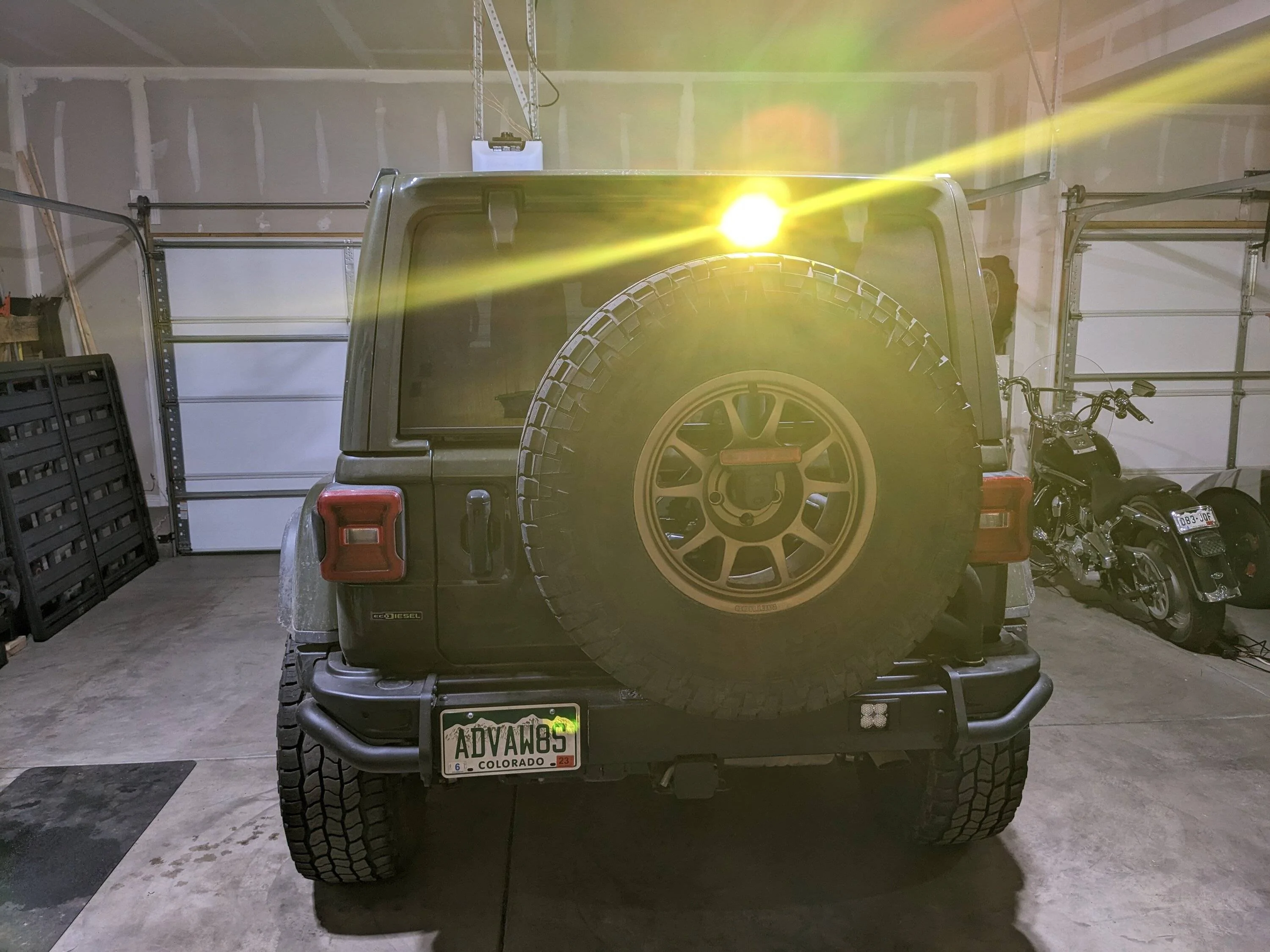

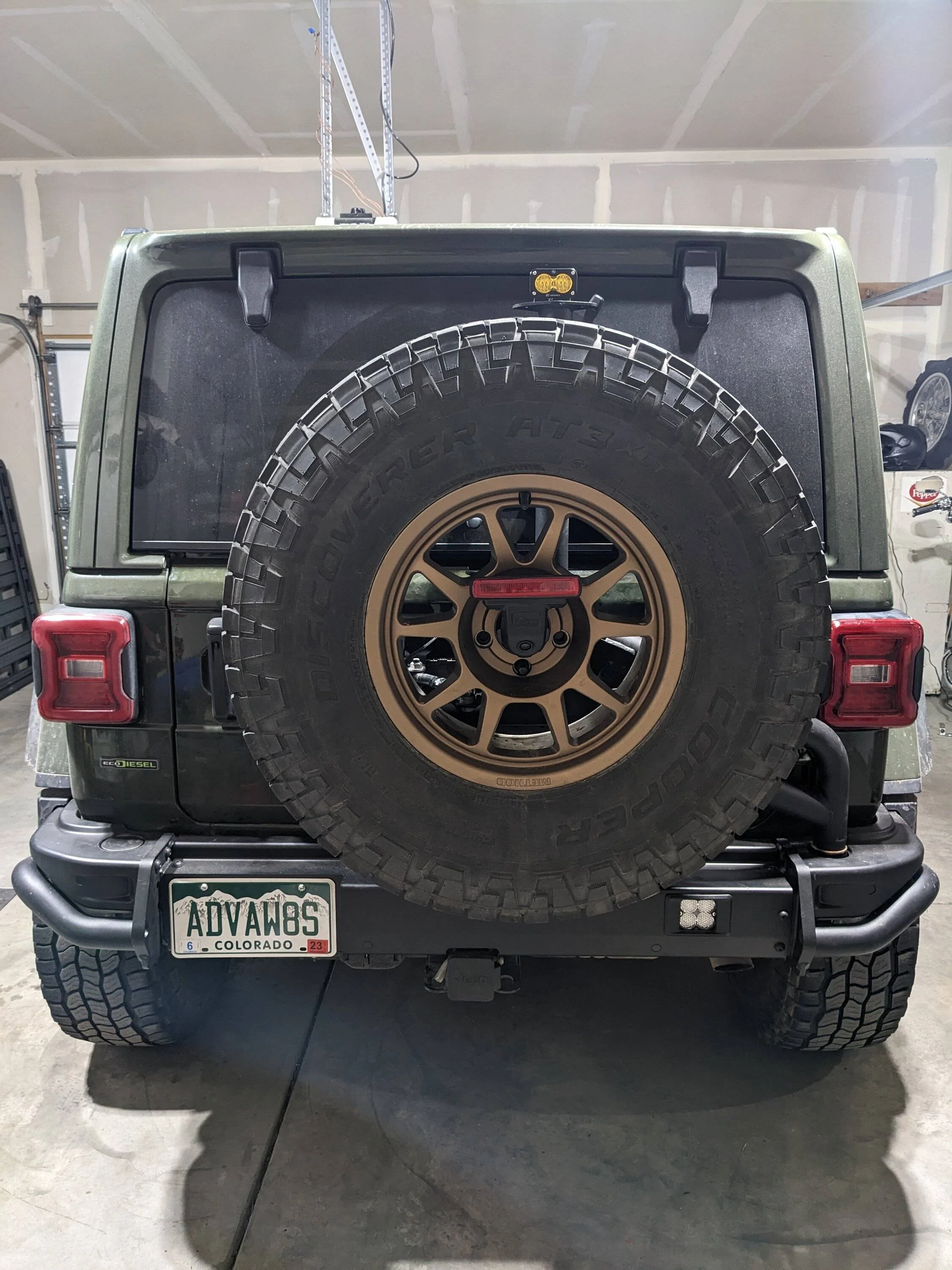

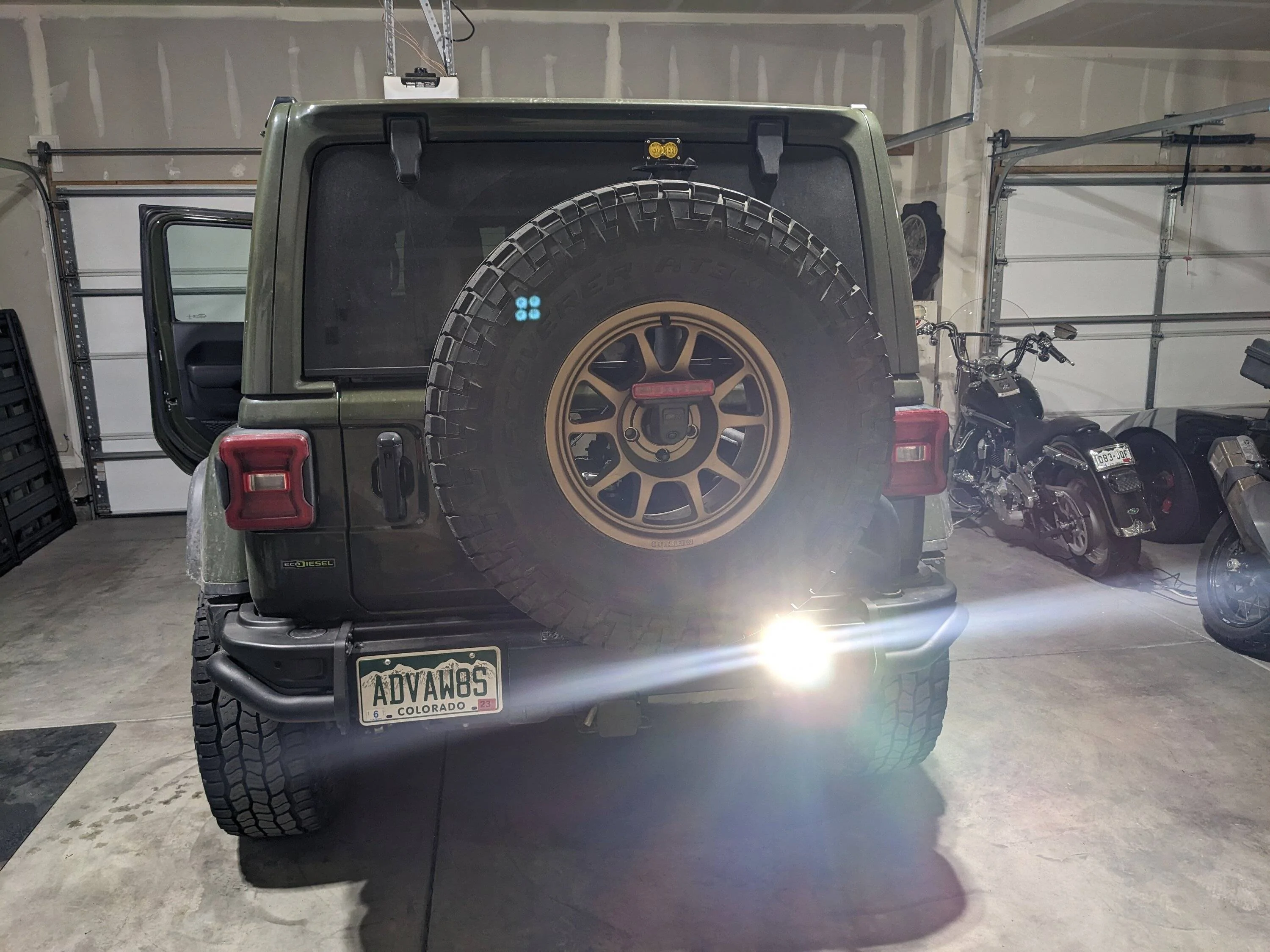

Nope, not bad at all. I installed it when I installed my bumper. Wired it in to one of my aux switches. I also installed a Baja Designs amber s2 on top of the tire carrier for a chase/bad weather light..

It comes with a pigtail off the back of the light with a weather pack type plug and it comes with the pieces to assemble the other side of the plug on your own wiring. No relay needed, just wire to the appropriate aux switch.

The AEV rear bumper has a pedestal that comes up behind the spare tire. It's already set up to mount a light, antenna, etc there.
