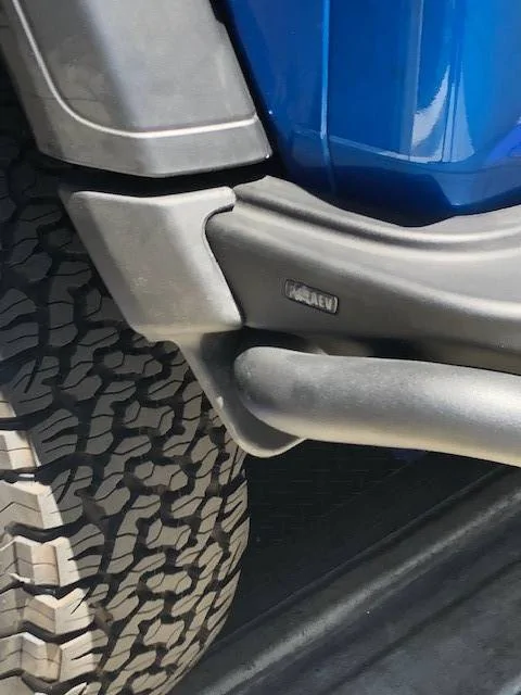

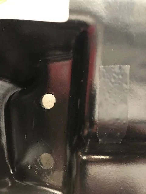

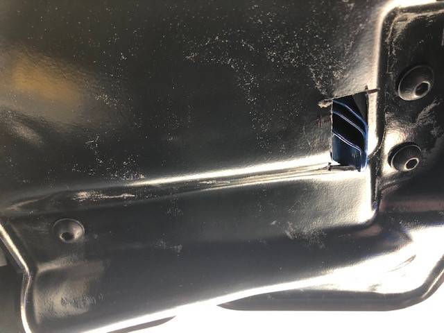

I wasn't about to cut sheet metal to install the Fender Extensions - So I just made a clearance slot for the body panel, slid the Fender Extension liner inside the existing fender liner and it fit like a glove - there is absolutely no reason to jack up your body panel or fender liners - used a piece of electrical tape for pattern - worked out great -
