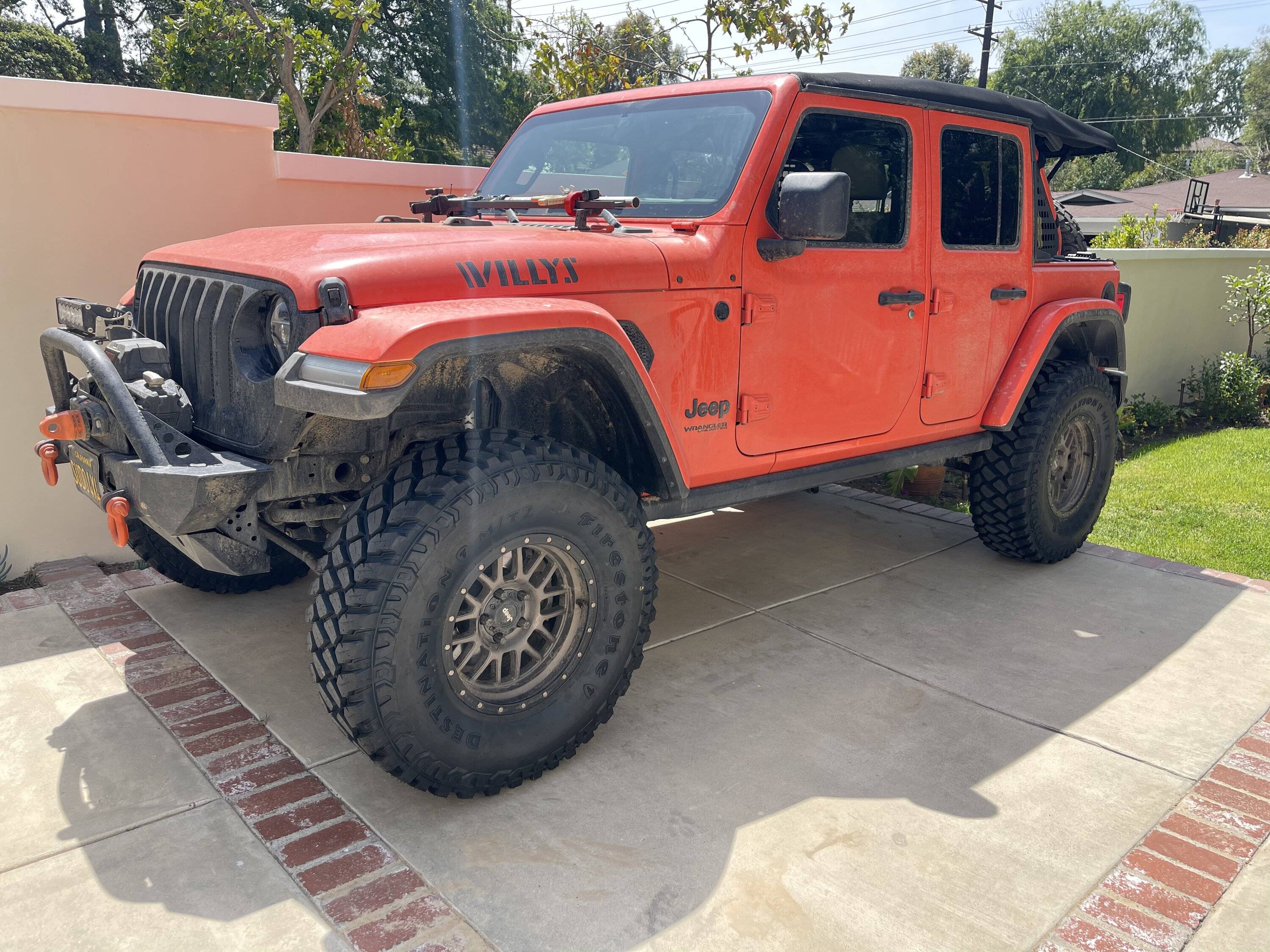

They’re pretty tall. I actually just removed them today (going back to stock), so let me see if I can’t put them side by side or get a centerline measurement.You did a great job on paint/install! Looks good.
May I ask, you or any of the others that did the Rubi fender swap, did you do a before and after measurement? I’m curious how much higher the Rubicon fenders actually are.
Iv’e seen different claims of 2 to 2 1/2” but that doesn’t seem right to me. I was thinking 1 1/2 or so??

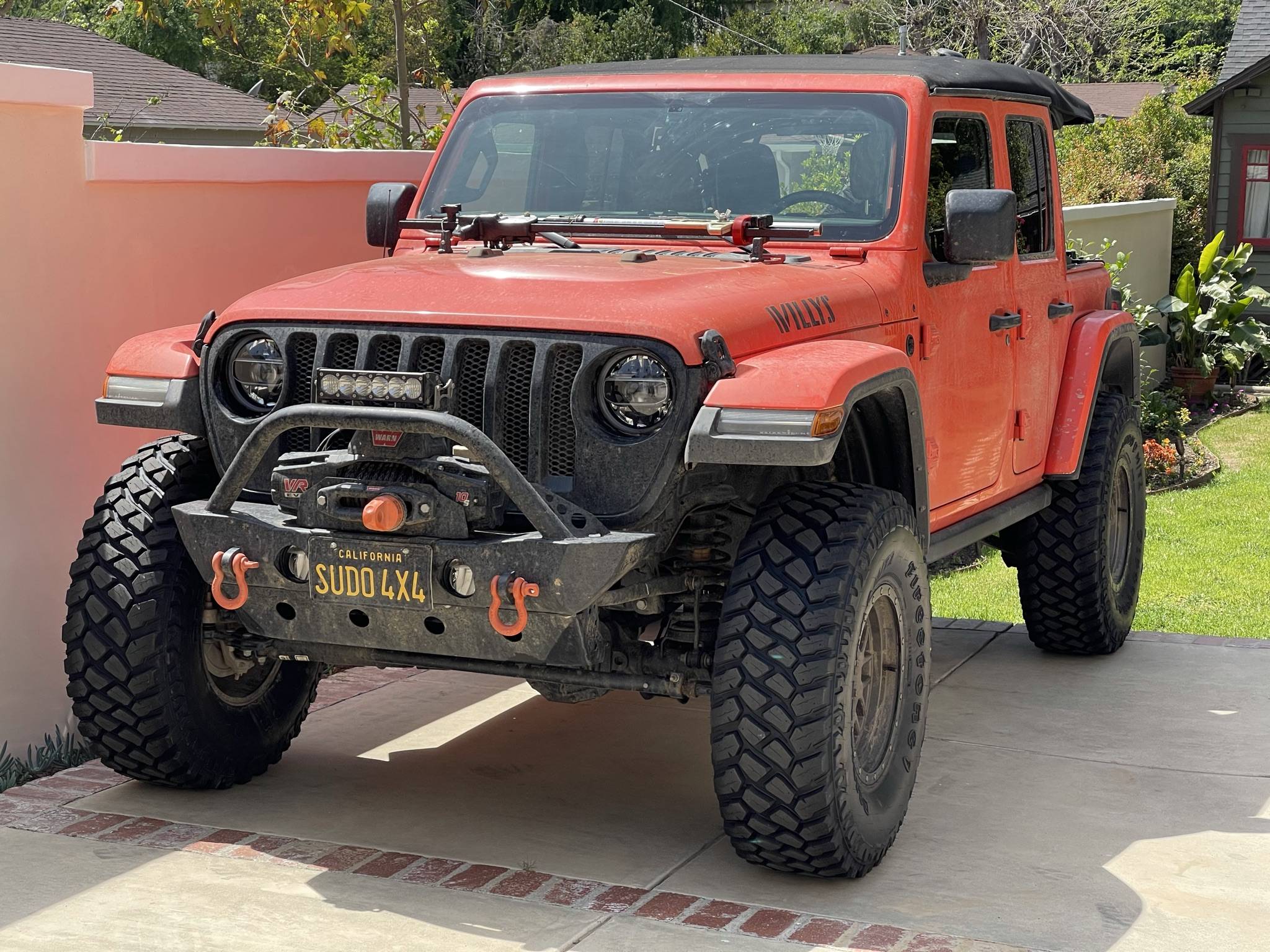

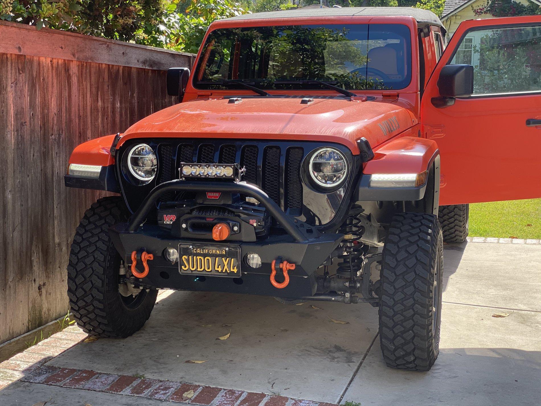

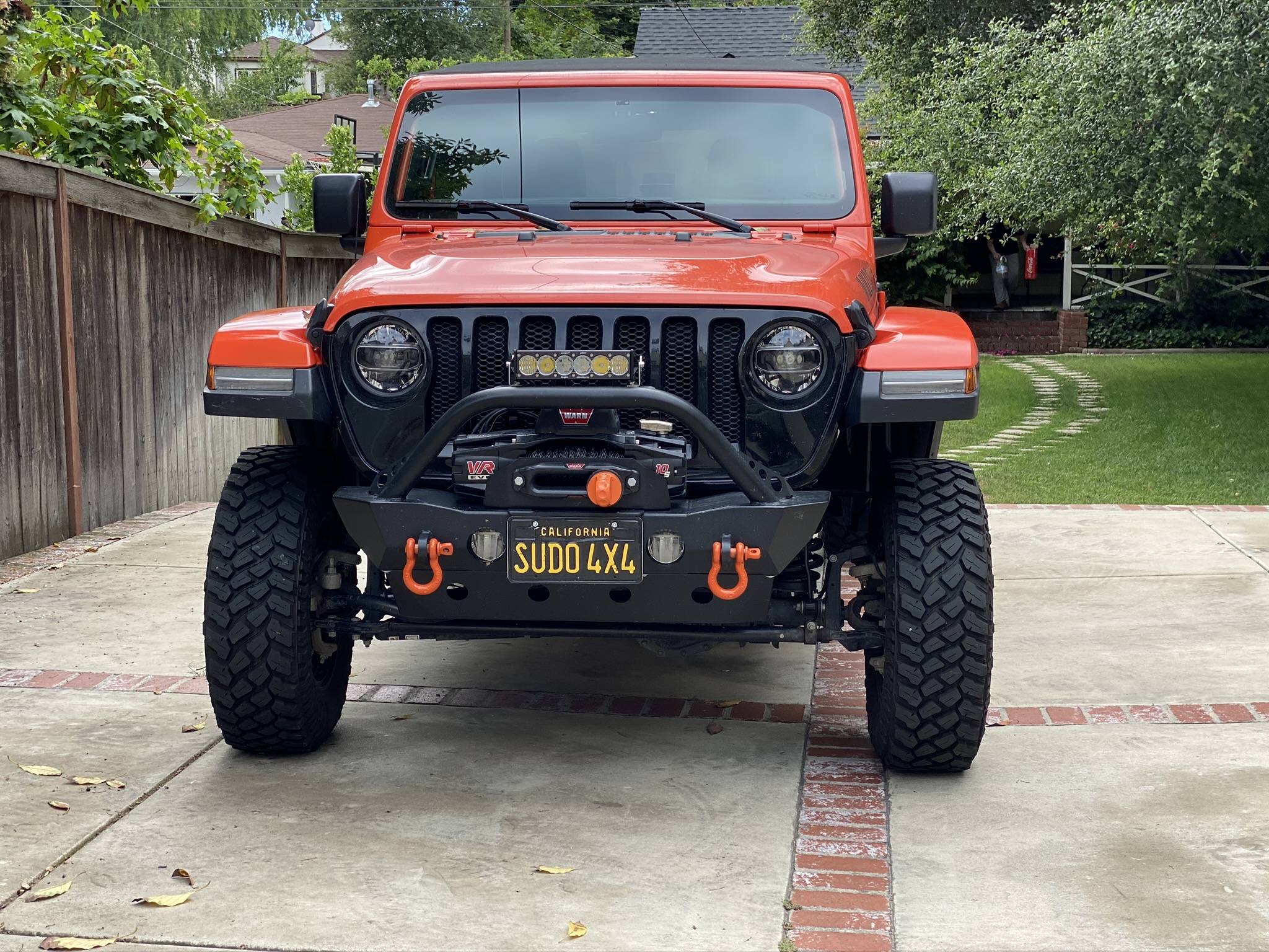

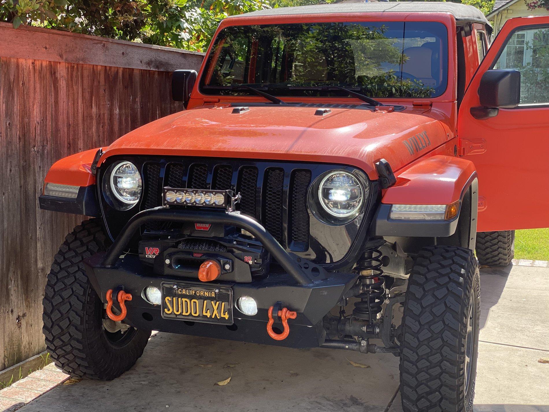

Actually, while we wait for me to do a measurement - here’s a good compare photo. Same lift (mopar) same wheels (stock willys) and close enough to the same angle. You can see the gap above the wheel is pretty big, and goofy looking. They’re also about two inches wider too, wide enough that they stick out further than stock wheels and I needed spacers to not look dumb until I got my aftermarket wheels. The 1st rubicon fender pic here is with those spacers, the second is withoutYou did a great job on paint/install! Looks good.
Covered in other threads better, but I think the most modern approach is to buy the ECRI bypass module (Amazon), a OBD reader recommended by JSCAN (see their site, buy on Amazon), and a Z-Automotive SGW extension cable (go on their site). That was the combo I used.May i know what kind of OBD did you use with the JSCAN? Because as i know all JL will need a security gateway bypass cable to even have a chance of making changes in a JL.
Unfortunately I didn't do any specific measurements. The best comparison pictures I have from the front and side are in this post. The only thing I changed was the fenders, everything else was the same:You did a great job on paint/install! Looks good.
