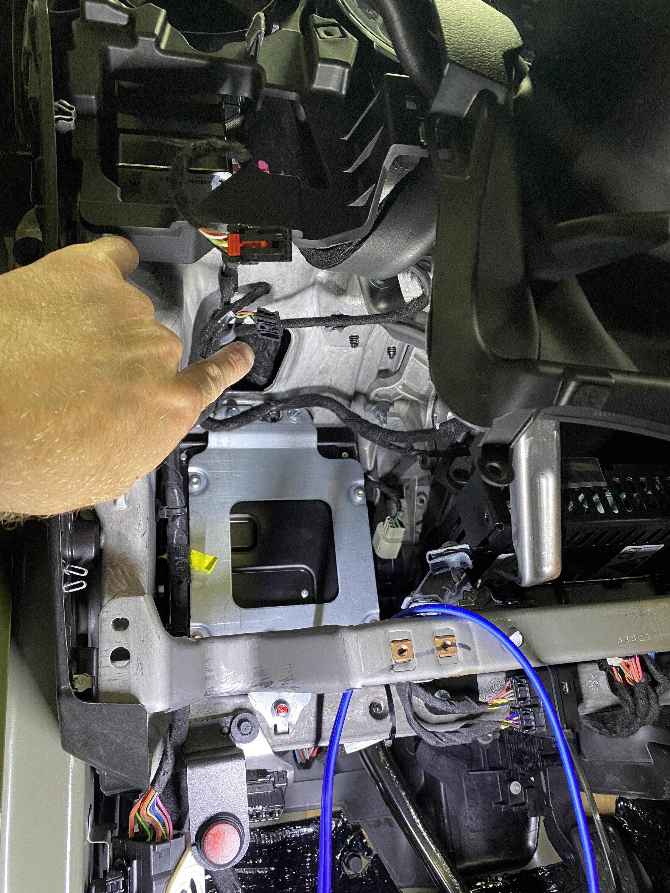

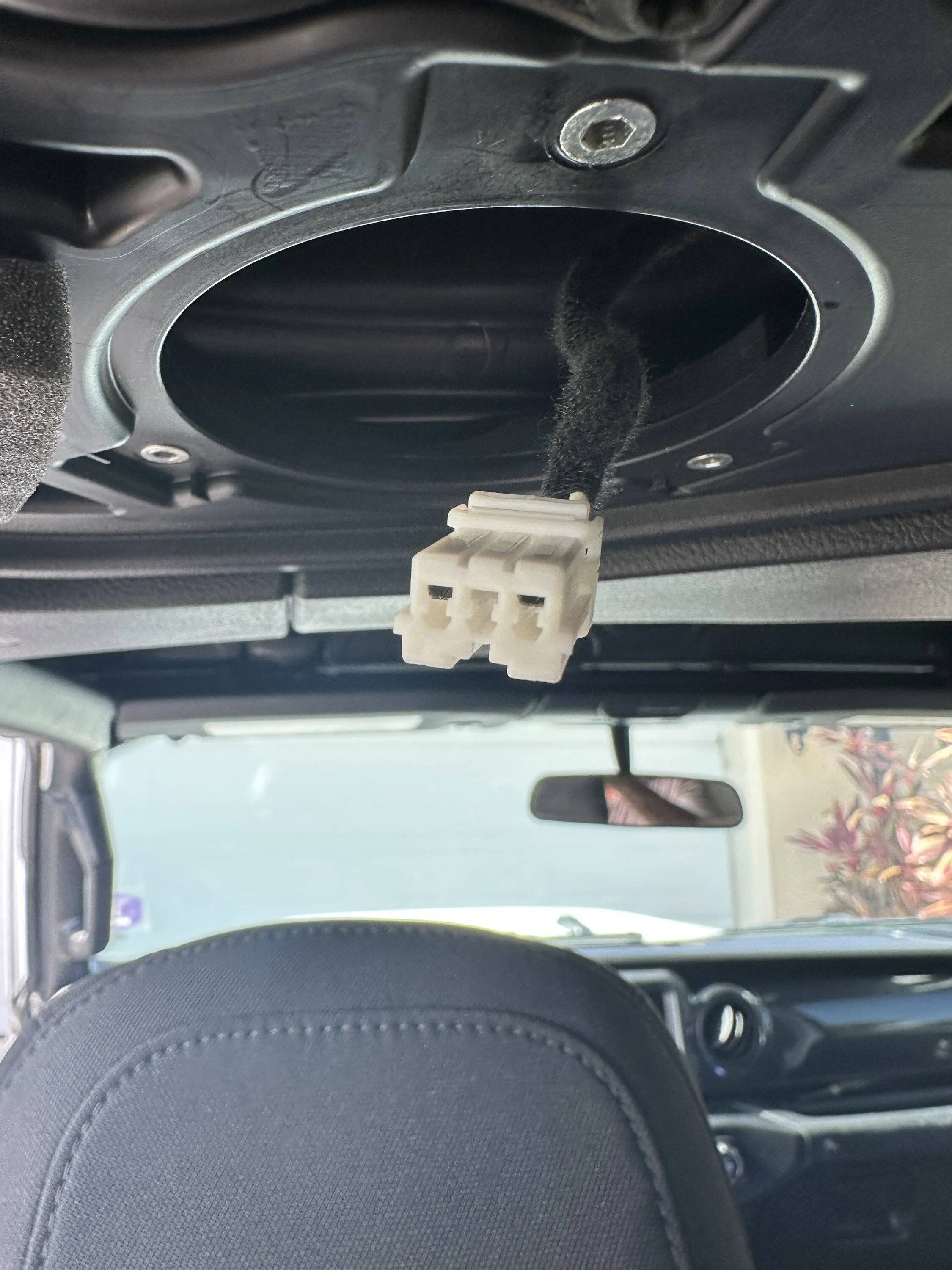

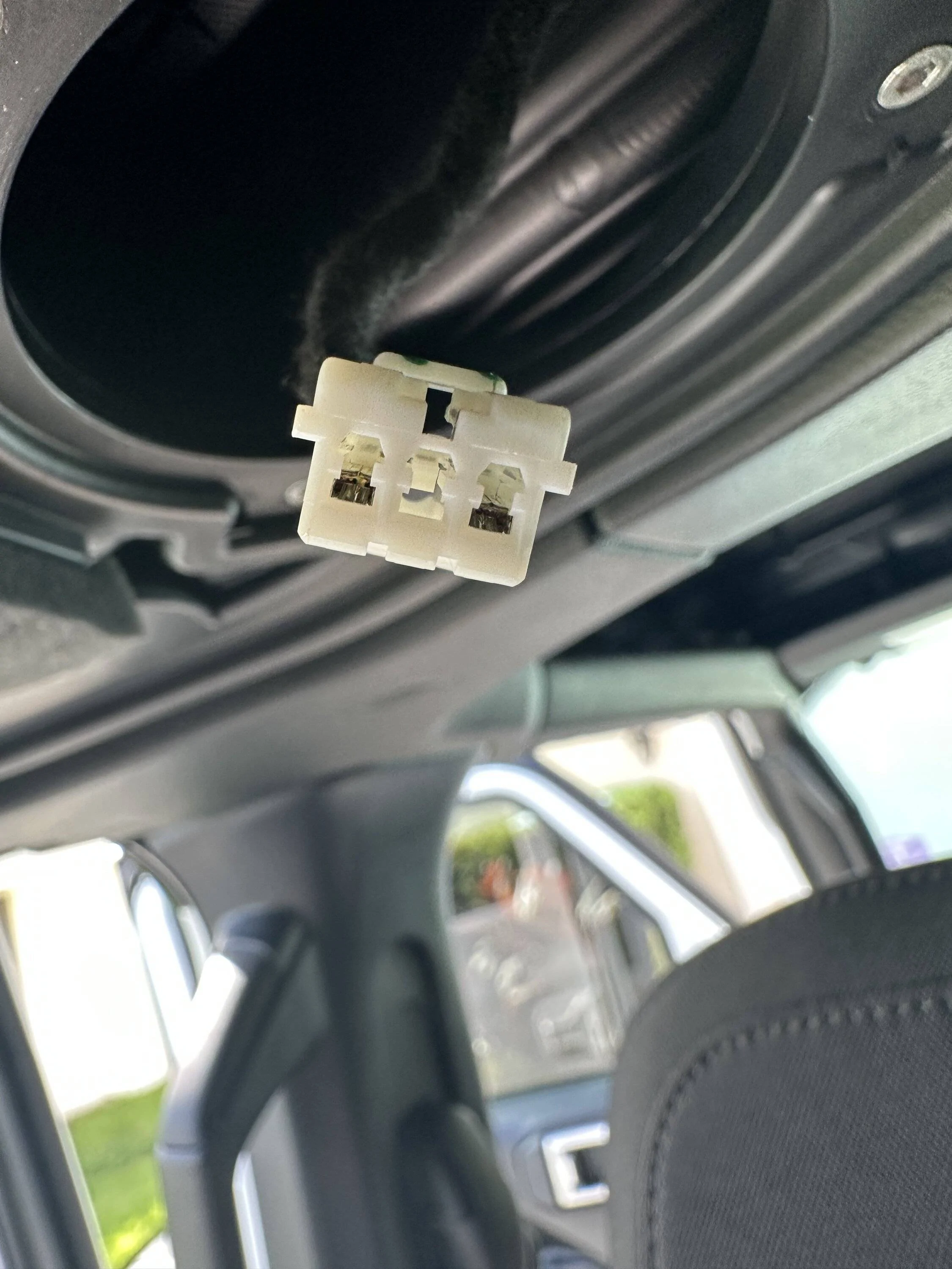

If I remember correctly, there is something that's plugged in to the back of the enclosure, an extra module, not the speaker wiring itself.Can anyone tell me what plugs into this? It’s directly above the drivers side lower dash speaker. I can’t remember if I unhooked something or if this was already hanging there.

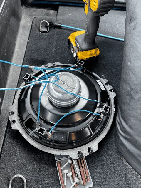

Better yet. This is what it looked like. Wire the two adjacent terminals on opposite sides and then take the opposite terminals and wire them to two leads out. The right side of each of those plugs is positive.
Thanks I was hoping since I have the wiring harness from the subwoofer that there would be some type of adapter that would turn the wire from the sub into a connection I could just plug into an amp. But this looks easy enough to follow.You will need a line out converter. I am familiar with the PAC AmpPro but I am sure that there will be less expensive alternatives. The two wires to the left are connected to to the amp.

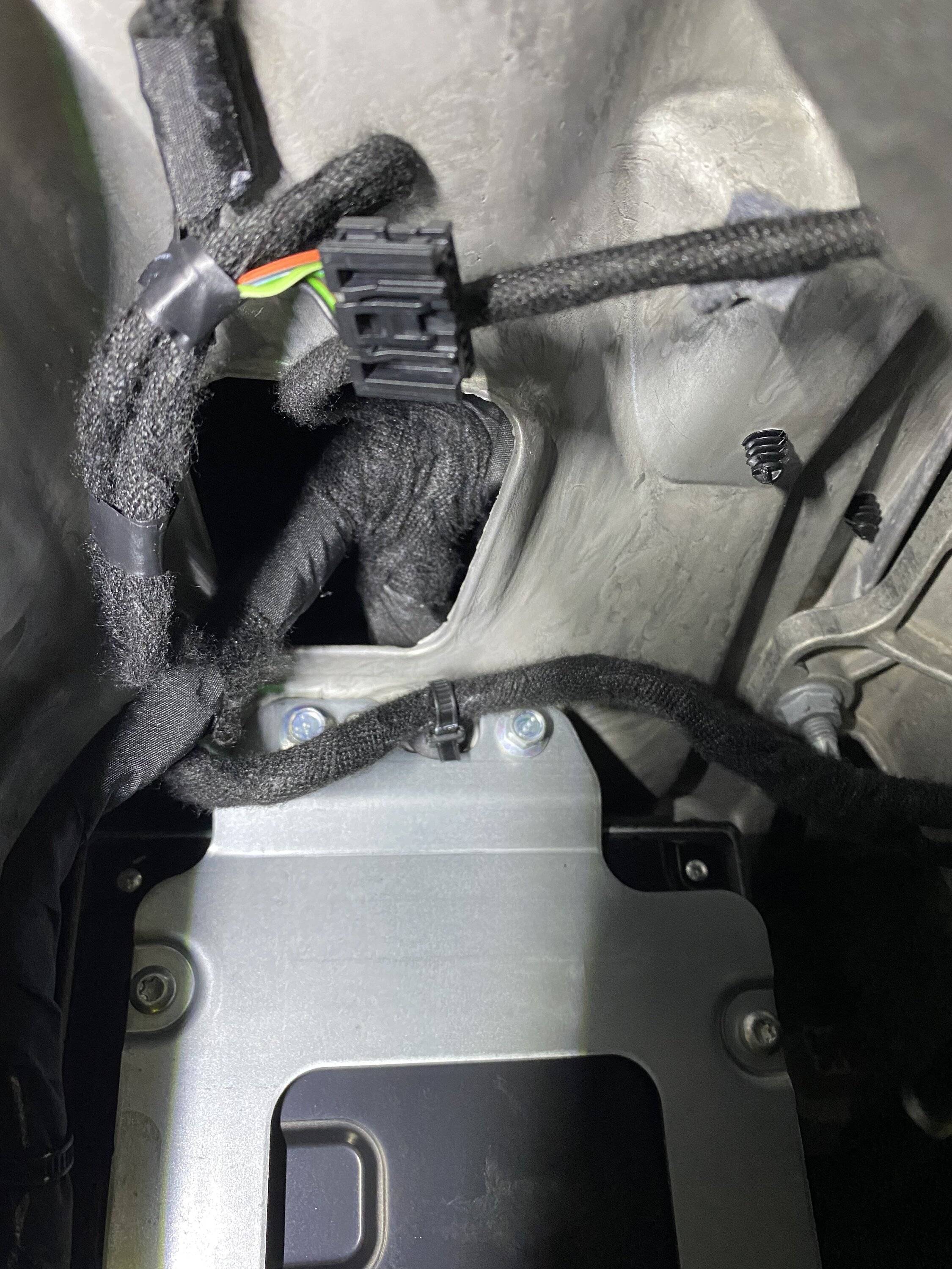

The factory amp is on the firewall behind the drivers side speaker pod. Unplug it and plug it into the CH4 cable. No need to pull the radio. I originally used the AmpPro that came with the Quart Stage 6 and I wanted more control than you can get with the AmpPro. From there you can o with the Quart kit or the JL Audio 5 channel amps. JL Audio also builds JL specific amp racks.
