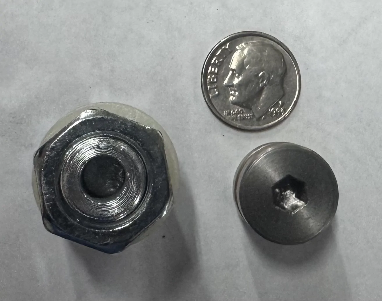

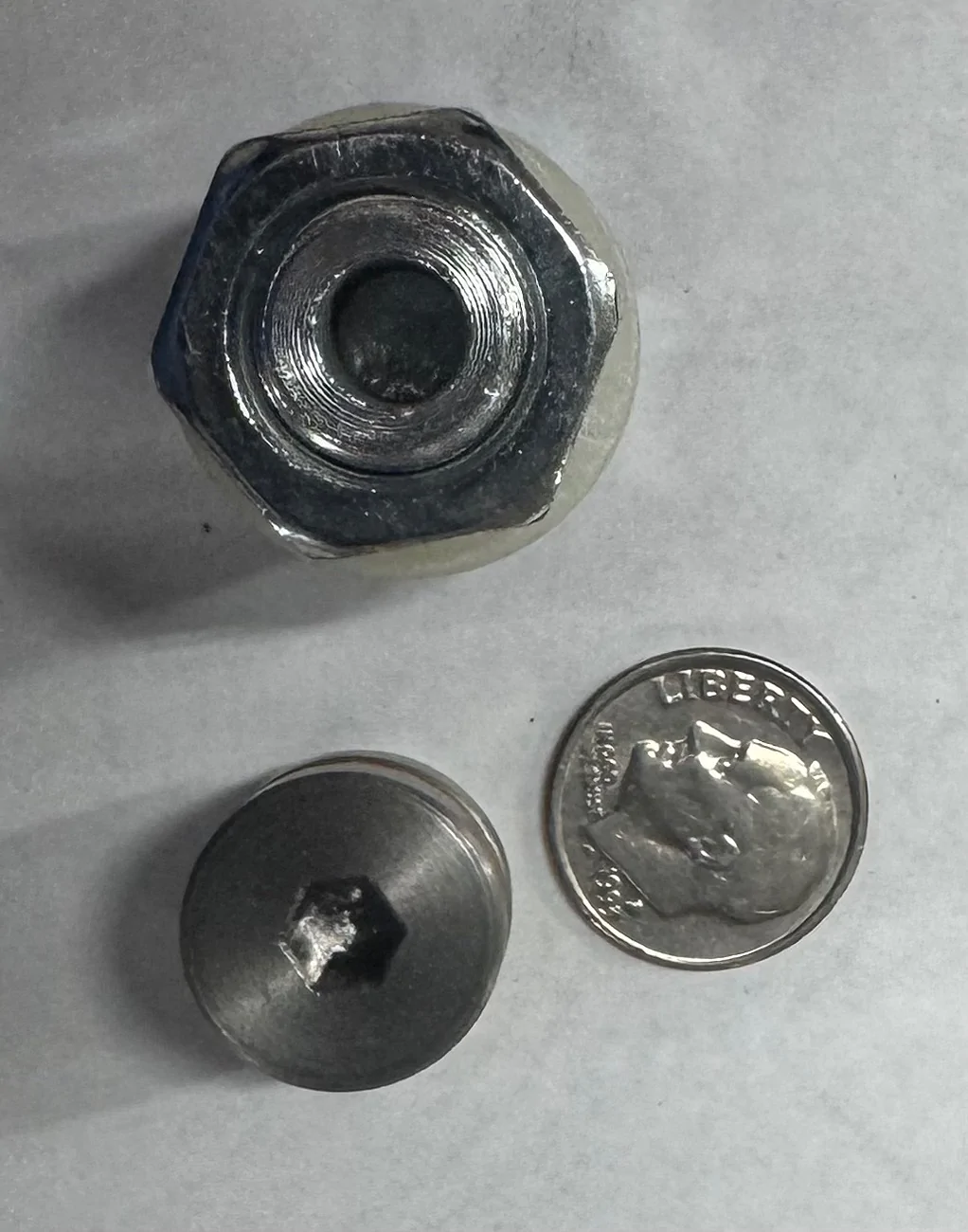

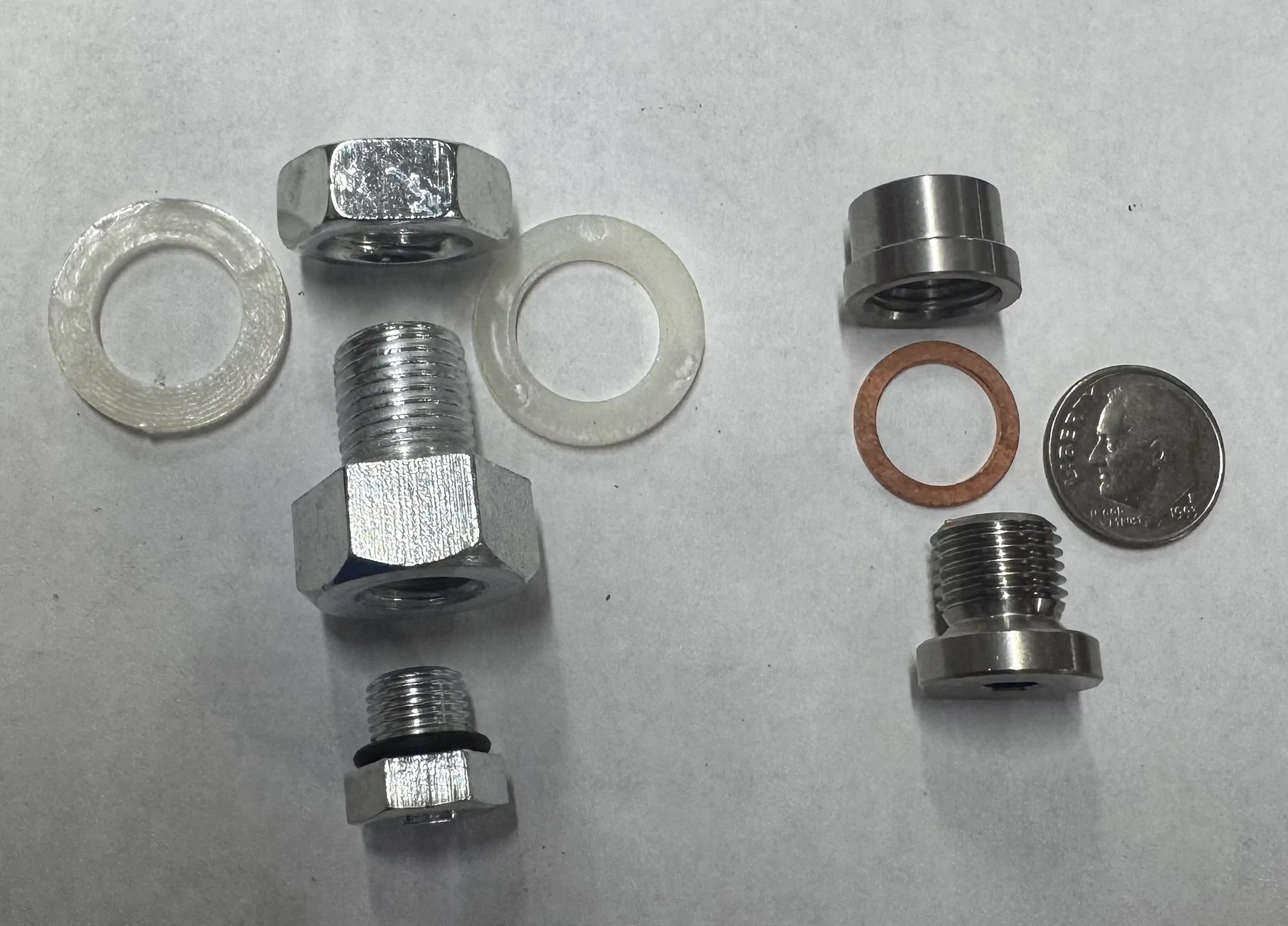

The bolt in plug (I did not use it) and the weld in plug
Jeep Wrangler JL Adding a drain plug to the ZF 8 speed automatic IMG_0218

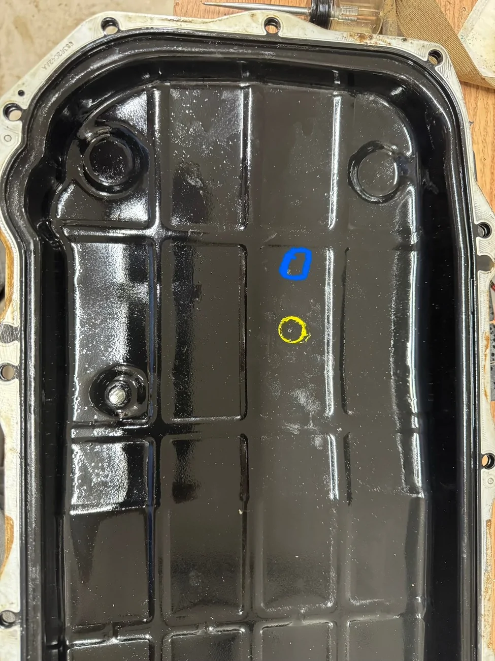

Jeep Wrangler JL Adding a drain plug to the ZF 8 speed automatic IMG_0220
I put my plug in the yellow circle, but I recommend that you drill yours in the blue circle.
See the picture further down to see why.

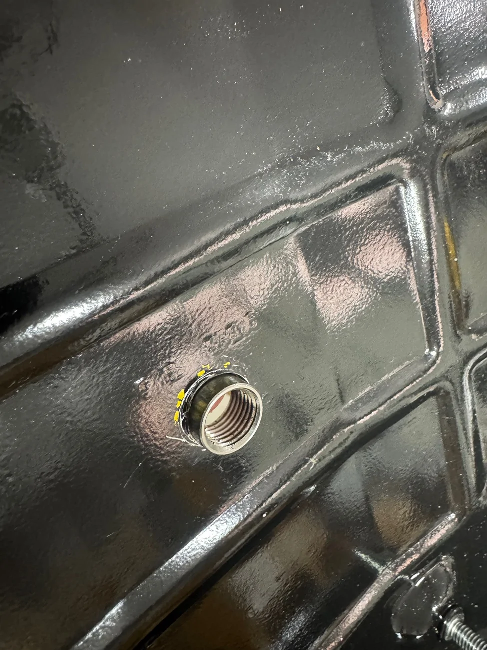

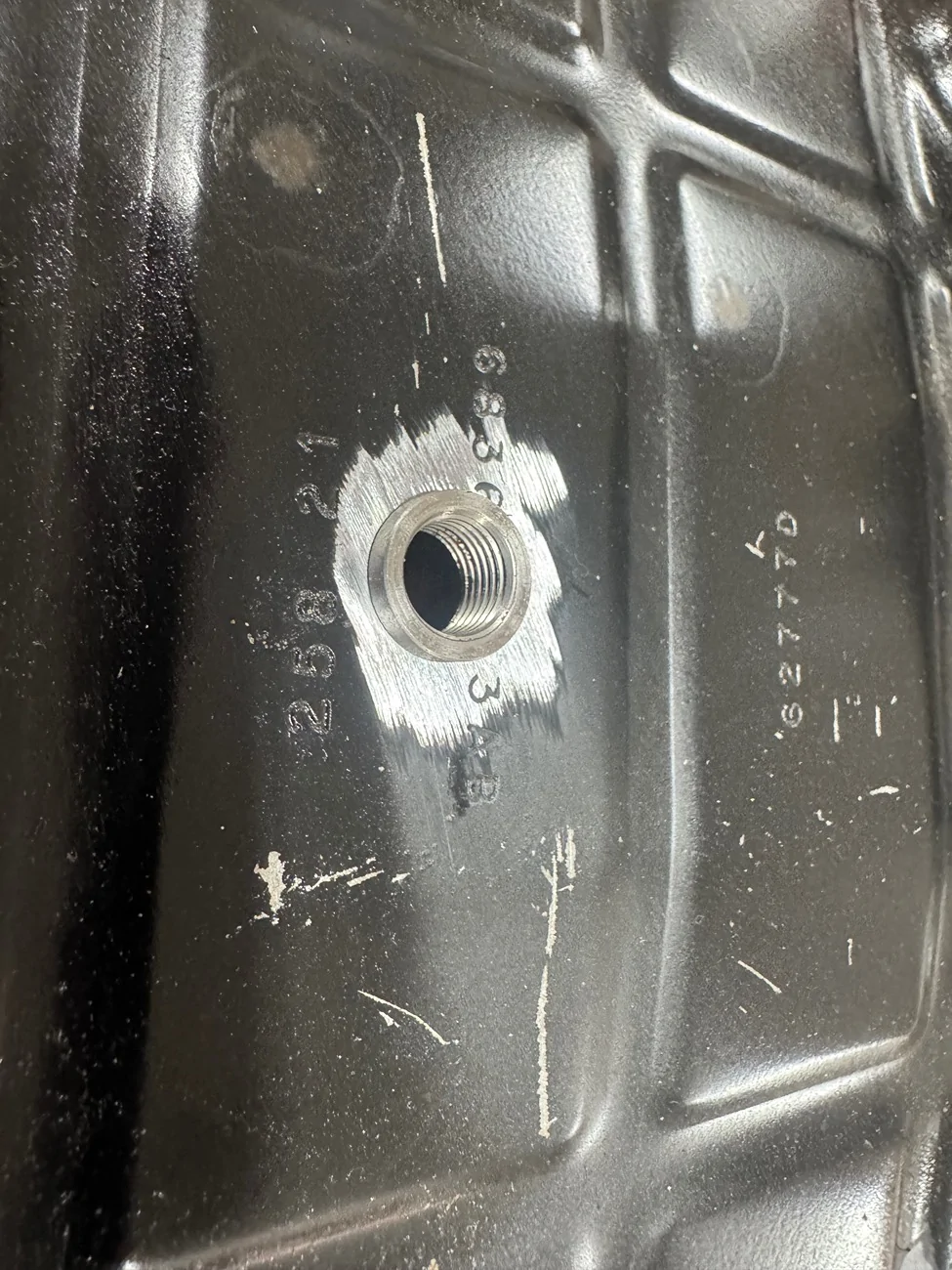

Before welding
Jeep Wrangler JL Adding a drain plug to the ZF 8 speed automatic IMG_0222
Inside after welding

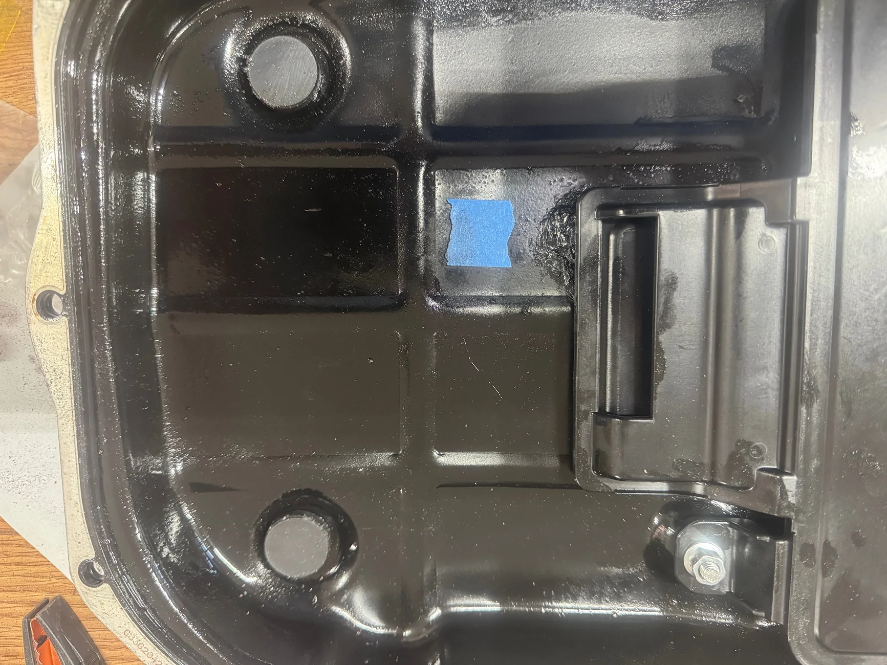

Jeep Wrangler JL Adding a drain plug to the ZF 8 speed automatic IMG_0229
If you drill with the blue circle it will end up here.
mine is to the right just under the filter.
it does not interfere with anything, but would look better where the blue tape is.

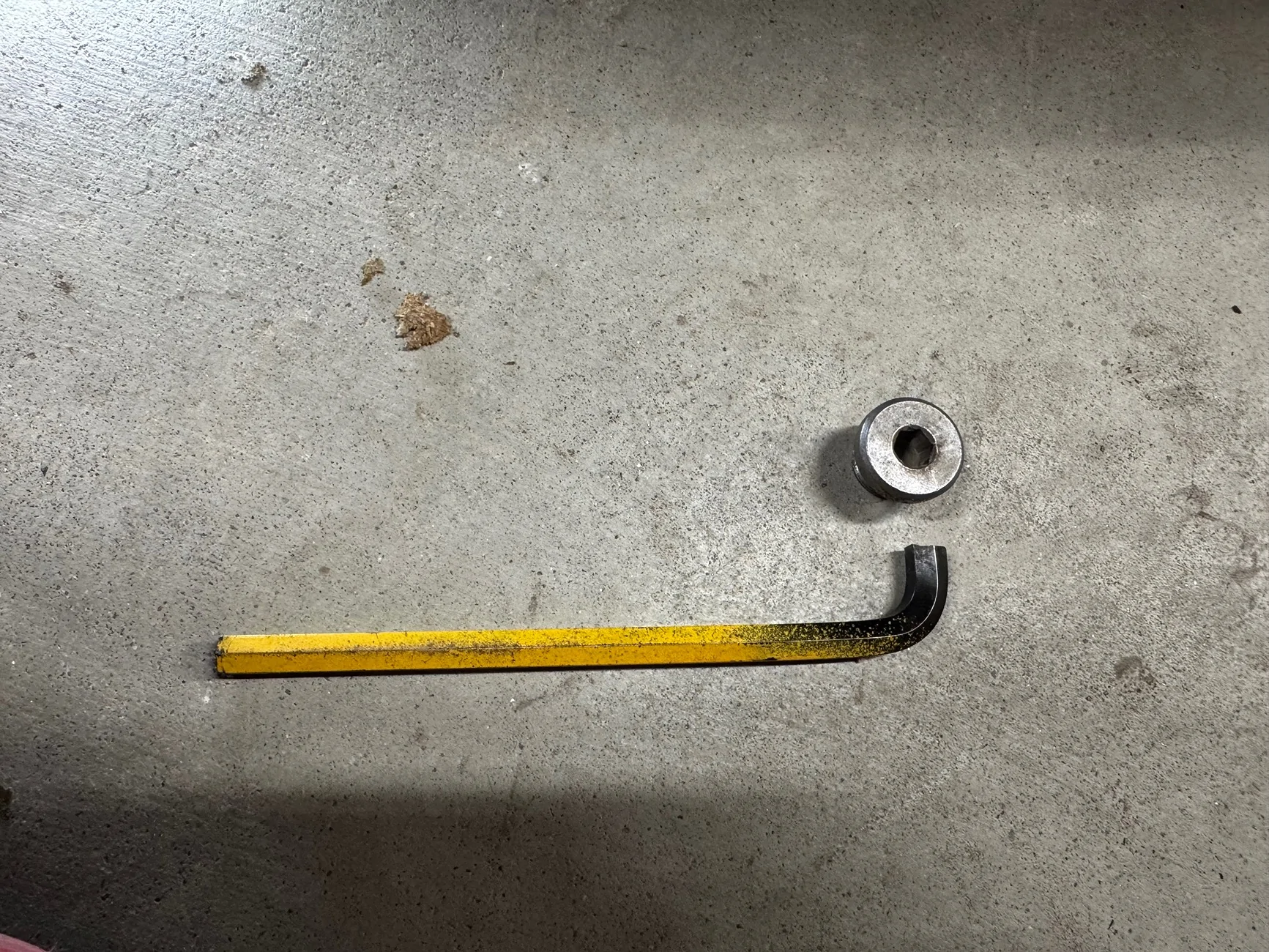

I had to cut my 8 mm hex down to get the stock transmission fill plug out.
Not sure if that is just a JL 2 door problem.
