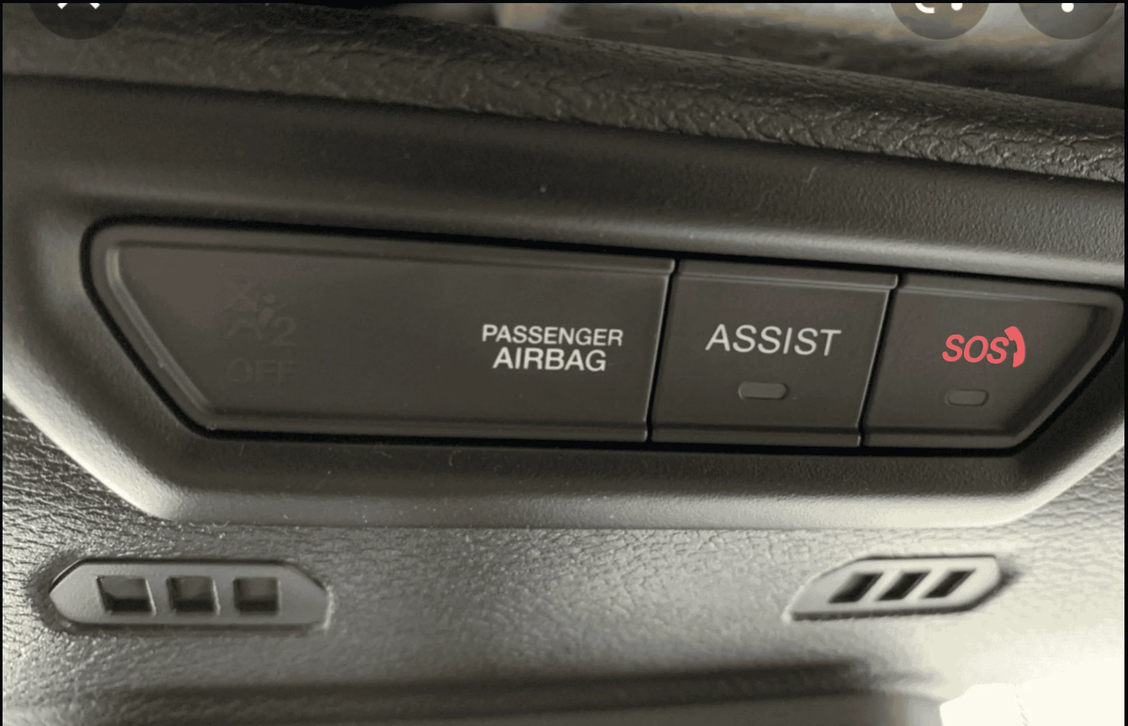

I know that this is a totally random question, but here we go. I am about to go through the process of adding the rearview dimming mirror and also want to add the overhead airbag/assist/emergency button. Has anyone had any experience accessing it? How is it attached and how can I remove it? I currently had the standard mirror and button that just says airbag. I already have the parts picked out through Benny, I just want to know what the difficulty I will be looking at. I already replaced the stock 7" radio with a new (from dealer, not refurbed or second hand) 8.4". I even added the LTE antenna. When I bought my JLR, they didn't come standard with the 8.4". I got too good a deal for an on the lot purchase to order one. I wanted to basically make it how I would have ordered it. So far stuff like the OEM steel bumpers, LED package and HD rockrails with step assist I have saved multiple times what I would have spent had I got from dealer even on an order. The picture is the piece I am looking to remove.

To access that you'll first need to remove both driver and passenger grab handles. There are two bolts in each and then just pull on them. From there move the sunvisors out of the way and pull out and slightly down on the header trim, that will give you access to that piece. I believe it's only held in by retaining clips like everything else.
