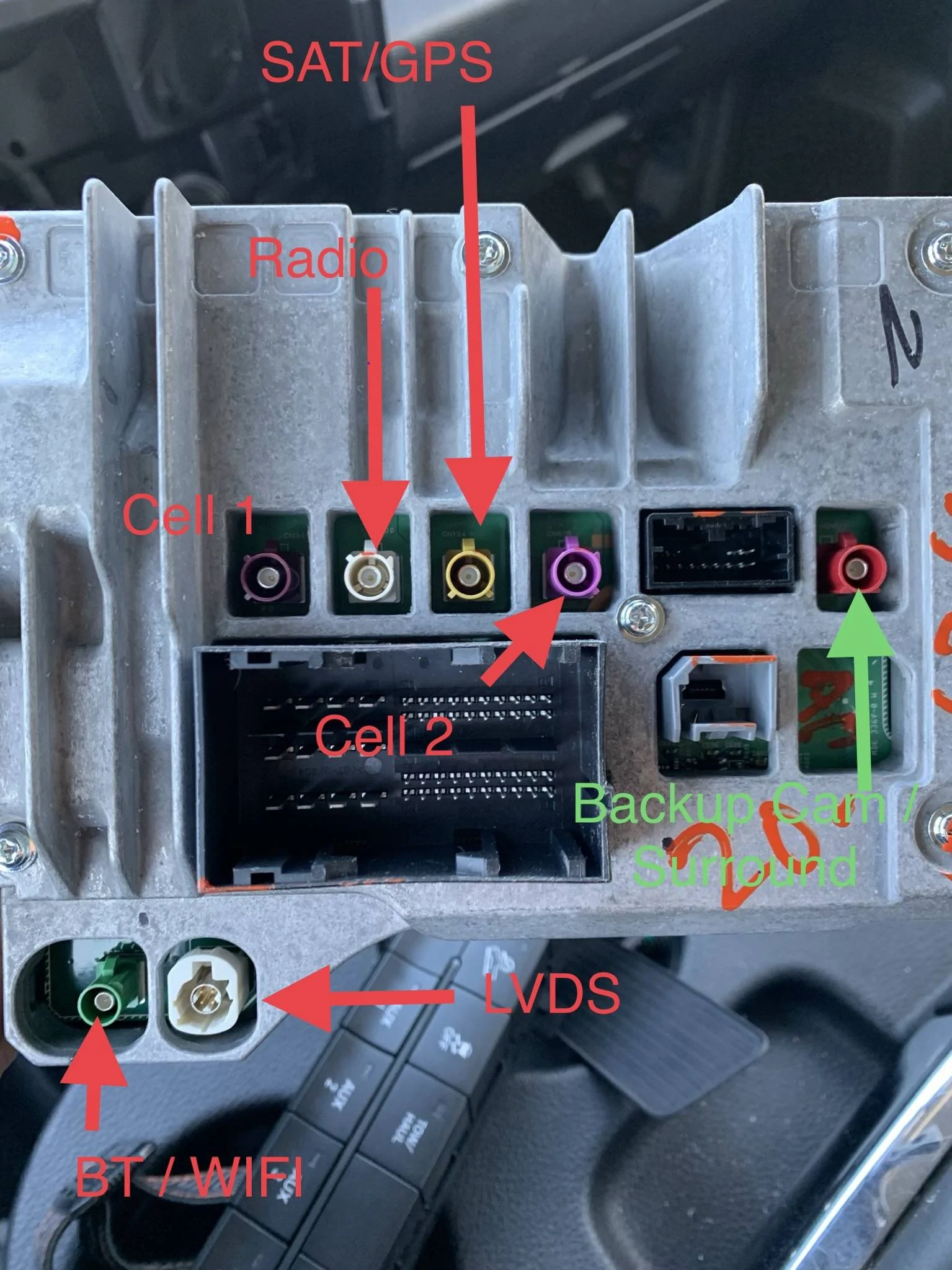

Wow, I was not expecting such a speedy response! Much appreciated!! However, I stumbled upon another question. I noticed that the 8.4" has two additional connectors that my 7" doesn't. In the picture I found online, the two additional connectors are labeled as "cell 1" and "cell 2". Any insight on what the function of those two connectors are?
Thanks again!

The 8.4 has a cell connection for Over the Air updates, the SOS and Assist and a Wi-Fi hot spot. They will not work in your Jeep, but you do get the bigger screen.

Oh, I see. So I can assume the same would be the case for the Jeep I'm swapping my 7" into? Our main concern is just making sure that he's not trading his Wrangler in with a noticeable issue that could lead to a reduction in it's trade-in value.

Well the SOS/Assist and the Wi-Fi hot spot is a subscription service I don’t think they will notice. Reportedly doesn’t work well anyway.
