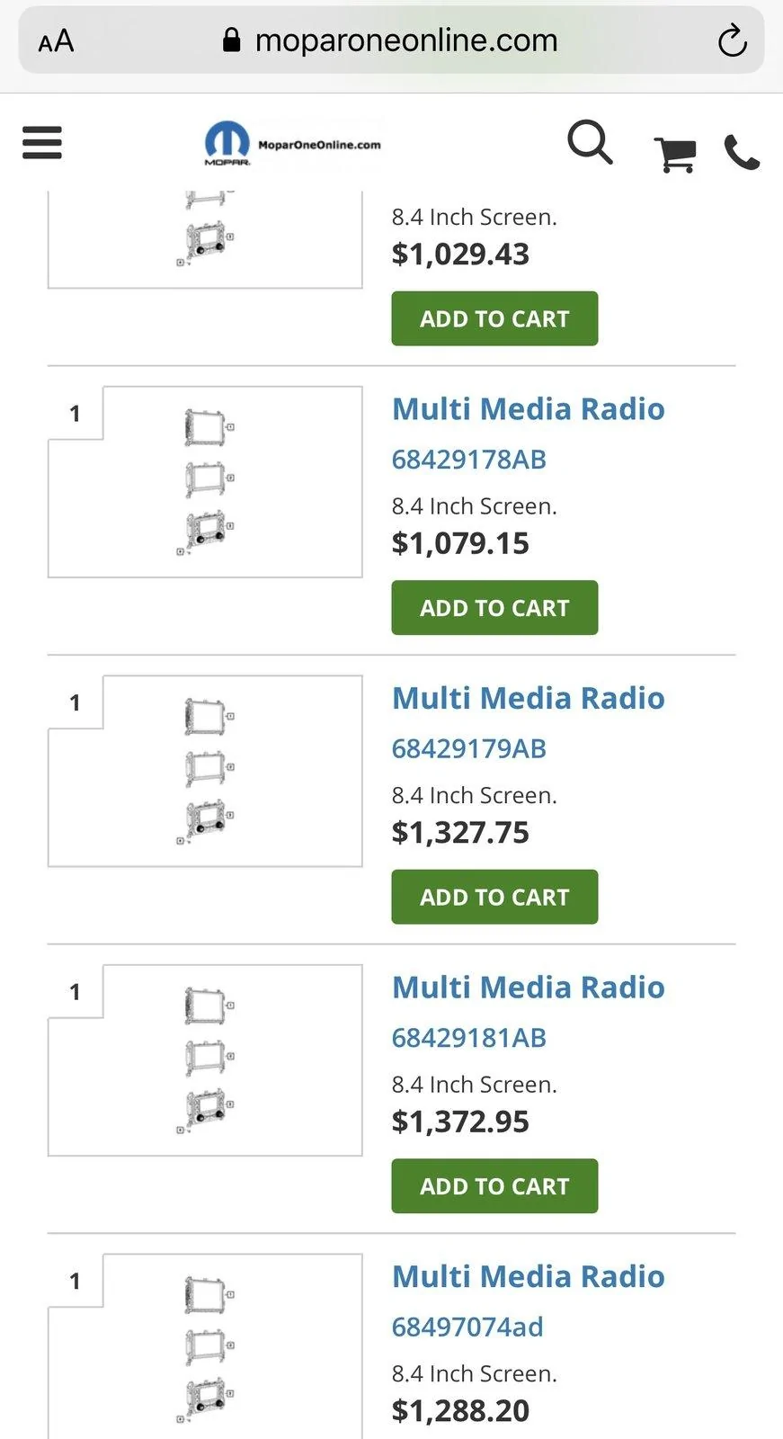

I have a JL sport unlimited with a 7 inch screen, I want to upgrade it to factory 8.4 but when I searched it in moparonline.com it showed many options without description, where can I find it with more info?

My 8.4” radio is 68295725AH and the bezel is 6AB49TX7AA. It has off road pages as well.

Thanks, Was it pre-installed or did you install it?

I installed it. It was plug and play with the 4 digit radio. It takes about 10 minutes with a trim tool and screwdriver.
