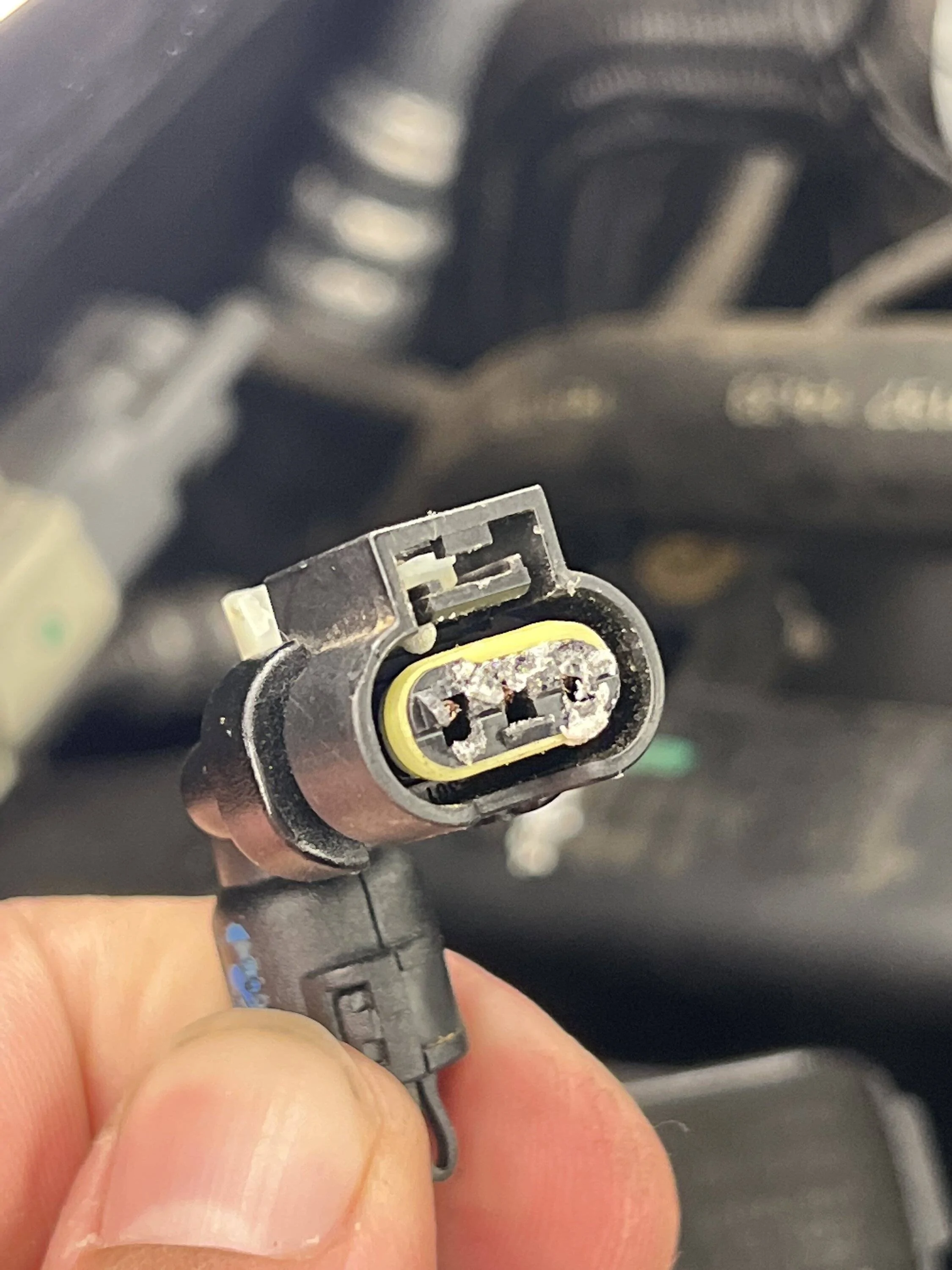

My connector broke. Anyone know what to do? Where I can order a new piece to install. Anything?
Jeep Wrangler JL 60,000mi Spark Plug Change imag

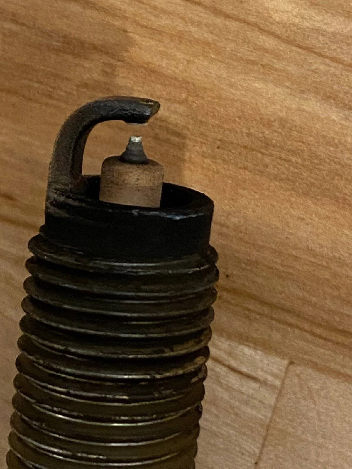

Just replaced the plugs after about 60,500mi and used suggested factory plugs. Changing them out is easy for 1, 3 and 4....just a 10mm bolt for the coil and a 5/8" deep socket with a 6" extension to unseat and then used a telescopic magnet tool to remove. Getting the second cylinder ignition coil (front to back of engine is 1-4?) is a little tight with the diverter valve especially if you have a DV+ installed. Had to remove some of the sensor connectors without breaking the tabs and wiggle it out.
One this that was concerning was after removing each plug there was black soot flakes that came out from the cylinder. See how dark the threads are. The past 15,000mi have been fairly short distance trips (<5mi) of less than 20min back and forth. Camera makes the plug look a little darker than it actually is, slightly more brownish than dark.
If anyone is interested in what 2.0 2018 plugs look like at about 60,000mi which is the change interval per Jeep.

You got some carbon build-up for sure.
If your plugs look like that you valves have carbon and so does the combustion chamber.
3 ways to mitigate:
1) Pull heads and get a valve job and clean the combustion chamber using a solvent (don't to change oil when you are finished.
2). Look for a lonely highway. Come to a full stop then nail the go pedal to the firewall, watch the temp gage and when it begins to rise back on off and most of the carbon should be gone, or you can turn around and repeat.
3). 12 oz can of water, engine FULL operating temps under the hood. with the engine running and someone in the driver's seat revving the engine slowly pour the can of water into the engine.. Looking at your plugs and thinking on the combustion chamber I do it twice. If the engine stalls because you poured to fast don't worry just start and keep going.
I am thinking of looking at the plugs and with 60k You make want to remove the cat if you can. All you need to do is separate the exhaust from the CAT pipe and that is, no need to remove anything, you should have enough play unless your cat is perm connected to the exhaust pipe.
