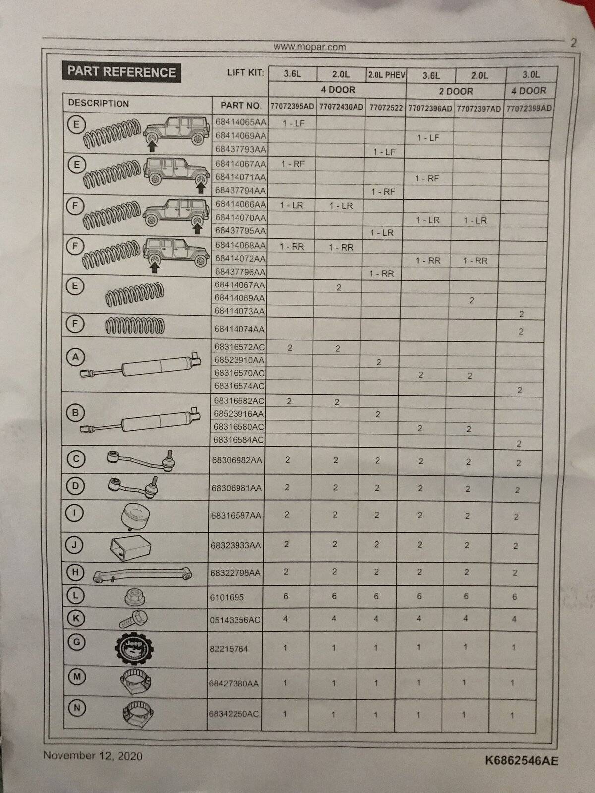

Are those the stock spring numbers? Here’s the lift part list from a member here.
Im not 100%, I only reposted what Electrion posted on a FB group. Perhaps he can weigh in.
*edit--went out and looked at mine. Ive got the spring listed on this parts page. Except my front springs are backwards....
