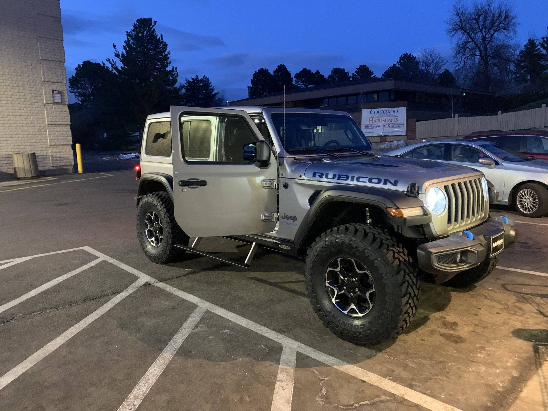

Very nice!!
They are the original wheels - correct? So it is possible to put 37s on the original wheel?
I'm thinking of just doing 35s, so guess that would be okay also? Any sense if 35s with regular Rubi suspension (aka no additional lift) would be okay without rubbing or any other issues.
If there's a go to thread on 35s - what fits etc. would love anyone to point me in that direction.
The wheels needed spacers to fit the 37s, not sure if 35s would be the same you would need to ask. I think you may get some rubbing in extreme conditions without a lift....

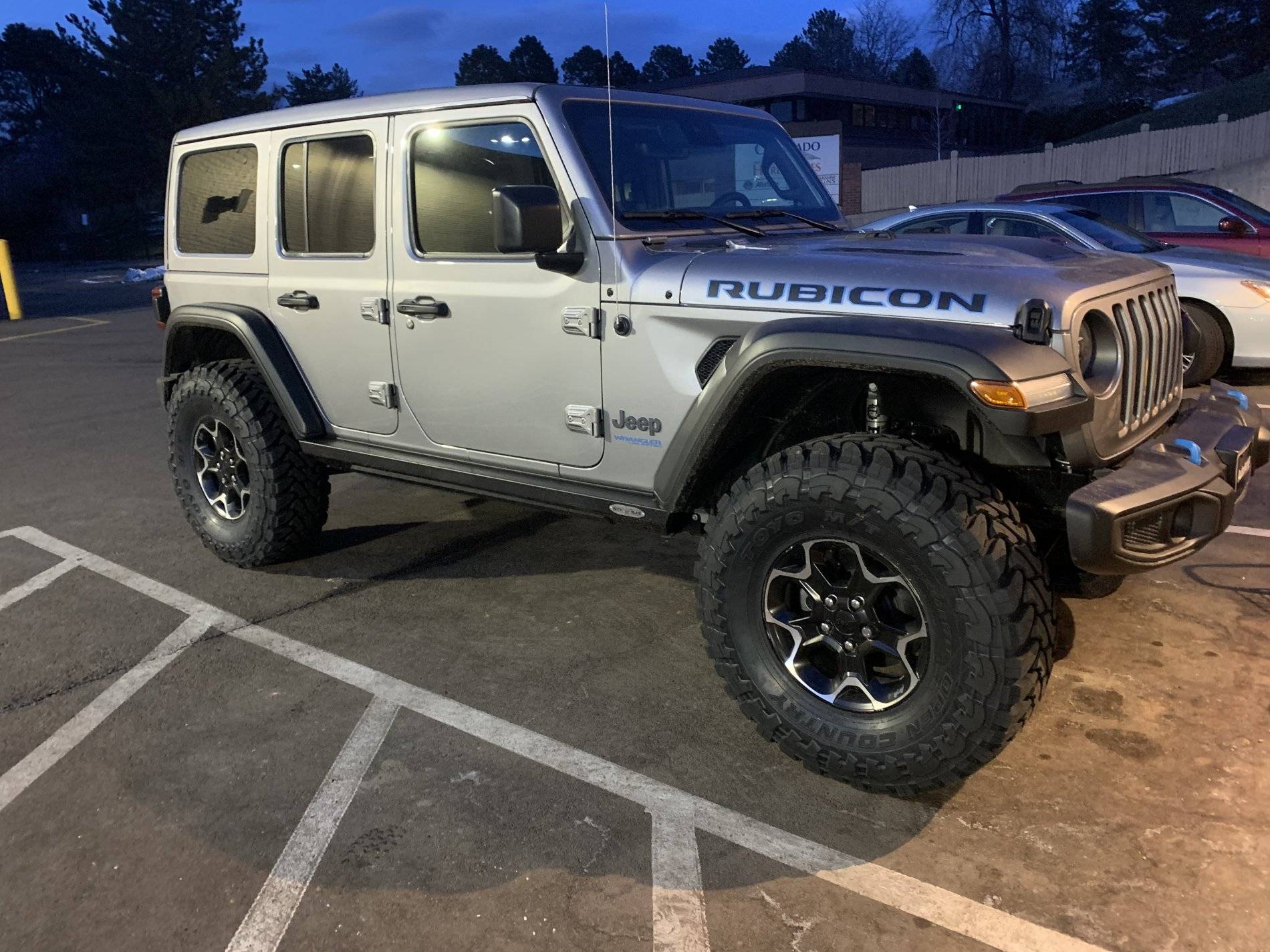

We had a teraflex 3.5 inch lift installed by the dealership with 37s. Looks great and is running well. But, they were unable to get the tazer to change the speedometer yet and the battery mileage definitely has taken a hit, seems like it’s down to around 15 miles now on the battery per charge. Bringing it back this next week to get the bumper and winch put on. Will update again from there
Slick set up! Are you running the Teraflex 3.5in springs then? Any bowing issues? Did the Front and rear level out correctly?

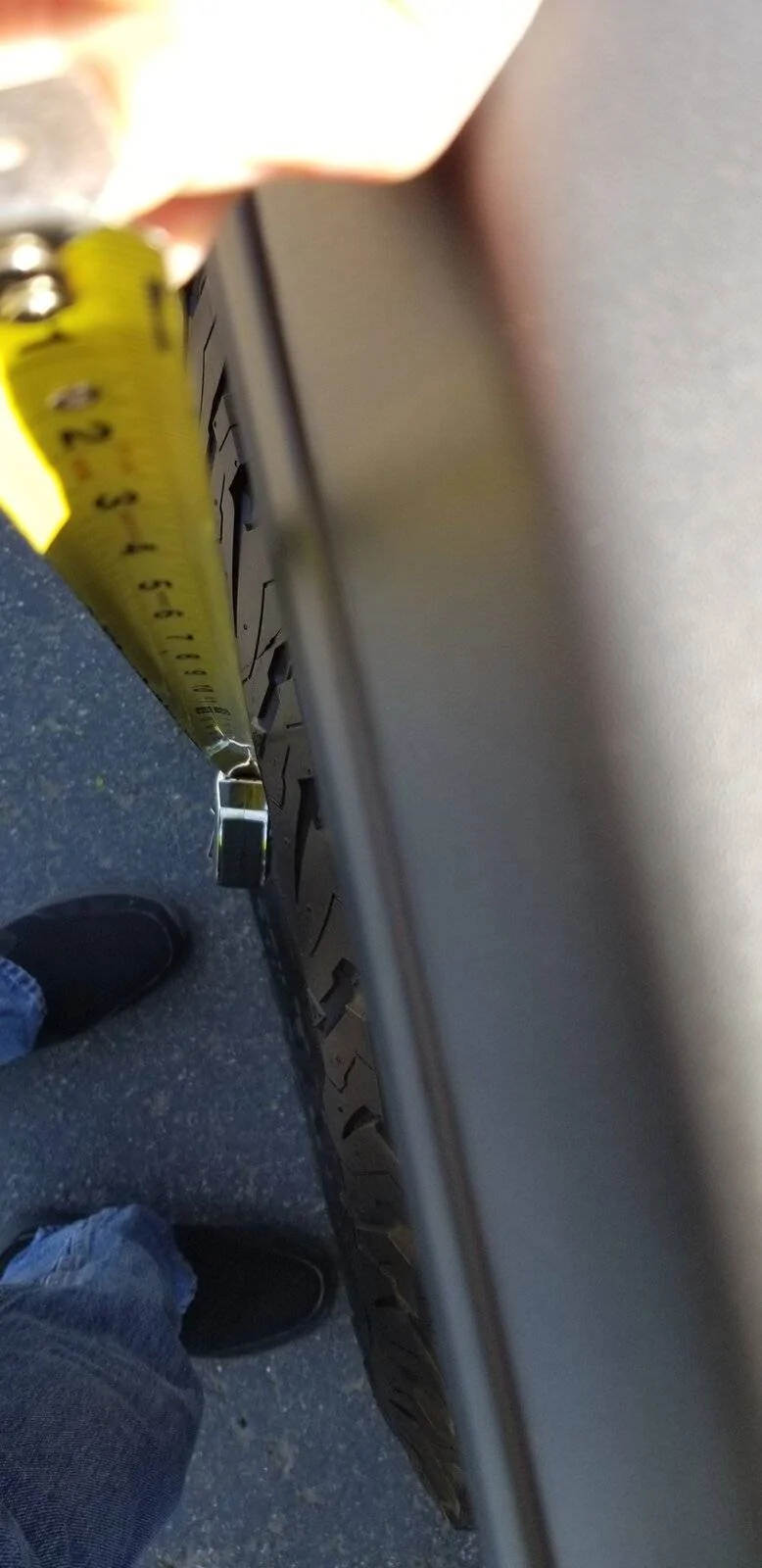

These were not easy to measure without a plumb bob & right angle. Did my best using a tape measure as the plumb bob & my phone as a straight edge. I didn't run a full gage r&r (certain my repeatability is bad), but I'm probably +/- 1/8".
Vertical Measurements
Head in
LR 23&5/8"
LF 23&7/8"
RR 23&3/4"
RF 24&1/8"
Back in
LF 24&1/8"
LR 23&7/8"
RR 23&1/2"
RF 24&1/8"
The difference Rt to Lft in front seems to be basically zero. I measured twice with parking head in & back in.
(Head in)
L -1/4"
R +1/4")
(Back in)
L +3/8"
R -3/8"
Slope of the parking spot seems to make the most difference. Nothing around here is level!
