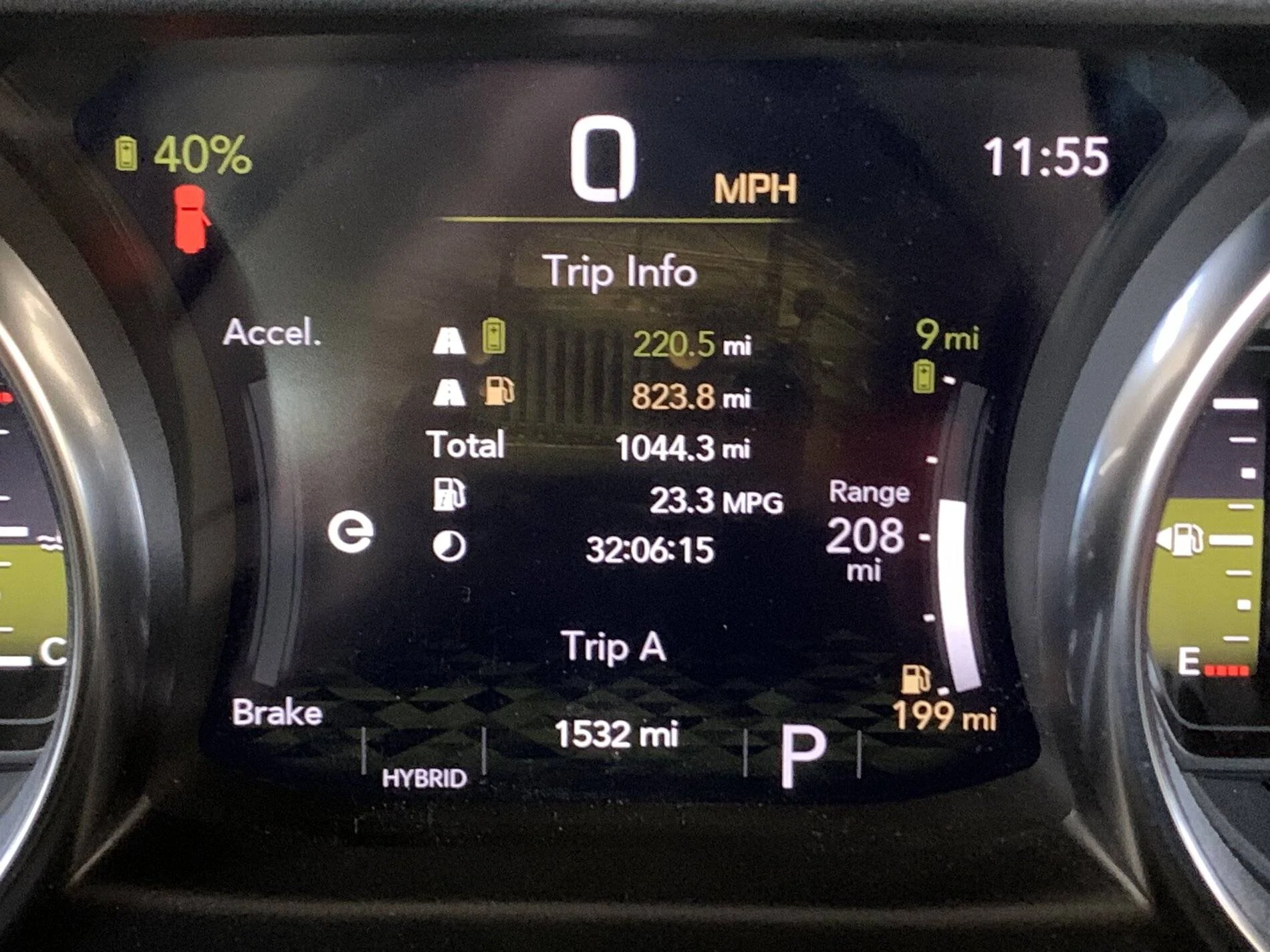

Bare with me as this is gonna be kinda long winded based on my recent experience.
I used a mix of Hybrid, e-save store and charge on our trip to Telluride and back last week. Roughly 1050 miles covered including off road in 4L. During the long driving stints I kept experimenting with using Max Regen while in charge to see how much juice I could recover. My best results were coming downhill in stretches like 550, Monarch and areas of 285 (downhill on monarch alone with charge and max regen pumped me from 0 up to 32%). I will admit, charge is kind of a mixed bag but I damn near had a full charge running mostly around 65mph after about 250-300 miles heading to Telluride from Buena Vista. My average mpg peaked at roughly 26 on this stint with my final trip mpg stopping at 23.3. Keep in mind this is with all of the electric only driving I managed to squeeze out with 3 nights of full charge at our hotel. Final results are posted below. Do I think charge is still worth it? On downhill stretches you can absolutely benefit especially with max regen, but I can’t say I see a huge benefit outside of that. Just stick it in Hybrid or Store if you wanna save the juice for the trails.
