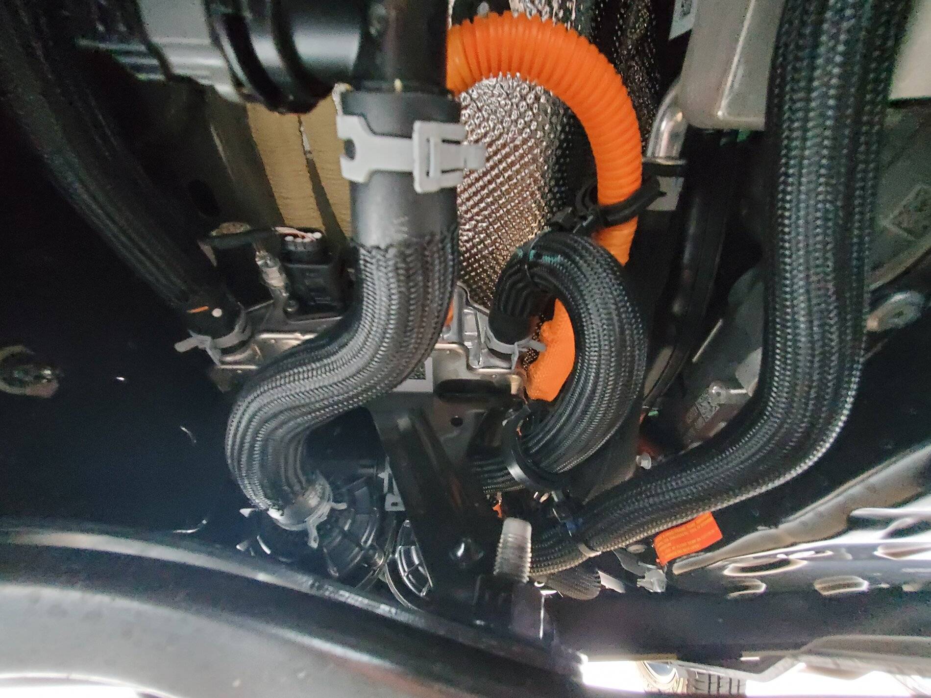

Unfortunately this is a very common thing that almost all manufacturers experience when they start producing plug in vehicles. If the pink fluid is coolant then the most common cause of the leak is overflow expansion due to an improper fill at the factory. Very easy to do considering how complicated the cooling systems are with these types of vehicles.
The next most common issue is a leaking connection or pipe. There are a couple dozen connections and plumbing everywhere....especially this vehicle. Jeep put the battery inside the cabin and the electronics under the cab between the frame rails and then one motor in the transmission and the other motor on the engine itself. All this stuff needs some cooling so there is plumbing all over the place.
So, the bad news is the parts are not common and are specific to the 4xe. The good news is most all those connections are very low pressure so they should last a very long time and not need service for 100k miles or longer.
I hope you get your Jeep back soon.

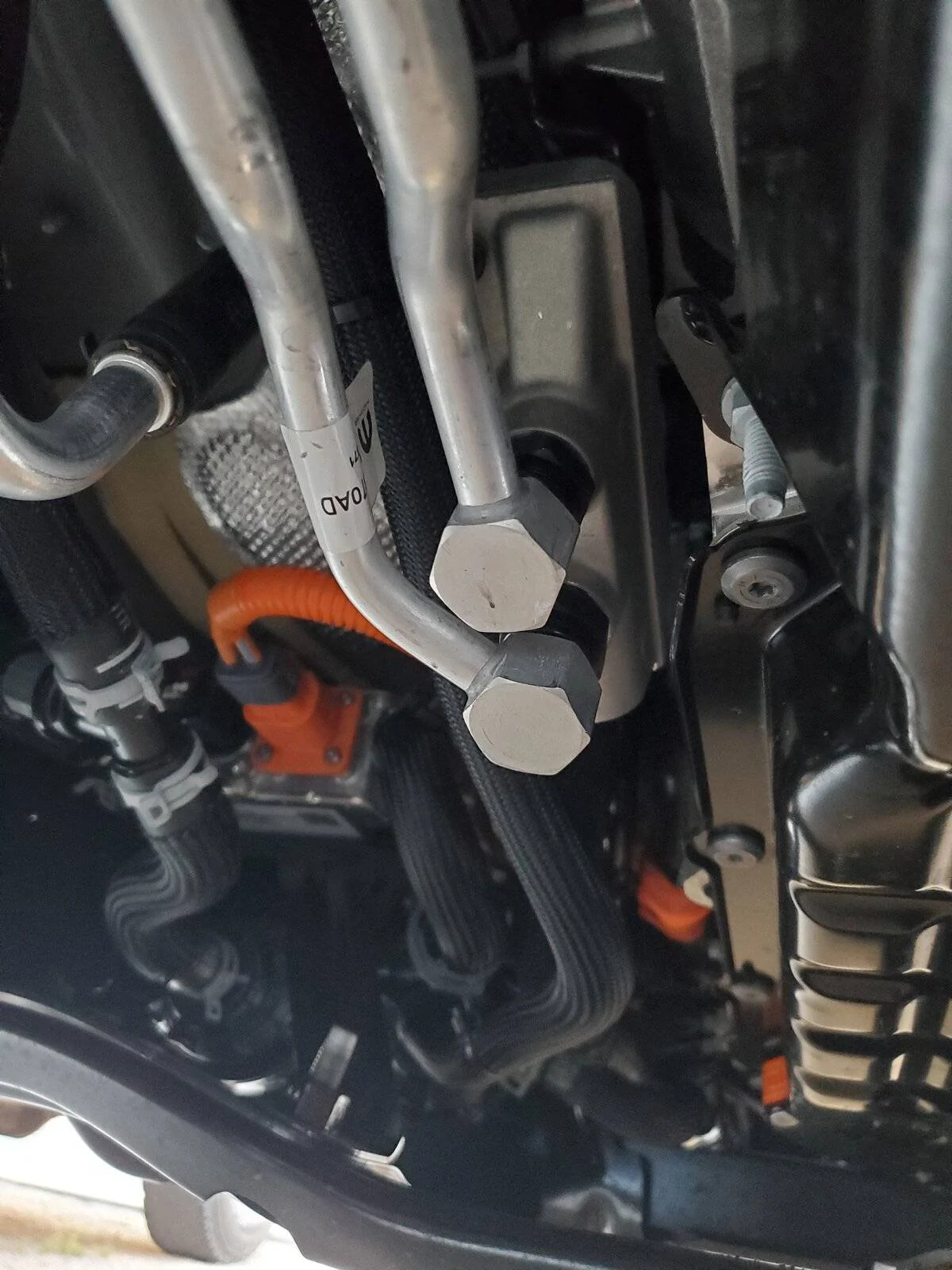

Your the first person who actually crawled under one of these things ( or maybe on a lift) and snaped a picture. the scary part is all those plastic connections will fail and I wonder how much all those hoses and connector will cost to replace.
I would assume any vendor who designs a skid plate will make a fortune.
I wonder how many folks who ordered one of these even gave this consideration.

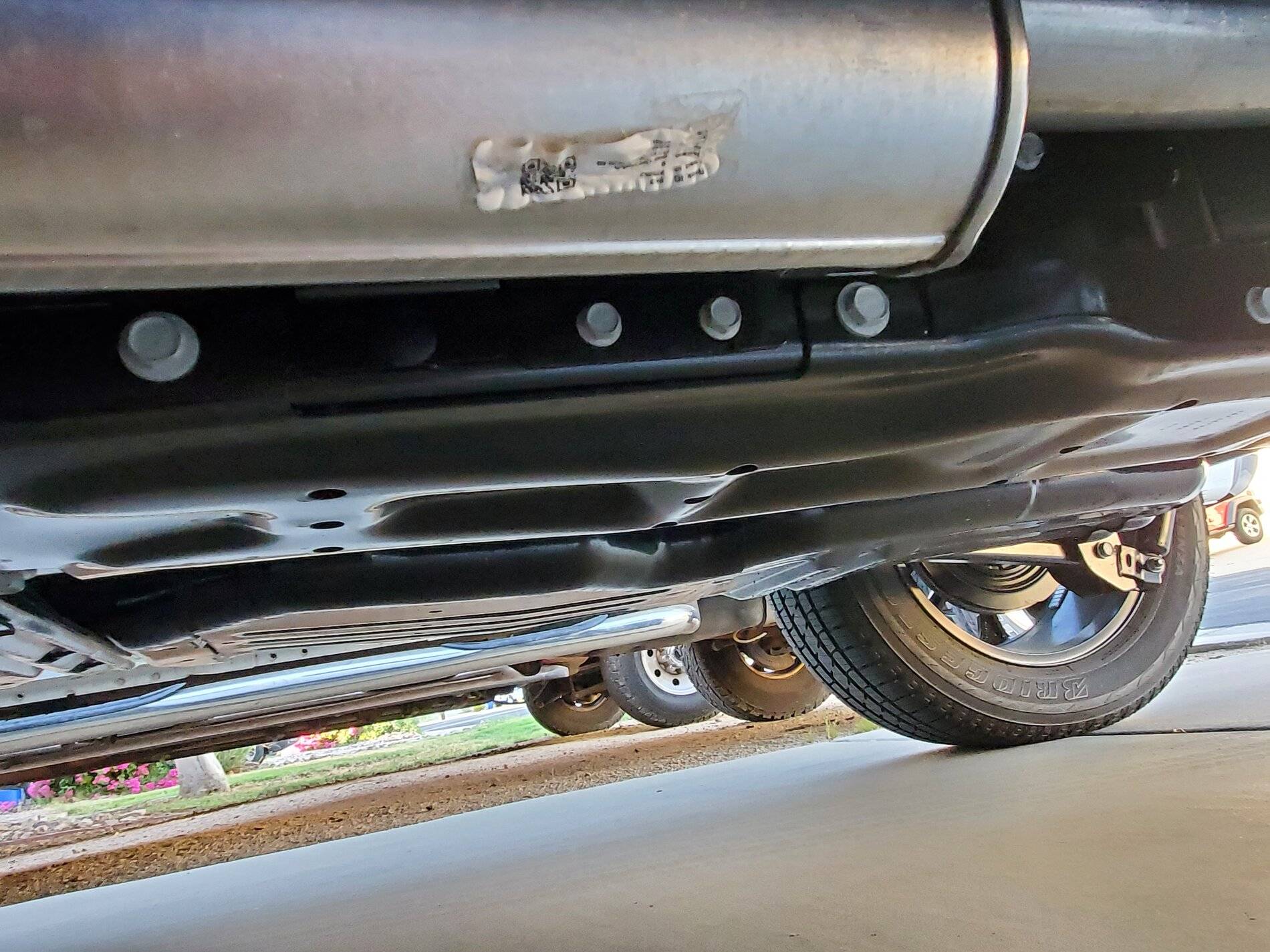

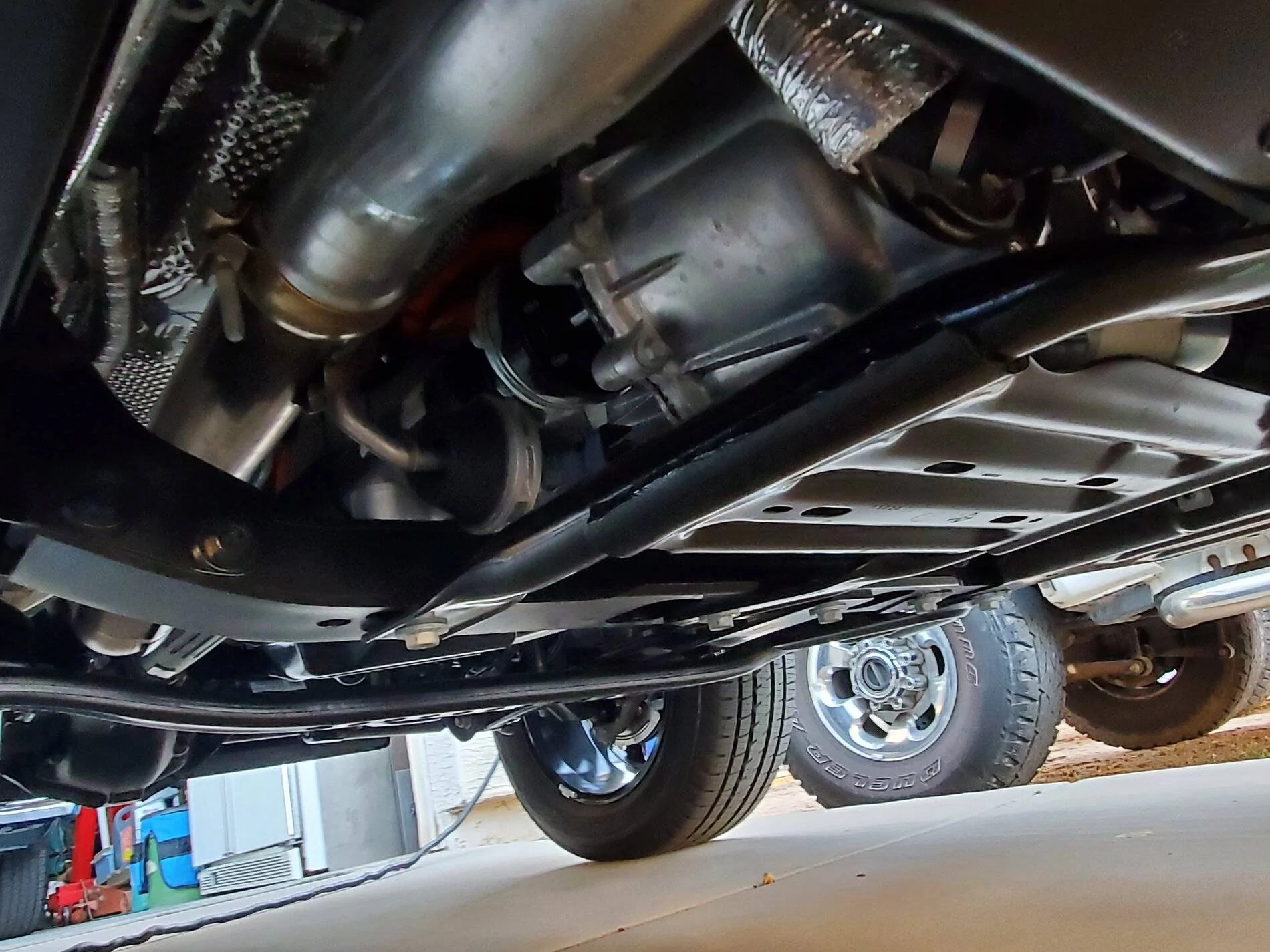

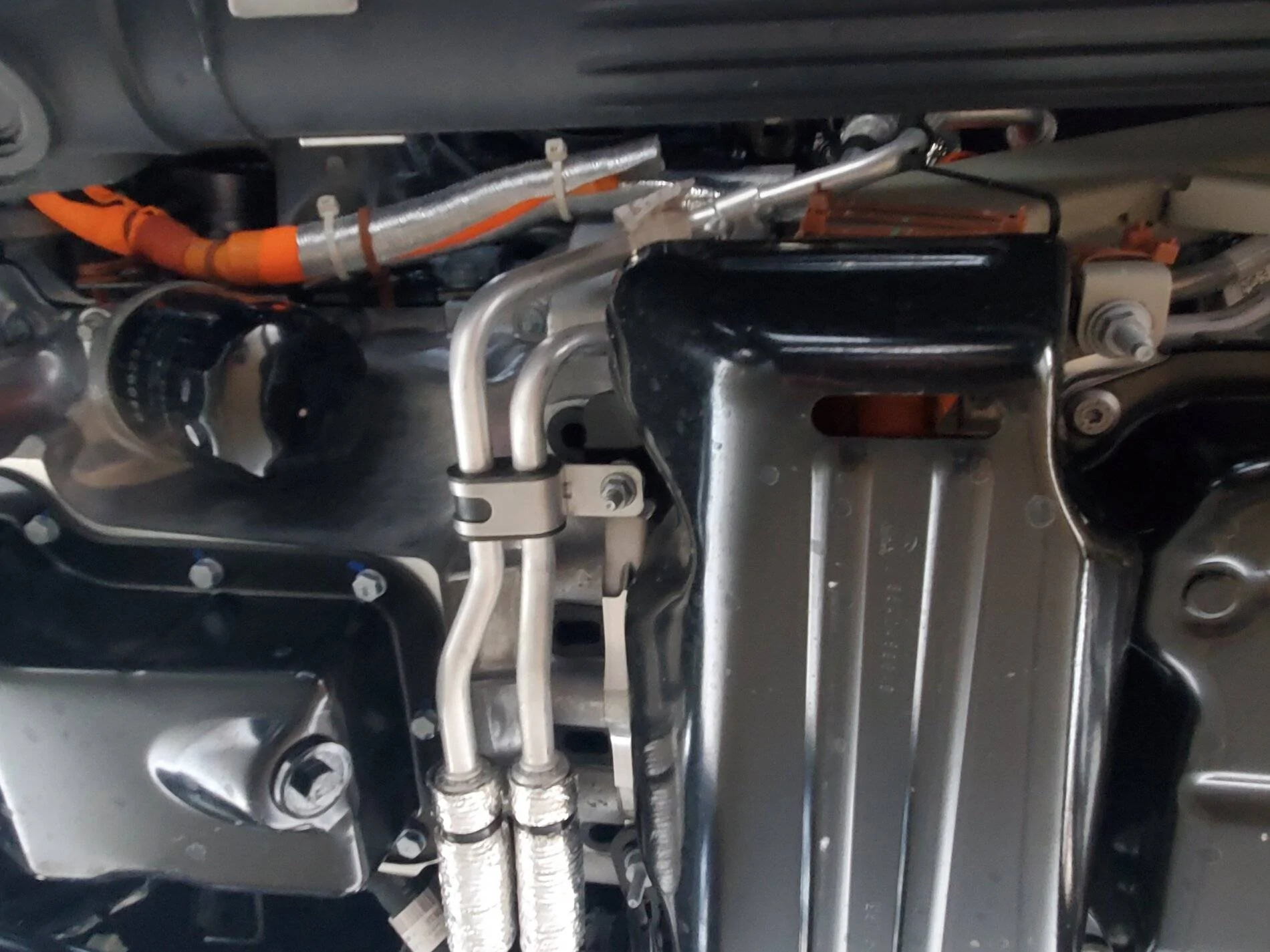

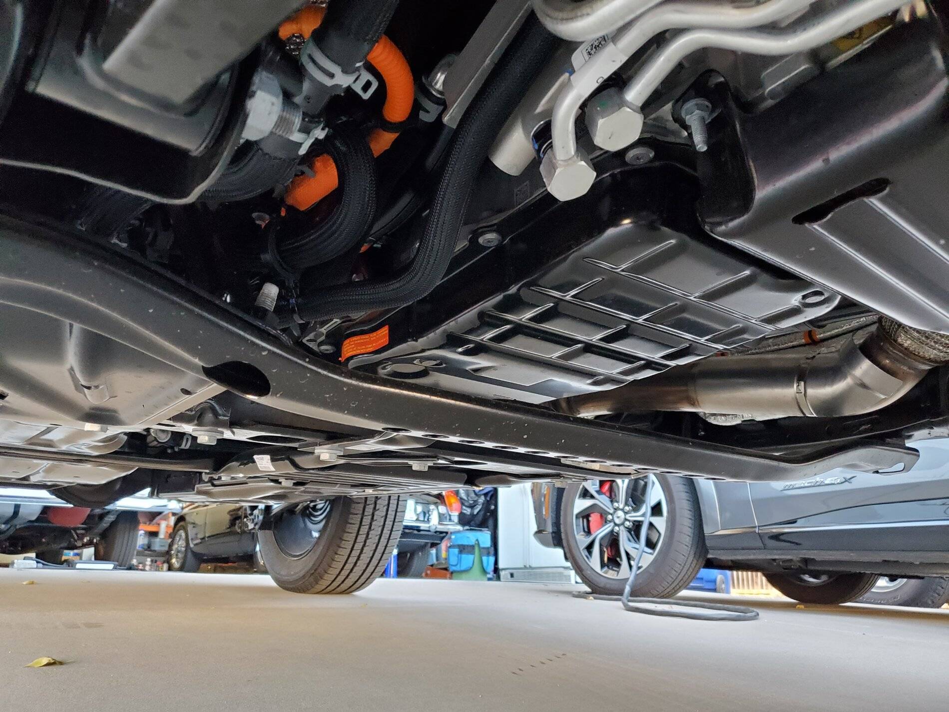

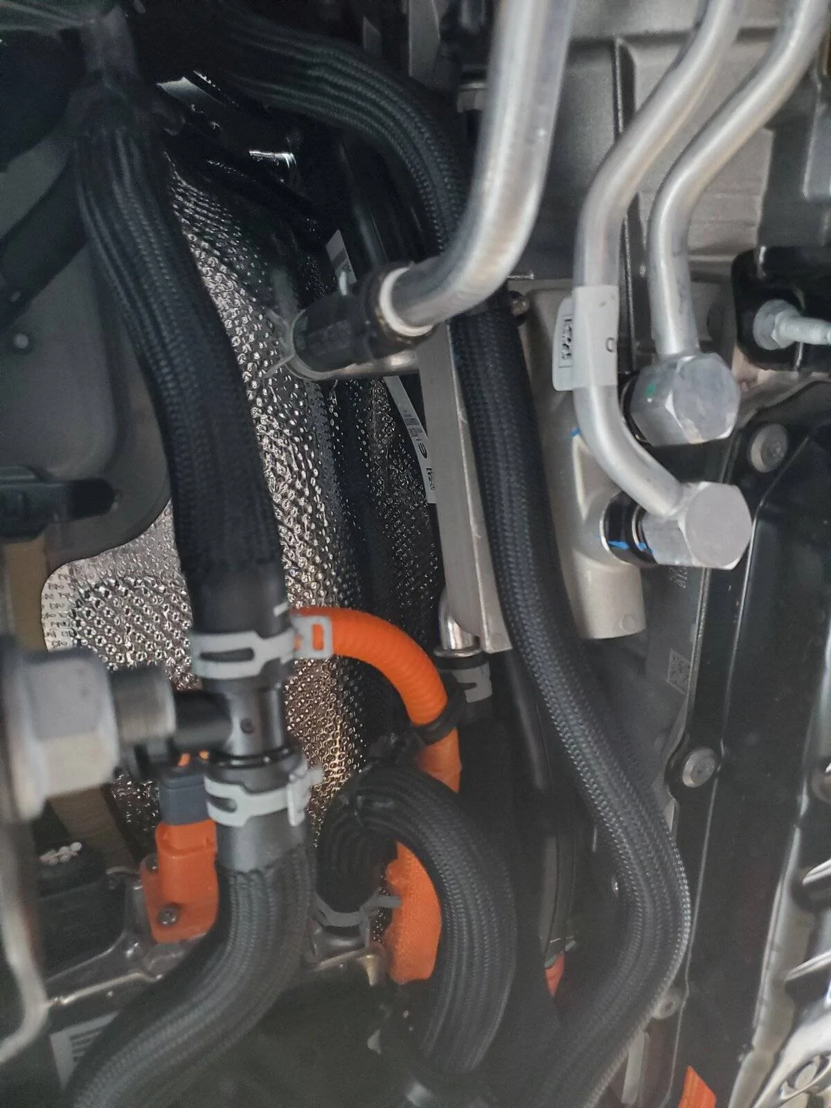

I wish I had a standard JL to compare but there are quite a few skid plates under this thing....way more than my son's JK Rubicon has. Even so, there is an area that I think some more protection would be advantageous and that is for the transmission pan (even though it looks very tough already....) and extend it over to the right to protect some hoses that might be exposed. They are tucked up in there pretty good but I can imagine how trail debris can get up in there and cause some damage.
We did take the Jeeps out this weekend and practiced on a mild Jeep trail at Sedona AZ. Schnebly Hill Road, which is a trail used by the Jeep tour companies in the area. It was a good beginner trail to get familiar with the vehicles and shake them down a bit. The High Altitude 4xe actually cleared everything without issues. My son's Rubicon picked up a nice dent in the cross member for the transfer case skit plate. Both trucks are bone stock and appear to have about the same ground clearance as best as I can tell so it was probably just a lapse in judgement on his part. It happens. :)

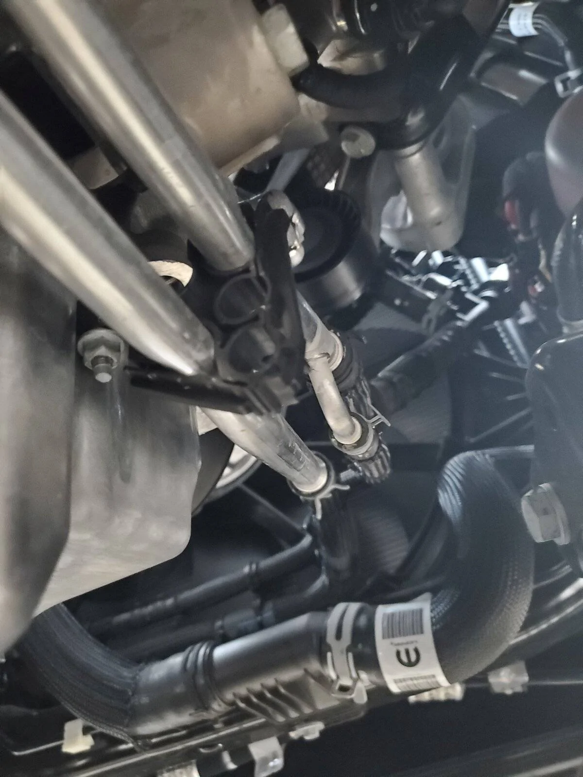

Here are some more photos, the first is an area that I would like to protect. These are the coolant hoses to the electric heater (cabin and battery). There are a couple pumps up in there as well...

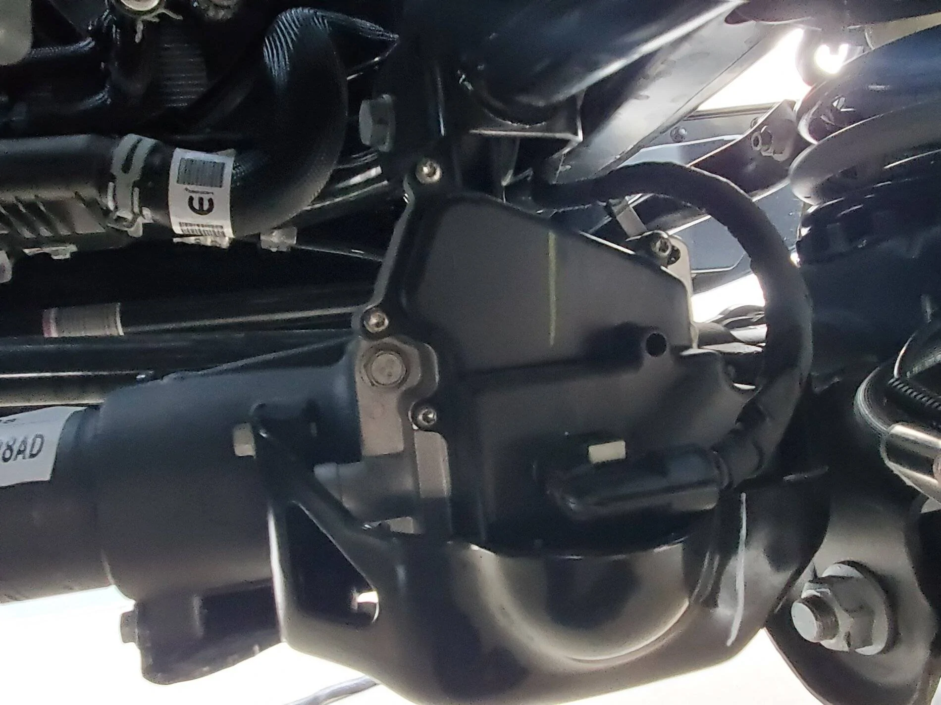

The other photos show some of the factory provided protection. There is a solenoid thing on the back side of the front axle housing tube. I suppose it has something to do with the 4HAuto feature. It has a beefy looking steel protective housing. I think something like this would be useful for the differential housings as well. Might look and see what is available for those things.
We are already planning our next outing at the end of this month. :)
