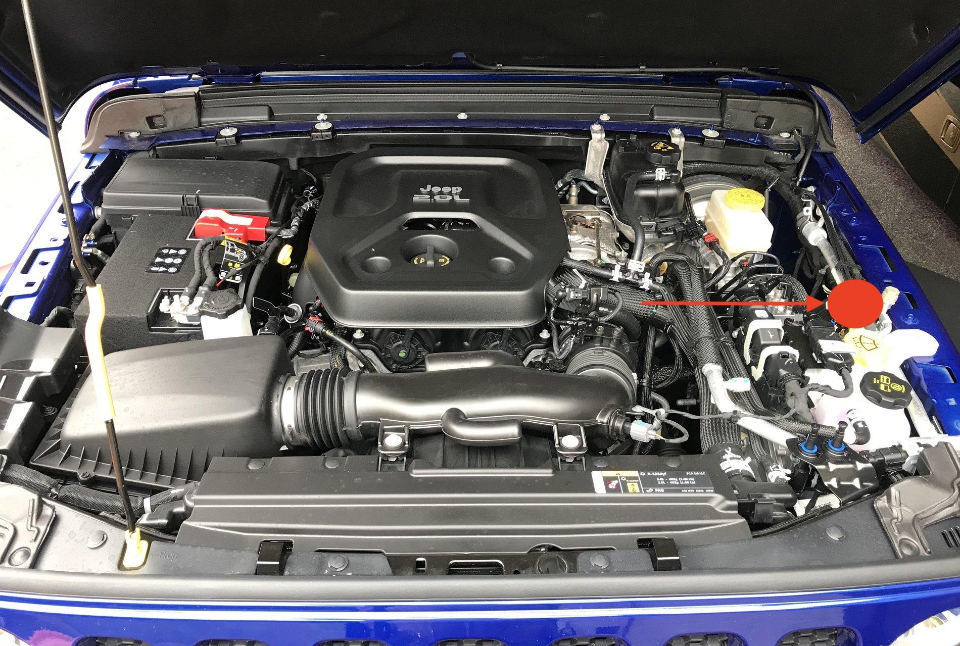

Yes, you don't have the eTorque version of the 2.0 engine. The eTorque is equipped with the 48 Volt battery system and BSG. A quick way to tell a 2.0 eTorque from a regular 2.0 is the eTorque has two coolant bottles on the driver fender. There will be one coolant bottle on each side of the windshield washer reservoir. In the picture, the arrow and red circle are where the second coolant bottle will be.
Since you don't have the eTorque, your engine has regular ESS. There is a small battery in a compartment underneath your main battery.
