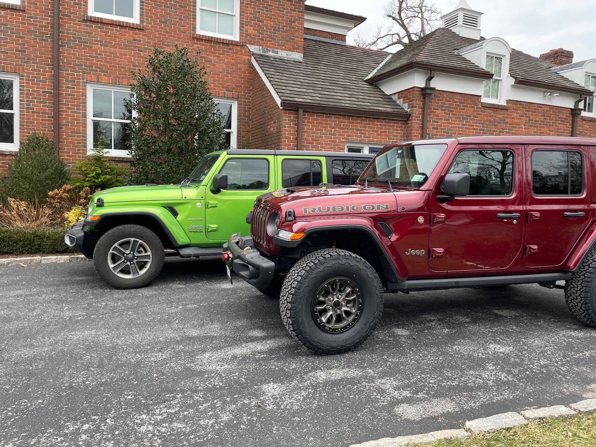

I ended up going with the BF Goodrich KO2s in 315/70/17 (C Rated) I don't think the weight difference (10lb per per corner) is a deal breaker. Lets face it It's a straight line monster and if the g forces don't scare you to death the higher Throttle exhaust note will make up for 2/10th seconds off the 0-60
I added the jeep tailgate reinforcement bracket and the 35" spare fits on the existing hardware with it barely resting on the bumper.
Inexpensive upgrade for more height and aggressive stance and I have the old 33's for my son's next tire change on his Sahara.
Thanks to all for their input

I got the 35x11.50 at3 Load C. They are 61 lbs, exactly the same as the falken m/t that came off. first drive today with them on since I loaded up all 10 tires/rims in my truck for removal/mounting/balancing. only went 30 miles or so. Trying to tweak the psi, i am at 32. Really love the size. Seems perfect. Drives great.
Glad yours fit in the carrier, I got lucky also, fit just enough.
