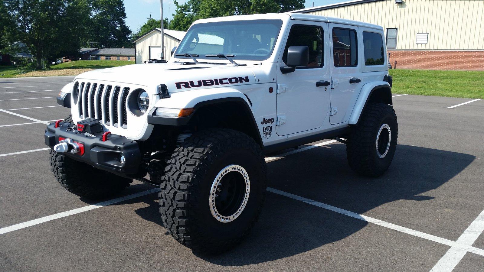

@Hogpup Those cooper STT look clean. What load range are they ? Do you mind sharing the lift you are using and ride quality? Thanks!

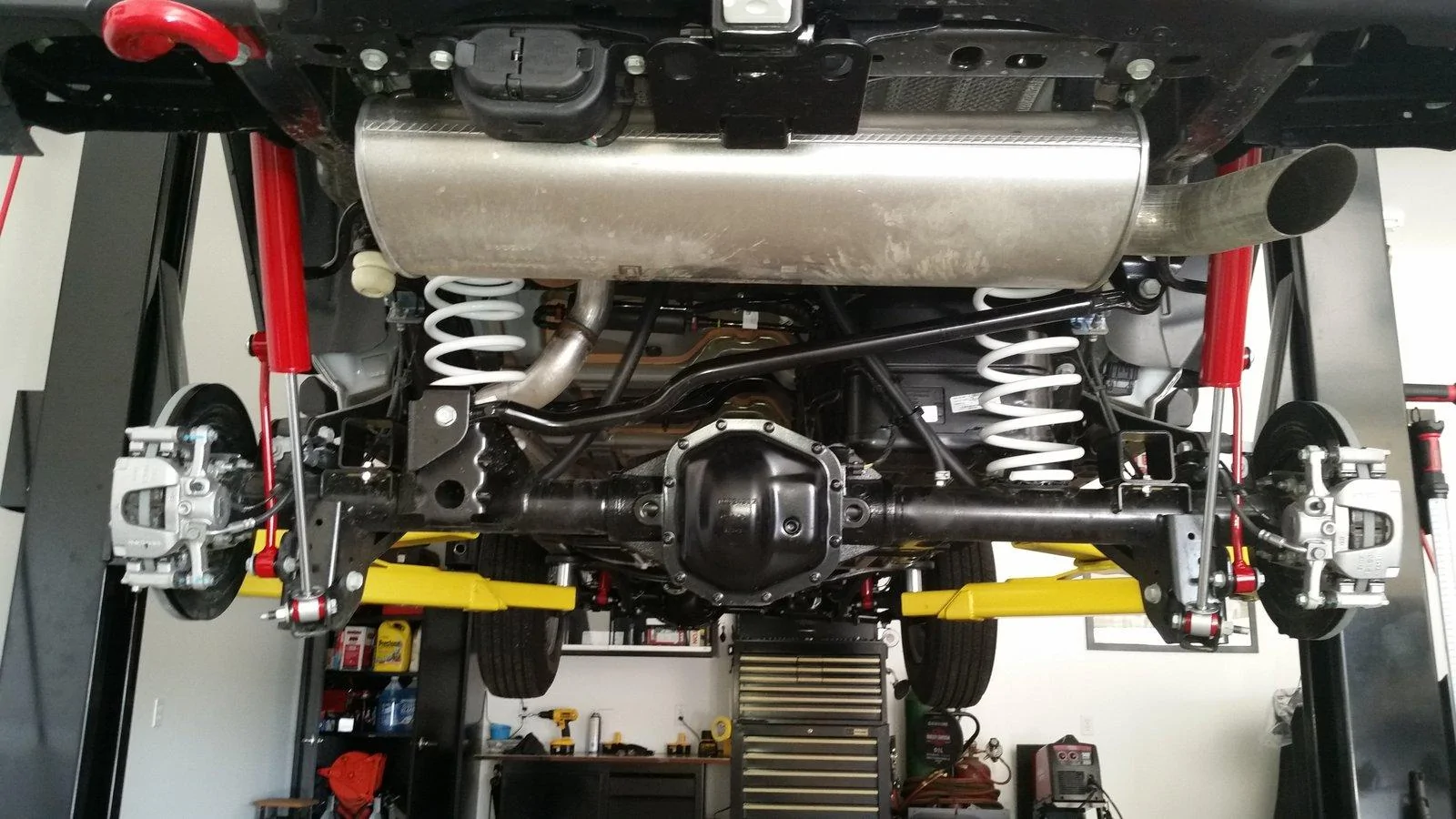

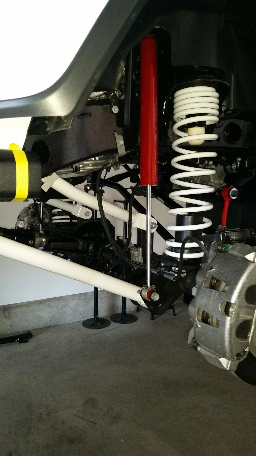

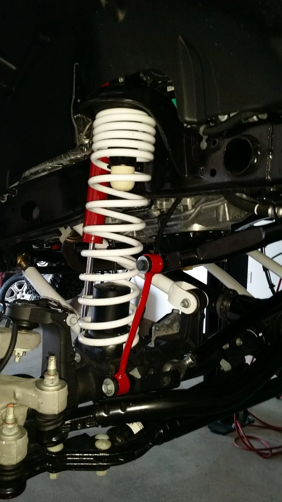

I am running a one off lift, 5" custom spun dual rate springs, full set of Core 4x4 tier 4 control arms, custom fabricated sway bar links, Chromemoly adj trackbars, fabed bump stops, Fox prototype shocks, Adams driveshafts, Cooper SST PRO 40X13.50X17 ON MACHETE BEADLOCKS, Warn 10S Platinum winch with plate, Factor 55 links front and rear. It runs, drives and wheels like a stock rig.

Looks great. Those 40s....mmmmm. :clap:

Have you got any pictures of it crossed up? I'd be curious to see just how those 40's like the fenders under full compression compared to a stock rig.

I dont have pics but in full articulation there is about 1" clearance between the tire and fender, the tires measure 39.5 on the Jeep. The jeep is going on the flex table in 2 weeks at the Smokey Mountain Jeep Invasion then I will have some good pics.
