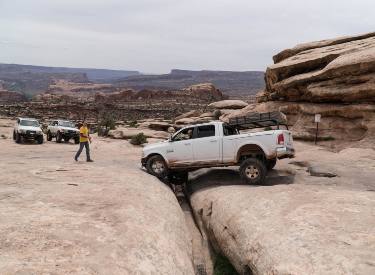

I've only had the Jeep since May. And the last time I was in Moab was May. We go down there about 3 times a year. But I wheel about as hard as Brit & Kevin but also do a lot of what Brad does in-between (keeping with YouTube comparisons) and have more experience than LiteBright in terms of years wheeling. But mad props on their success with Youtube. That's a lot of hard work. Zero hate.
Anyhow, I manage to steer 8350lbs with basically an identical front end to the Rubi that weights 4x as much without issues. The only advantage I have with the PW is bigger axles. I'll be in Moab in Sept or Oct, and we'll be at Trail Hero and I am thinking of hitting the Rubicon here in August. So if I break something, I'll post up about it.
Jeep Wrangler JL 37’s steering wear / issues 34456682_591553377880238_6537715045202132992_n.jpg?_nc_ht=instagram.fboi1-1.fna.fbcdn
If my buddies JK on 37's can manage without hydro just fine... what's your problem with steering exactly?
