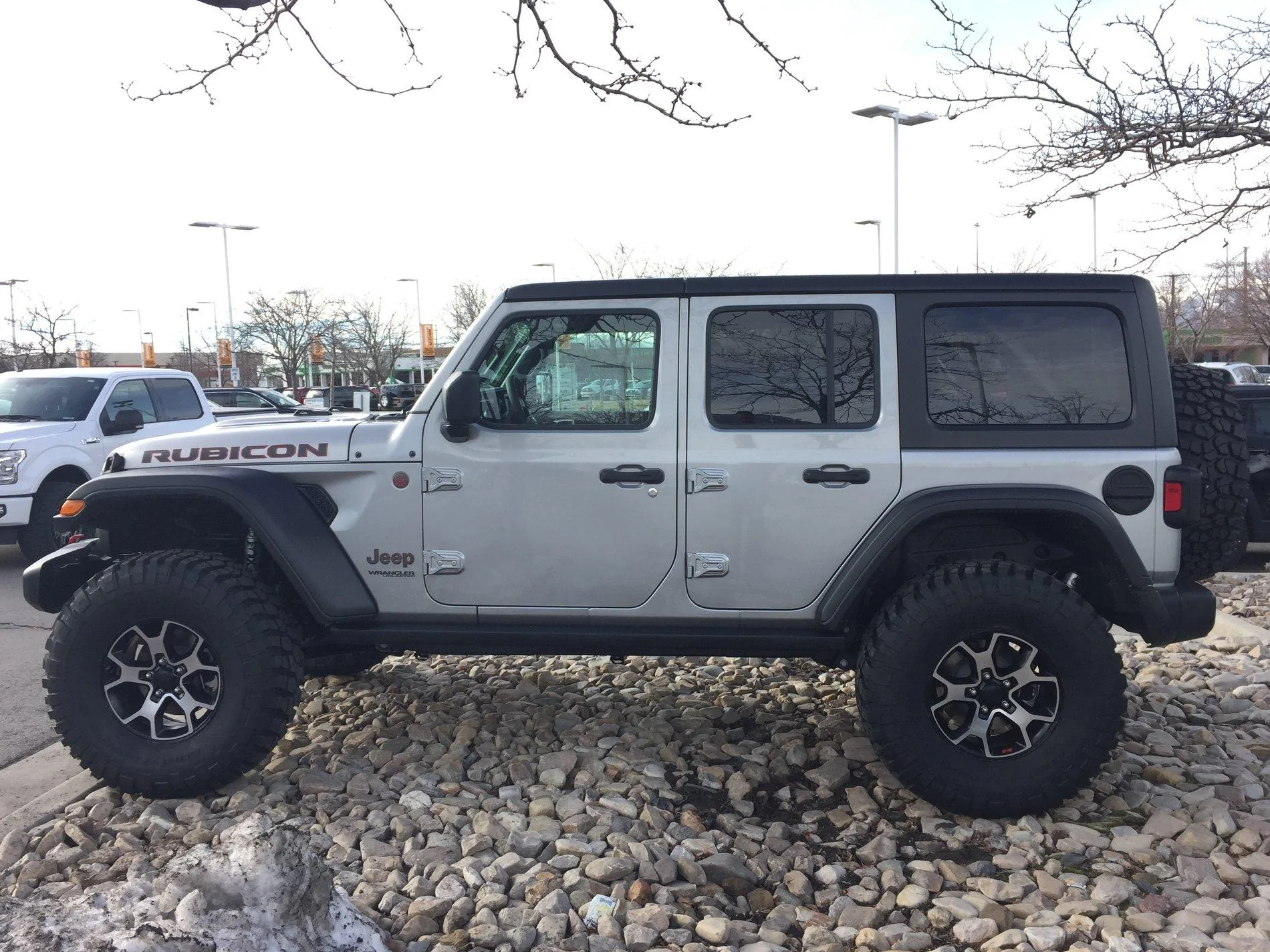

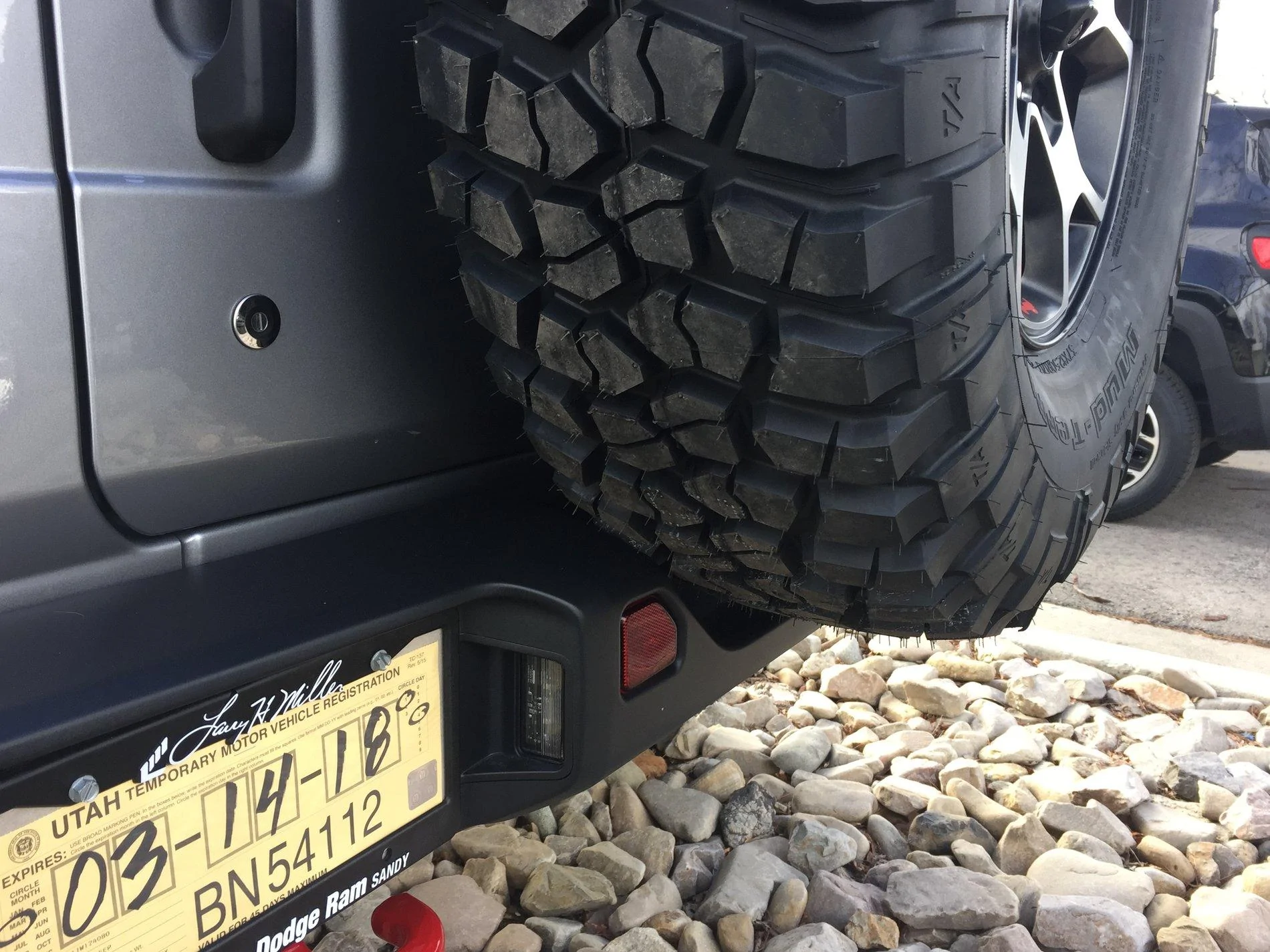

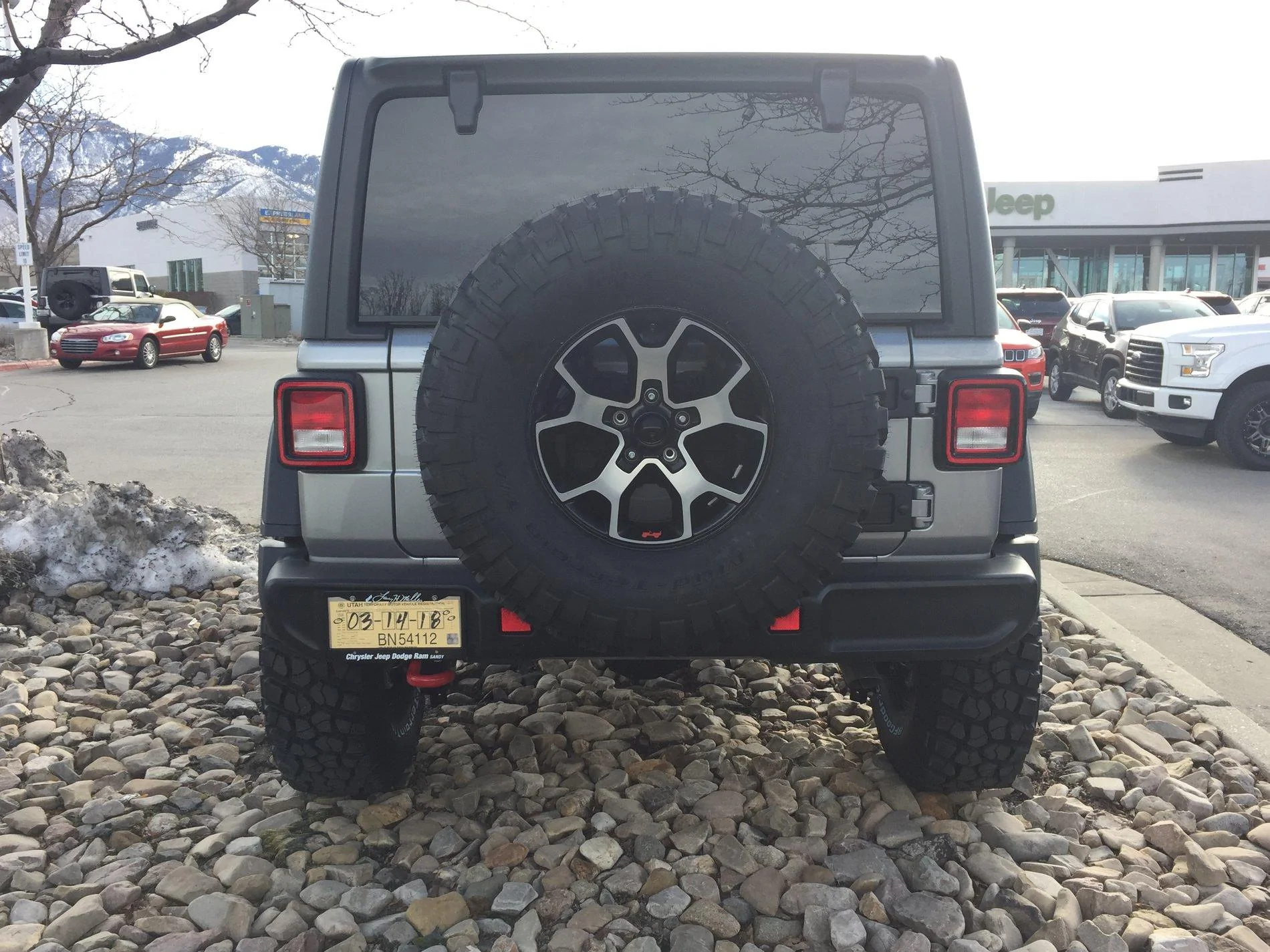

Does the Third Brake light no longer fit with 37's or did they not put it back on?

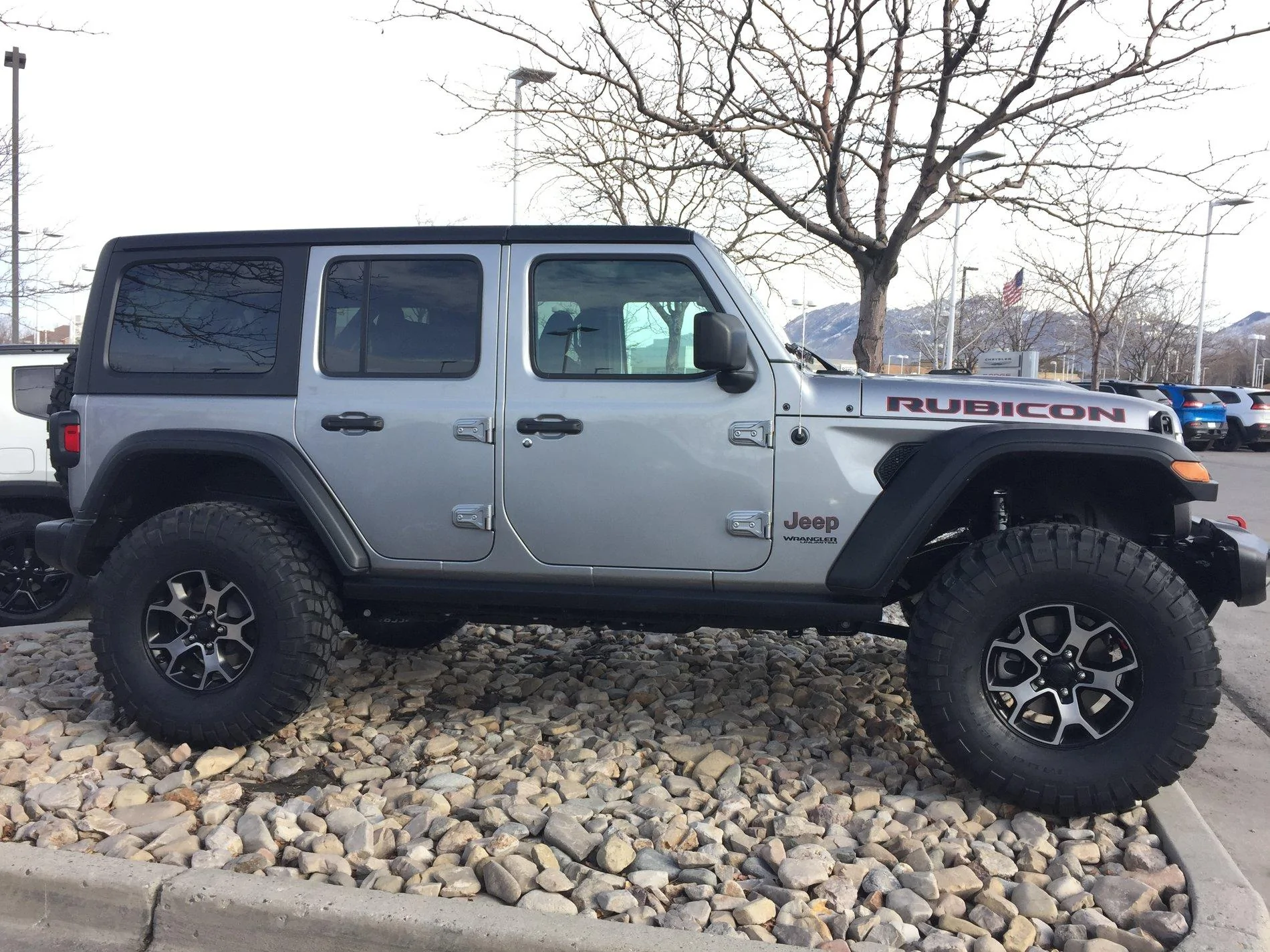

Zee, can you tell me how much height you got with the mopar lift on the Rubicon? Looks great with 37’s. Also, do you have to change anything else??

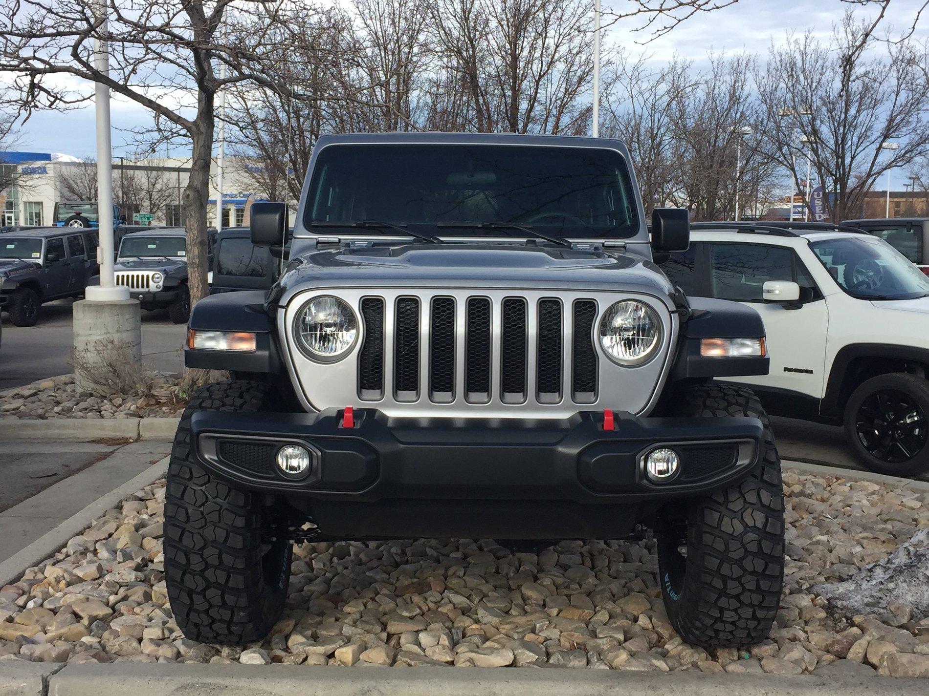

@ZeeCutt first of all your jeep looks fantastic! I have the exact color combination rubicon coming my way soon. I was wondering if you could tell us how far the tires stick out past the fenders?

You'll probably want/need to fit a HD/adjustable tire mount, like their Mopar hinge carrier kit (see green JLUR above).

Ok, i will try to answer all the questions:
First off, thank you for the compliments but unfortunately this is not my Jeep, mine wont be in for another 3-4 weeks, seriously feels like waiting for Christmas when i was 5. This Jeep belongs to a mechanic at the Jeep Store, he just finished it last night....
@Cwu21 - The MOPAR light extension kits isnt avaialable yet, however, he still had the stock one on there, it has a little adjustment and it almost works on the 37" tire, just a little short., should work on the 35"
@mbuck45 - i think it definitely added a full 2" on the Rubi over stock.. after seeing 2 of these kits now with 37's i am convinced that your 35's will have a plenty of room and you will get a full 2"'s... that said, i haven't measured them to verify.
@tmakaro - They stick out about 1.5"... i think he used the 1.5" TerraFlex wheel spacers. Looks pretty good, only concern is that the stock rim is so narrow and really pinches down those 37's... a 9" wheel or greater would really open up a wider tire much better.

Take this for what its worth, both the service manager and mechanic who just added this 2" lift and 37's and drove it around quite a bit, felt like the combo of the 4:10's and new 8 speed make 37's on a JL far more plug and play than the JK... the lift is mild and doesn't change the geometry a ton and the the drivetrain has no problem turning the tires and wheels, this coming from guys who used to gear down their JK's with 37's...
