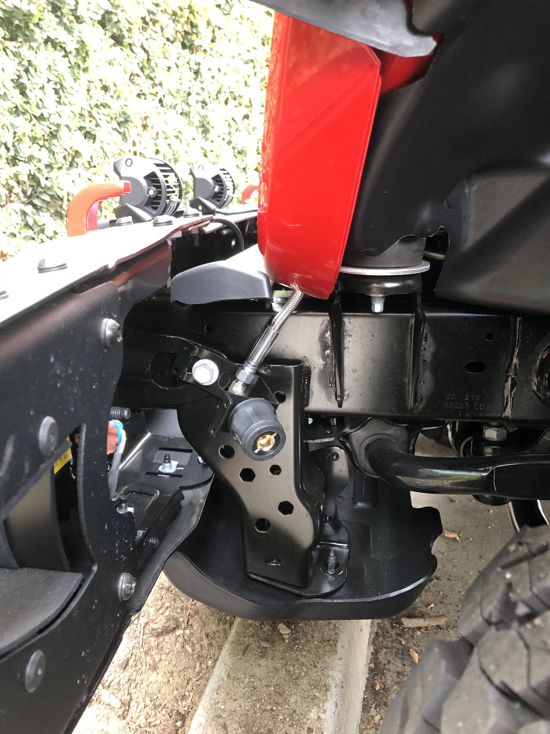

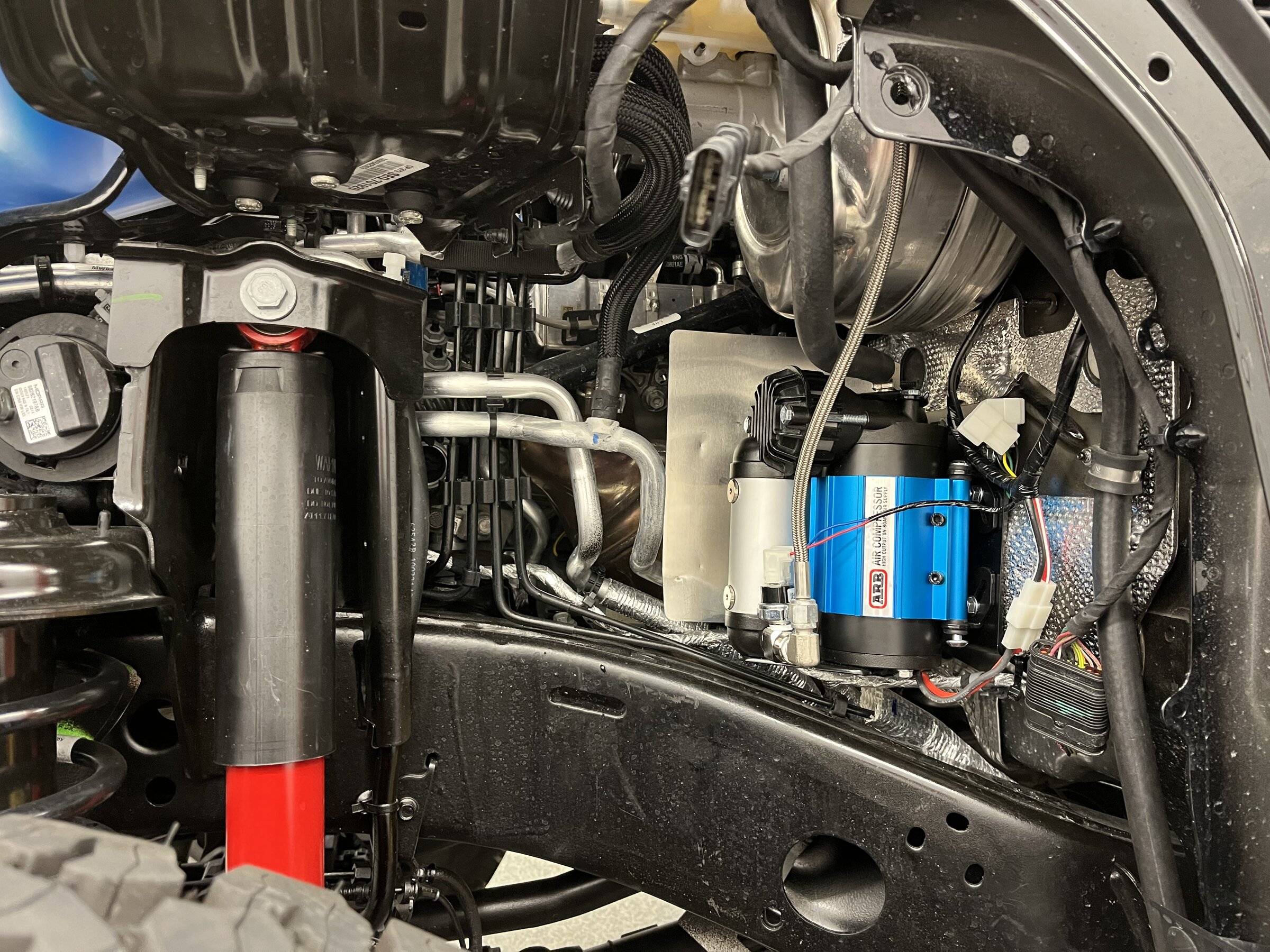

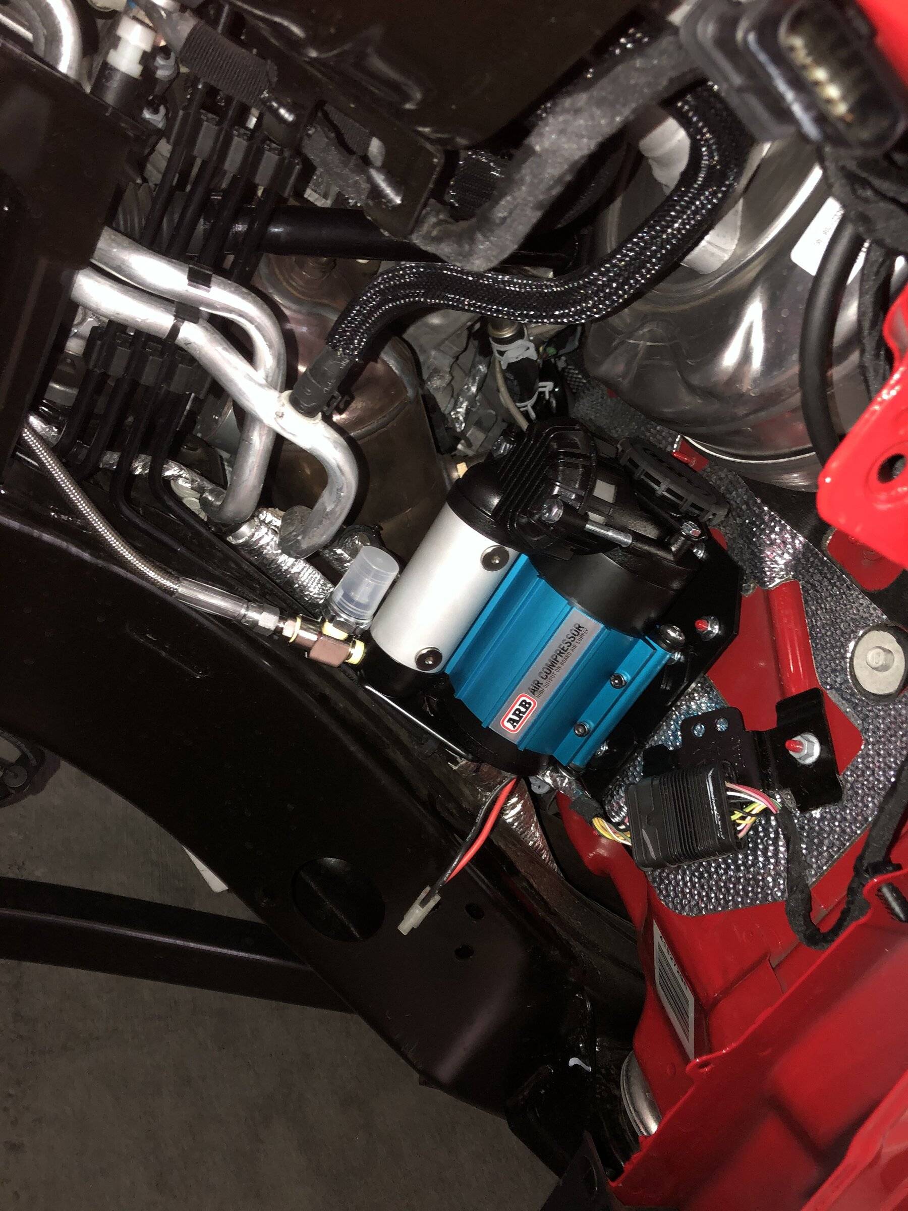

I had a twin ARB compressor from my 2.0T Wrangler and it was mounted below the brake booster. I was hoping the twin compressor would fit in the same spot on the 3.6L eTorque, but after taking the drivers fender off the 3.6L eTorque has some tubing in the way, so I looked for other options and came across [Banned Site] on YouTube and he mounted an ARB High Output in the same location. [Banned Site] sells the mount and I bought the HO on Amazon. I installed everything today and it fit perfect.
