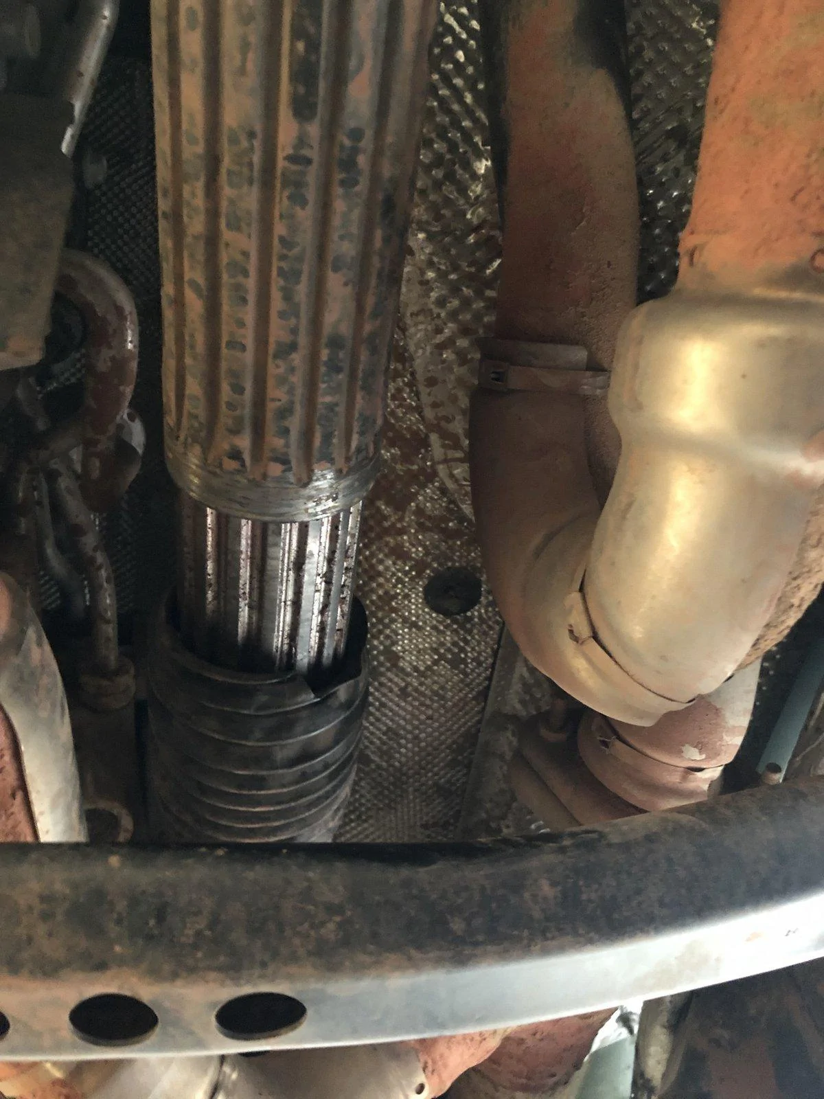

    I have the MetalCloak JL Wrangler Game-Changer Suspension, 3.5", RockSport Edition lift on my JLU… I just got back from an amazing trip to Moab, where my MetalCloak performed awesome! However, there was some carnage and lessons learned... so sharing here so that others can learn.
    1. At full droop the front drive shaft comes in contact with the factory OEM skid (it’s really just a bar that goes across). On my trip to Moab, my front drive shaft was damaged…I am going to replace with an ADAMS.
    2. On the front axle there is a cable for the electronic lockers on Rubicon's as well as a Center Axle Disconnect (CAD) cable, which are not long enough at full droop. On the rear there is a single cable for the electronic lockers that connects to the diff on Rubicon's. While on obstacles I got full droop and ended up ripping them both out of my front axle. The clips that tie the cables to the frame need to be cut to give additional slack... that should be sufficient or you may need to splice and lengthen. This really applies to anyone going with 3.5+ lifts.

    Route you ebrake cables under the frame cross member and remove the clips that hold the locker cables and FAD cable to the frame.

    Metal Cloak has this on their website and they recommend cutting all the cable ties, as well.

    Yes, they recently added this... after feedback like mine which I sent them prior to posting here :)
