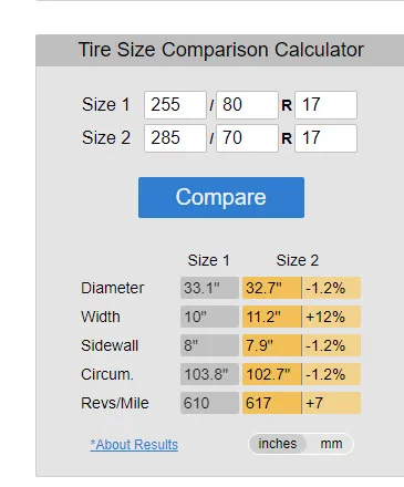

anyone tried or considered the 255/80R17 in lieu of the 285/70R17? Would be a taller, narrower alternative but not sure how it might look on factory wheel with the factory sport fenders.

I can't imagine the .2" on each side of the wheel causing an issue. Odd size though.

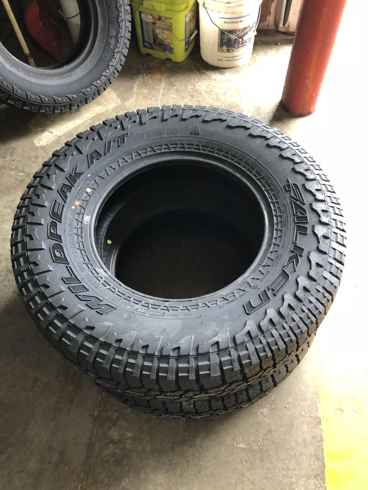

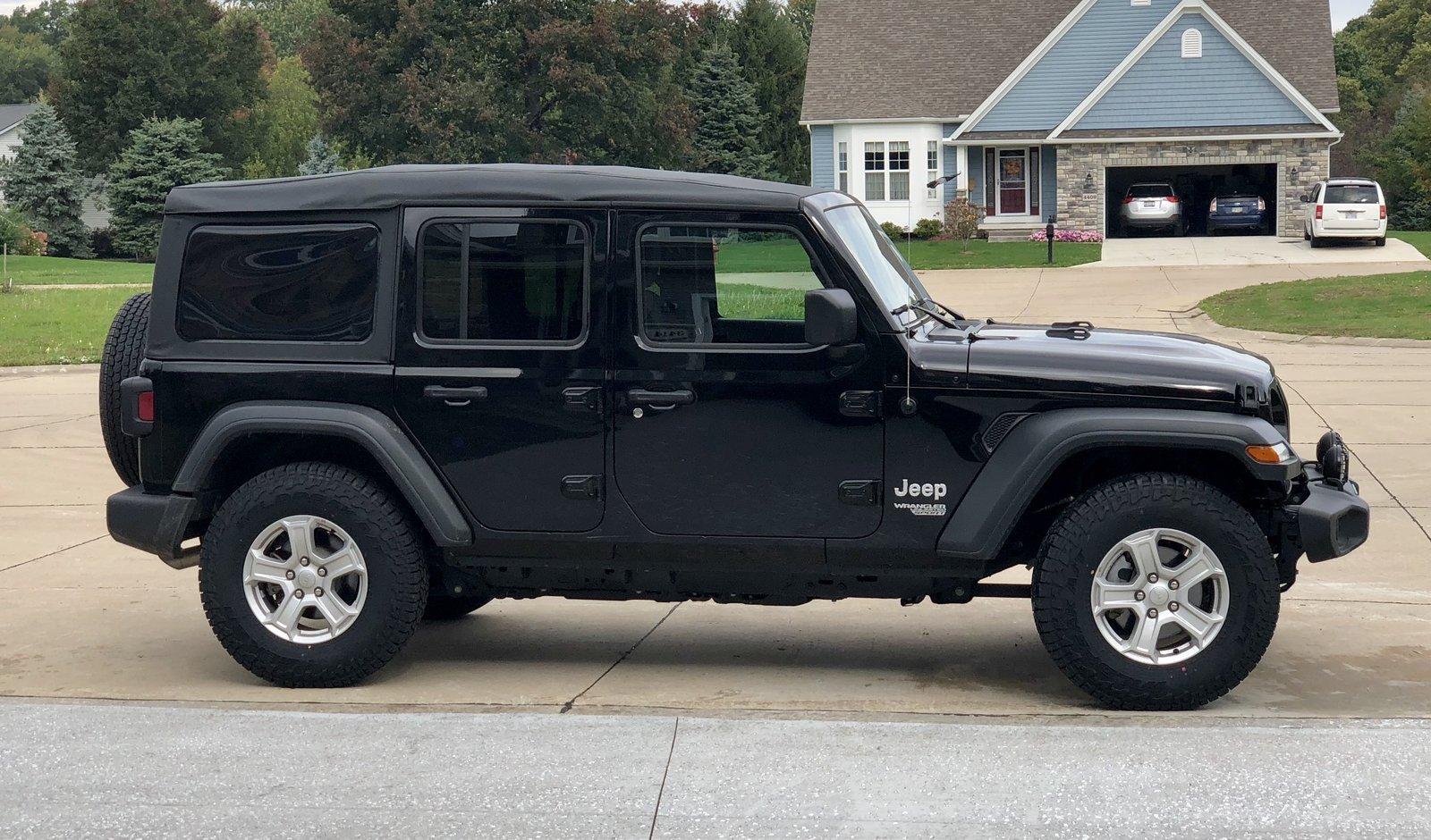

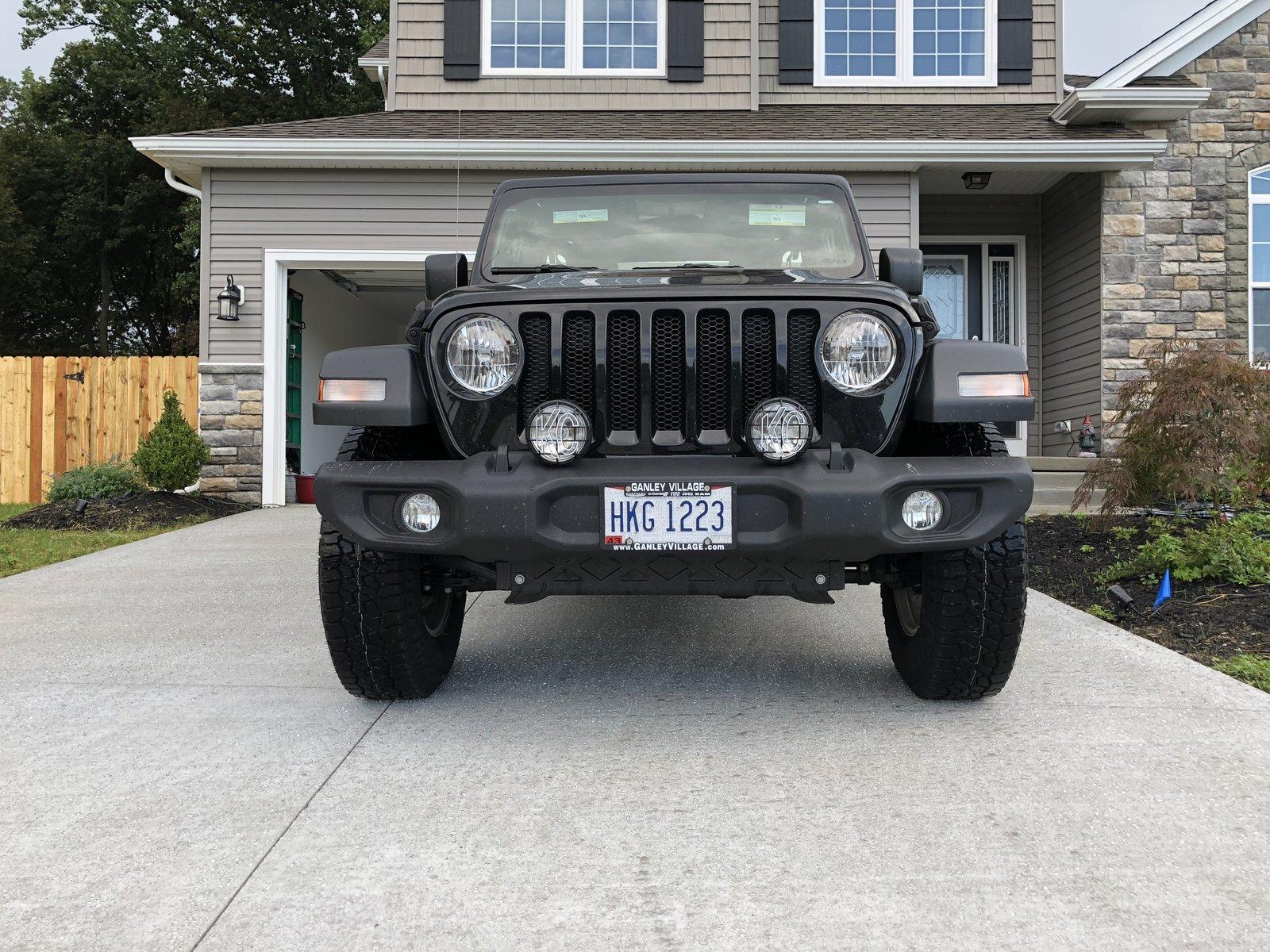

I will be putting Falken 255/80R17s on my JLU tomorrow 10 am. I will post some before and after pics.

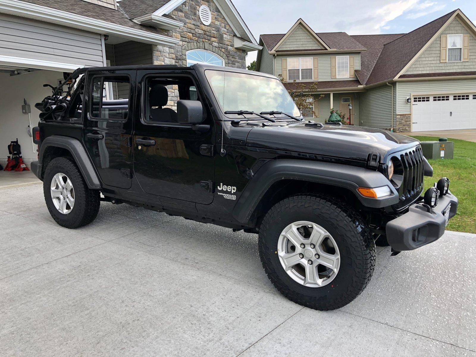

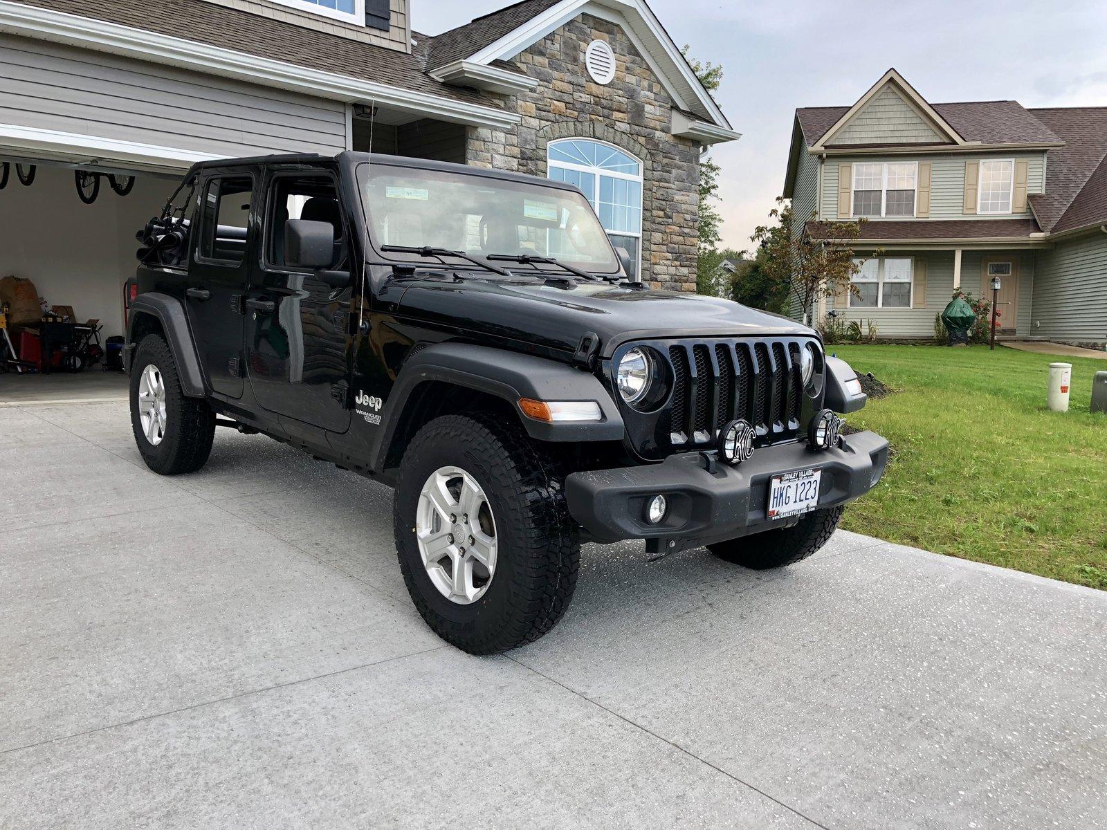

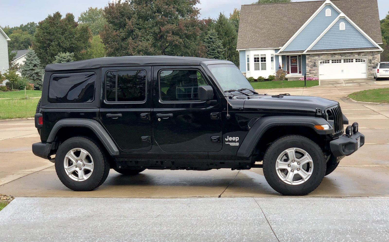

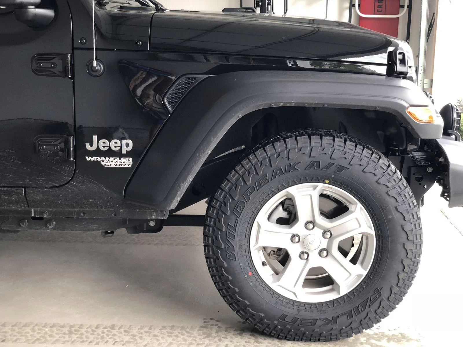

Got them on this morning. Barely notice any power loss and smoother than the 235 Kevlars. Drove about 57 miles on them and averaged 20 mpg mixed. So no noticeable fuel drop. Speedo is off 2 mph and my Superchip Flashcal module gets here tomorrow. I already have the programmer from my JK. They measure 32.5” and inflated to 34 psi

Sir it looks amazing
How much or which lift did you couple it with?
I think I'm going to do the same with my Sport S

That looks like it would be zero lift on the black unlimited

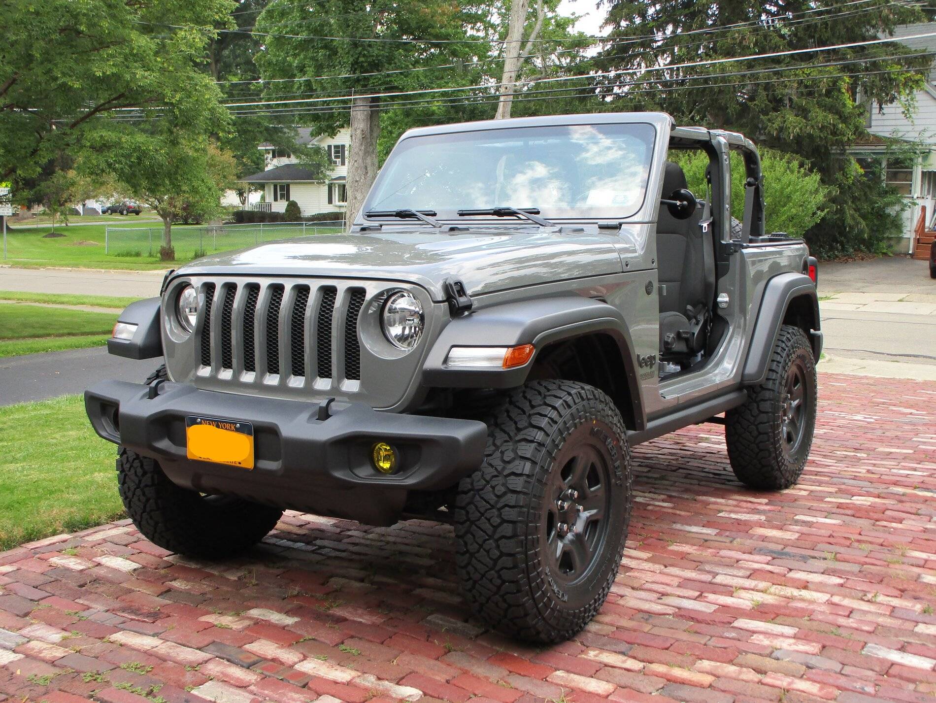

@Irnbru, those tires look great on the stock steel wheels!

Thanks. Checkout my new Kenda 35x10.5r17 2 inch Teraflex lift kit, 2020 Sport on stock steel wheels. No rubbing, measuring 34 inches at 38 PSI.
